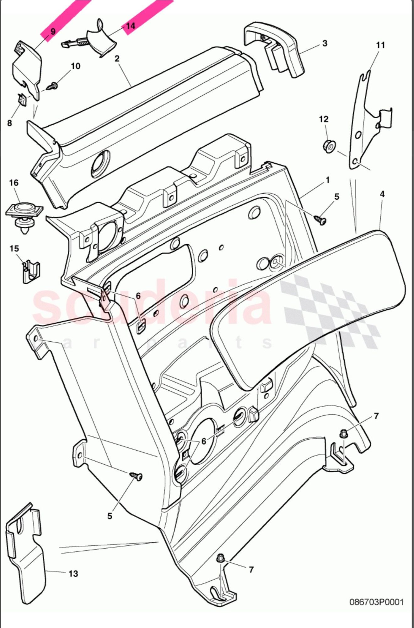

Hi Alec,
Sorry I was in the middle of making the post and had to take a call, so I posted later, glad you found the items were for the glovebox guides.

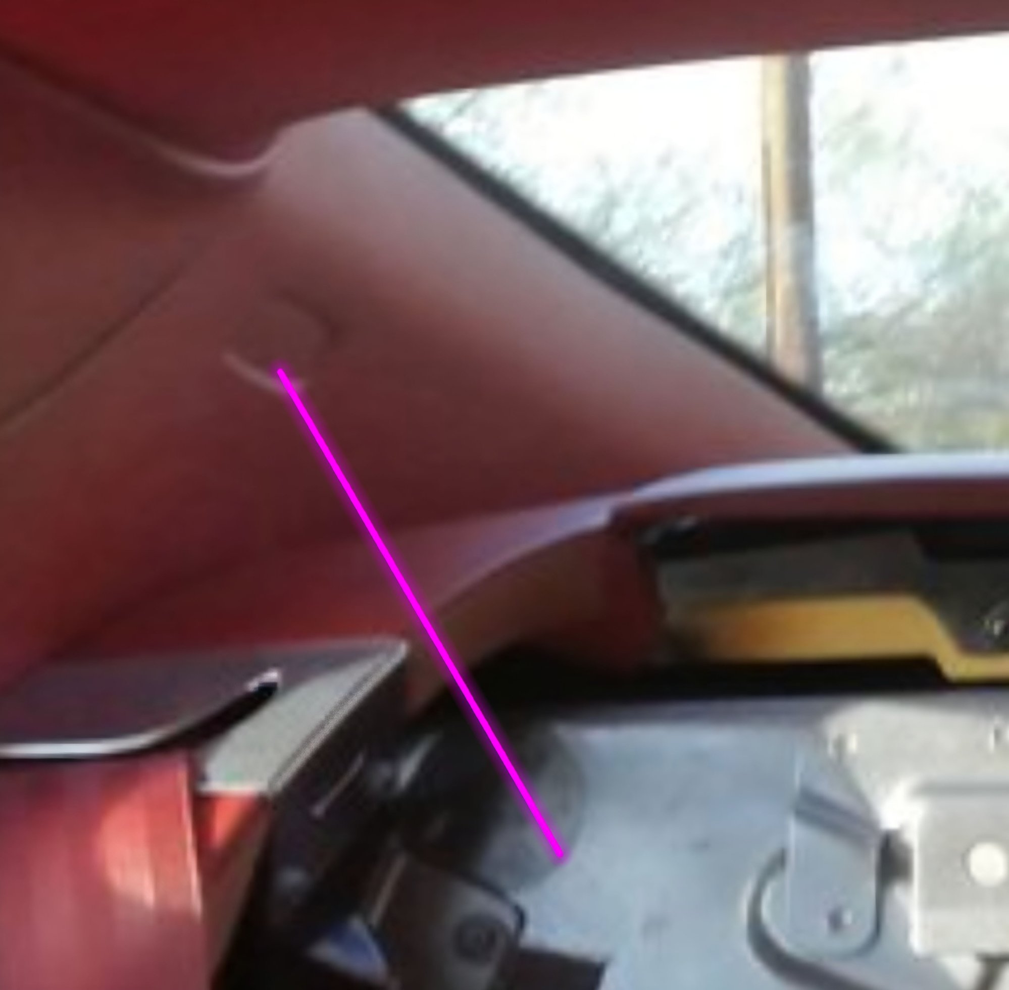

As to the rear panels, can you take a picture from outside of the vehicle through the rear glass showing the complete rear panel area, like the tan interior picture I marked up previously ?
I am wondering that being you do not have the same panels as my GT, and I see a fastener nut in the parts diagram, I wonder if your style panels are fastened from the bottom side inside the boot, therefore dropping the module shelf in the boot for access...
Johnny

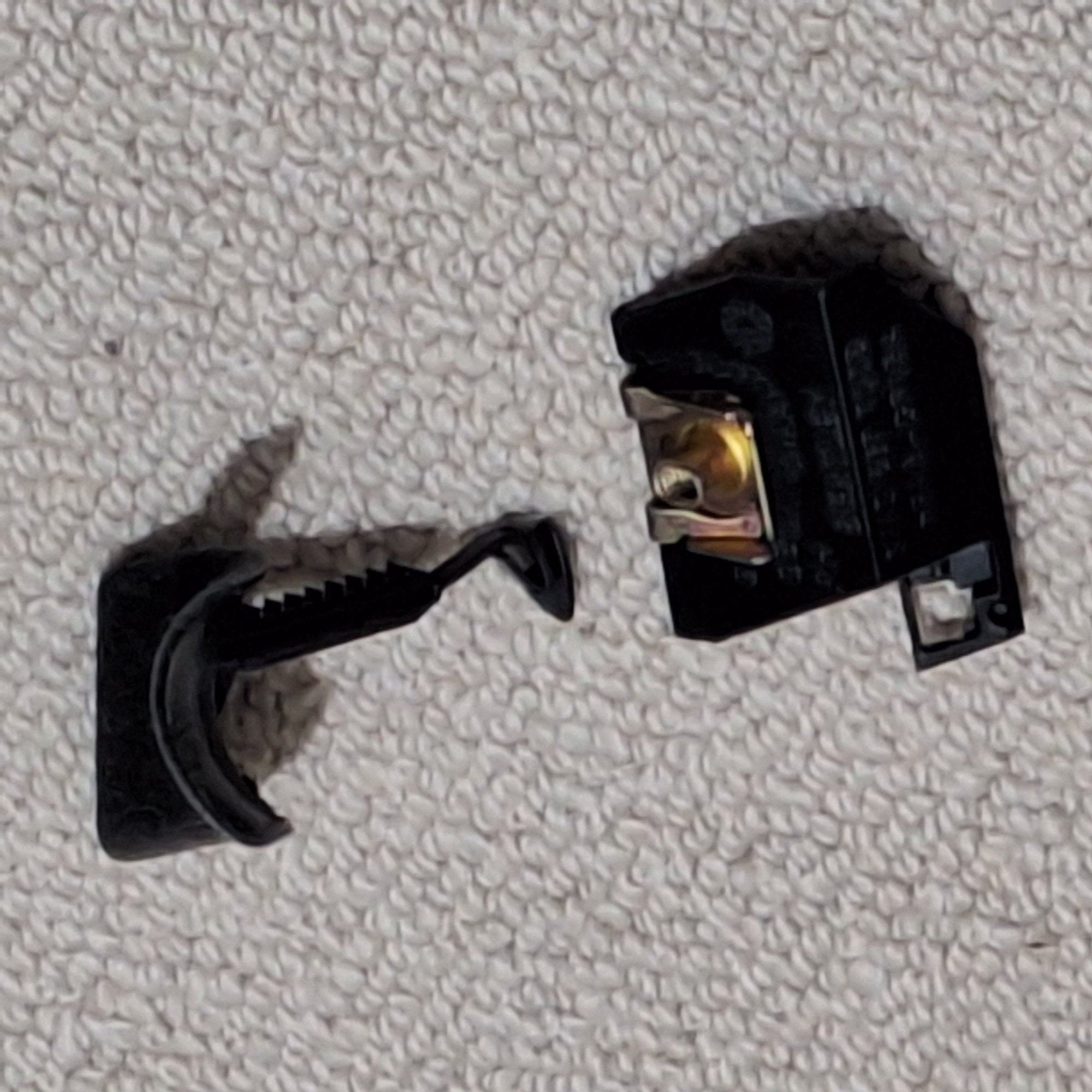

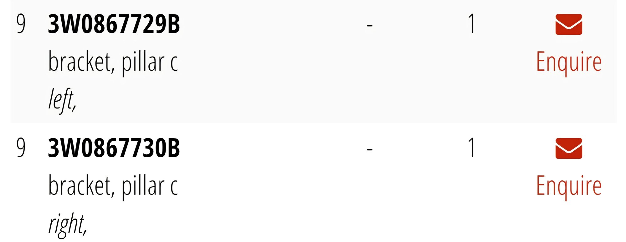

Another little mystery, I found the attached 2 x Trim parts on the floor behind the rear side panel. They are part numbers 3W0867730B & sW0867827. Can you advise where they go/how they fit?

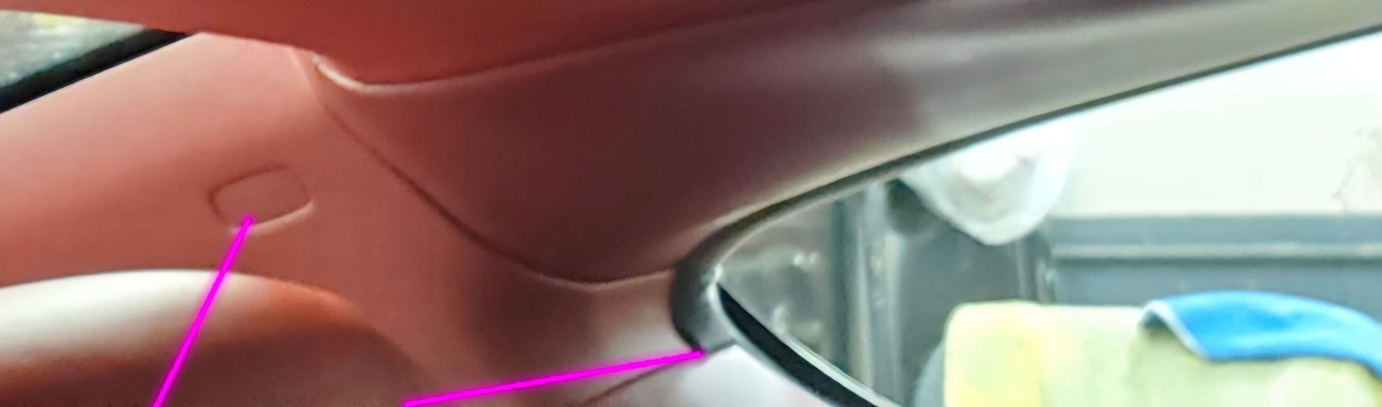

Hello @Precizion ,
Those two pieces go together to hold side rear seat panel in place, luckily you didn't damage the side panel leather by not removing it first, this goes for both sides.

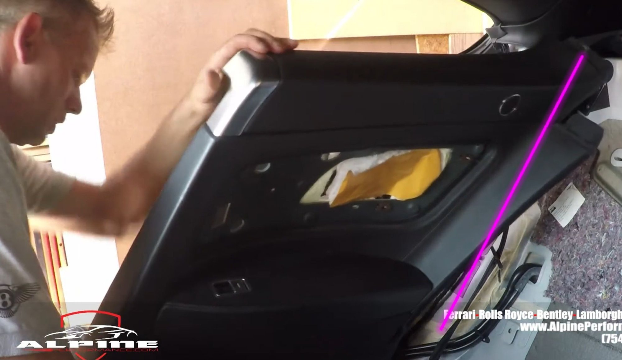

If you watched the video by Luka of Alpine, then you can kinda see it on his face when he realizes he didn't remove the felt covered trim cap to expose the mounting screws as he yanks the panel off, it's even mentioned in the comments on the video.
How are you doing with the rear parcel shelf panel removals, as I may have forgotten something, and I am wondering if the side panels with the "AIRBAG" caps need to have the nut removed to allow for the side airbag cover panel to come out with the parcel shelf panel.
Johnny

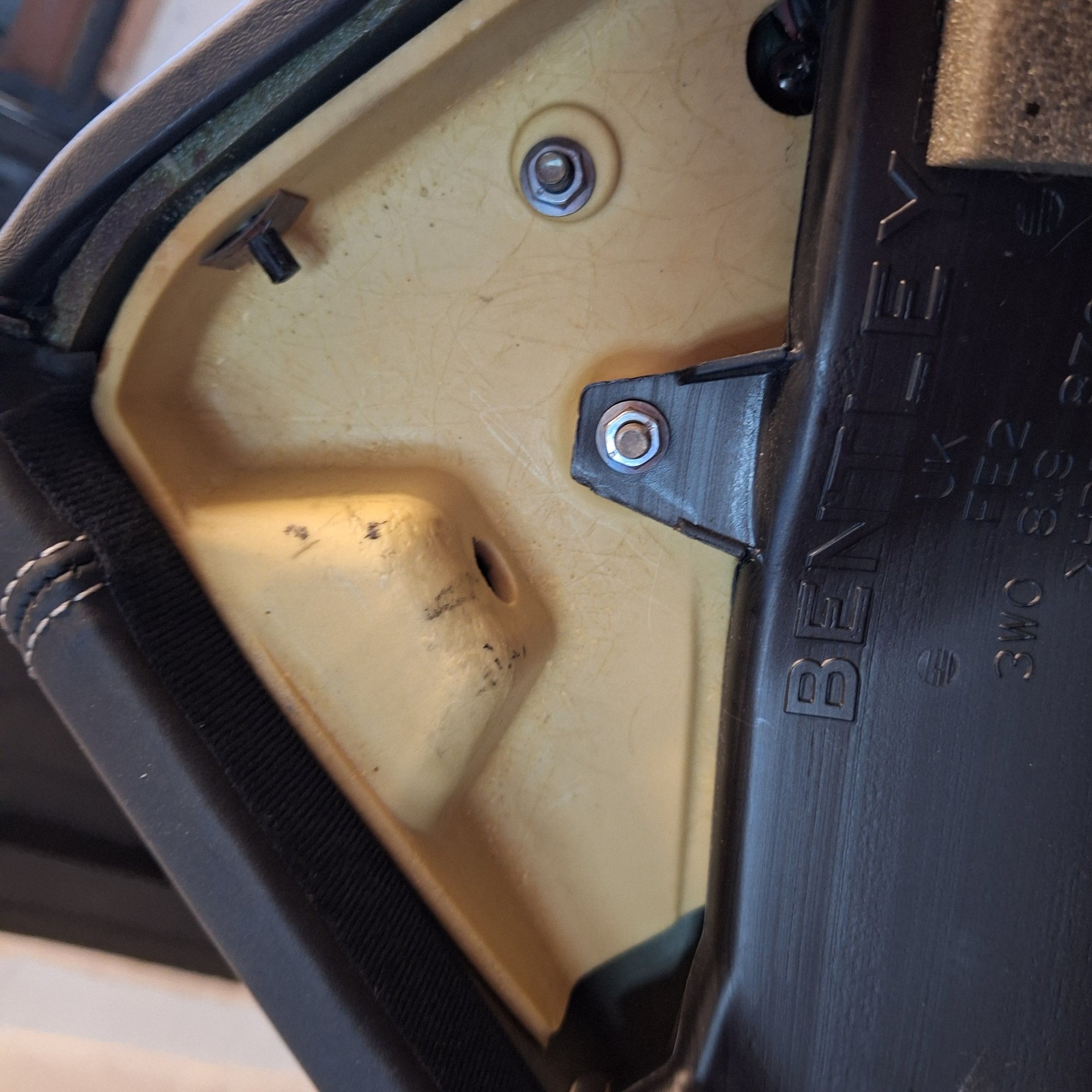

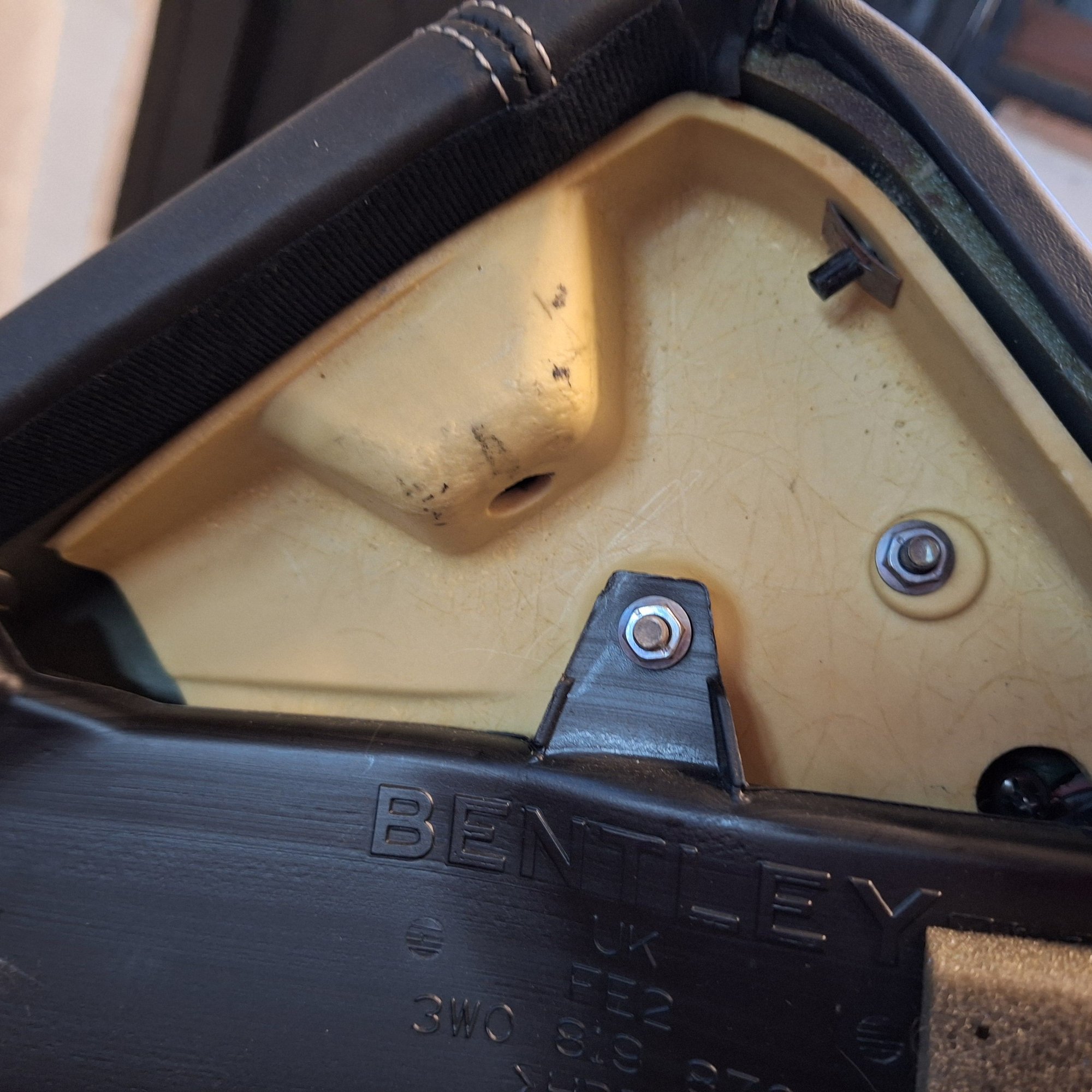

Hi Johnny, that's great! Is the plastic fixer 'floating' or is it fixed/glued? The one the other side is missing but F.S. wzn £35 for one!
I'll try prising that Air Bag cap off & sed if moving that panel helps.

Johnny, popped oit the Aur Bag cover, undud the 8mm mut & Bingo!!
GREAT !!
Sorry about that, I swore I took mine off in two pieces, maybe I put it back in two pieces, but removed as one...
Now that you have it removed, does or did the side (airbag) trim seperate from the parcel shelf section ?
No glue, iirc the plastic mounting bracket gets screwed to the body.
Post some pictures of the body in the area so I can see any screw holes.
I'll look through some of my pictures also.
Johnny

Hi Johnny, the Air Bag panel is clipped to the top panel. A bit of juggling to get it out & back but very satisfying to finally have black sest belts!

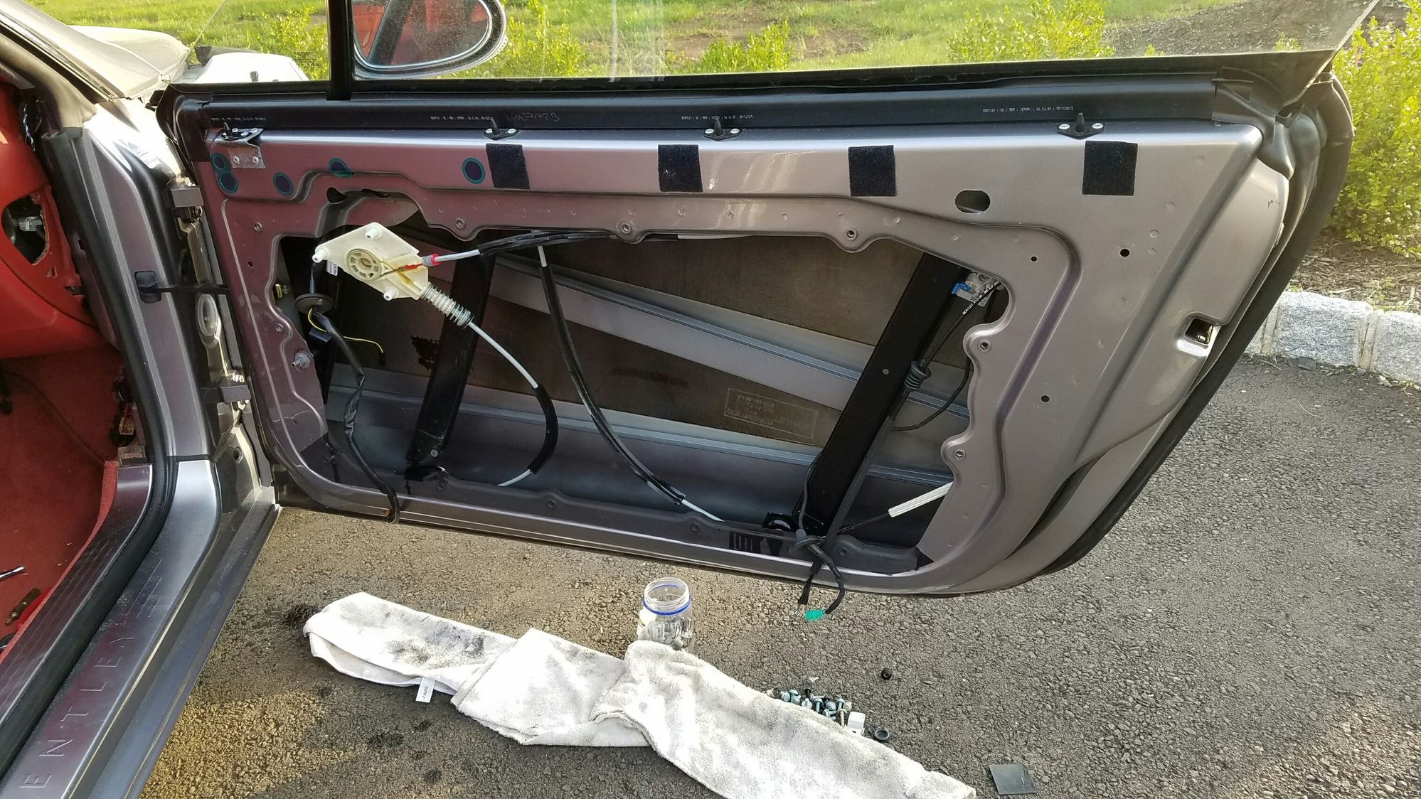

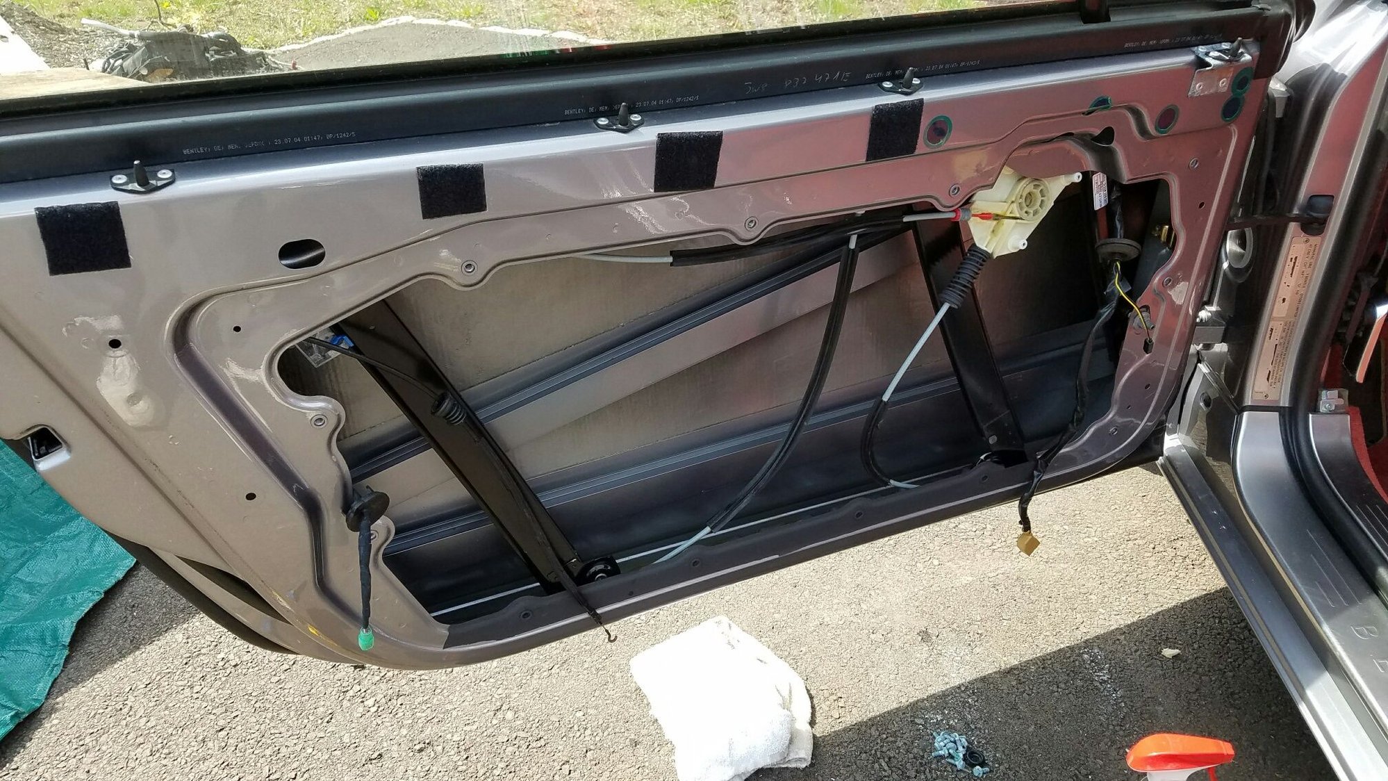

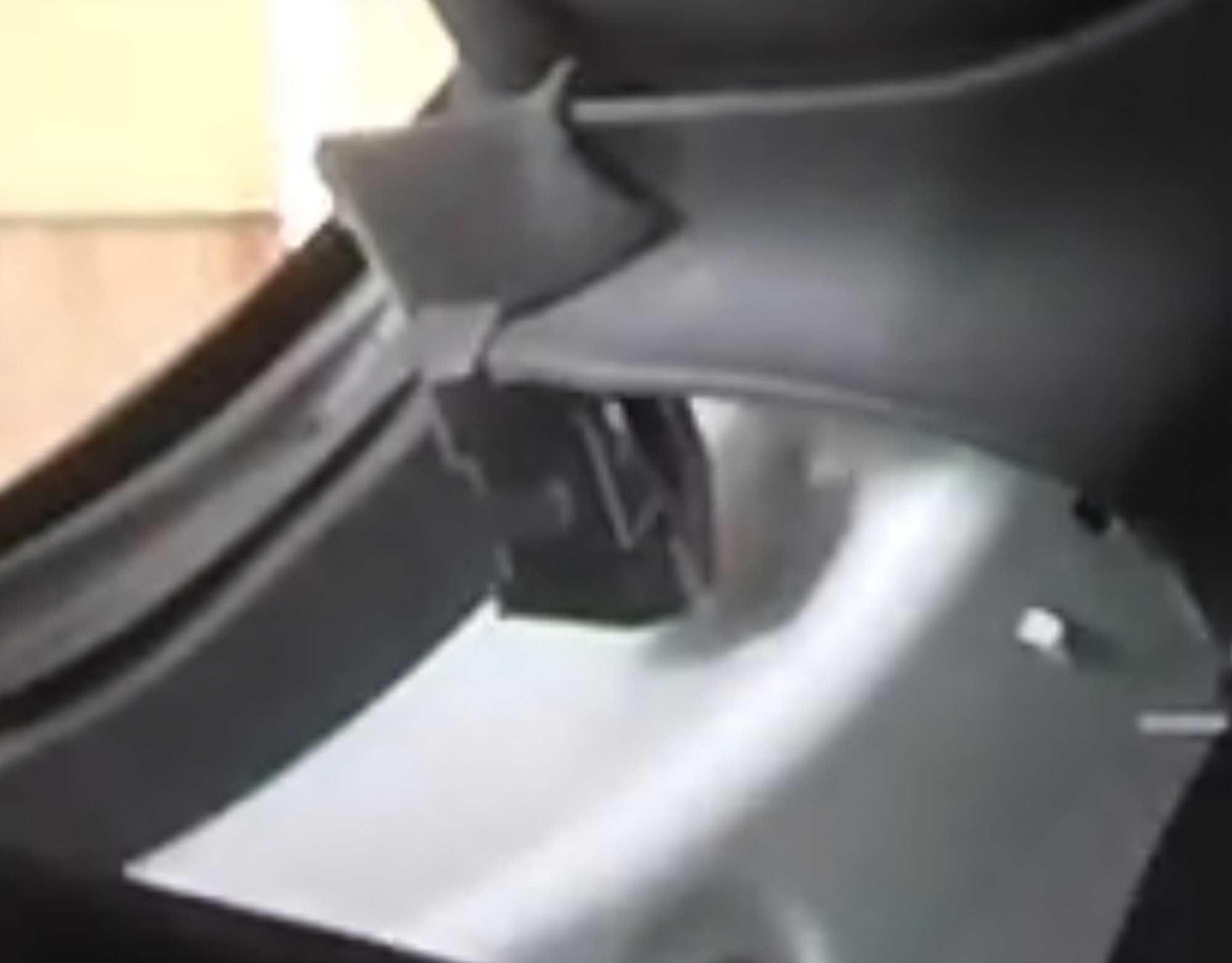

Door Trim Panel.
Some more wierdness! I needed to replace the sub woofer in the drivers door. The Trim Panel off much too easily! On inspection, 3 of the 4 large Trim Clips were missing along with many of the screws. Bear in mind the seats & door trims are crom a later Mulliner spec.Then I couldn't get it back on & the culprit serms to be the front top 'peg', The bracket it sits on pushes it out of line witb the other pegs & being riveted on, looks like a bodge to me? What do you reckon?

Hello @Precizion ,
Happy New Year !
That front peg and the bracket it sits on is factory, although it does look to be that the plastic peg is or has been pushed inward towards the glass a bit, iirc, I put the front on first and worked to the rear.
Johnny

Hi Johnny, sorry, Happy New Year to you too!
I'm fairly amazed that it is standard. The panel certainly wasn't fixed to the front peg when I took it off! What I don't get is that the holes on the door panel are on lone & yet this pig isn't? I've tried several times & there is no way that peg is going in my panel! Could the prgs on a 2007 be differe
nt?
