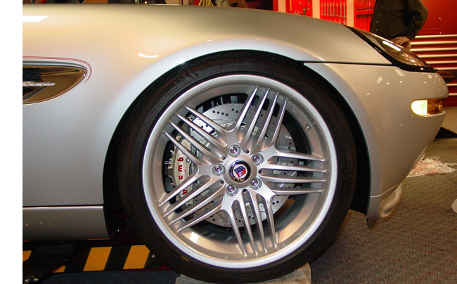

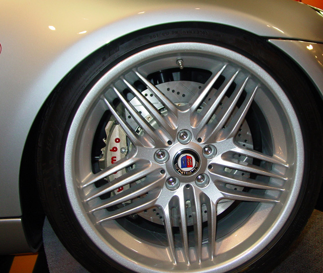

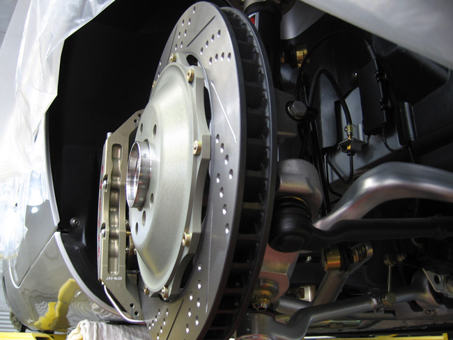

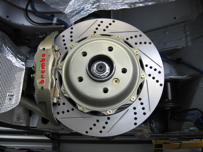

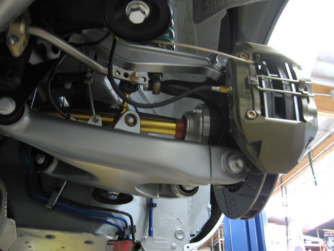

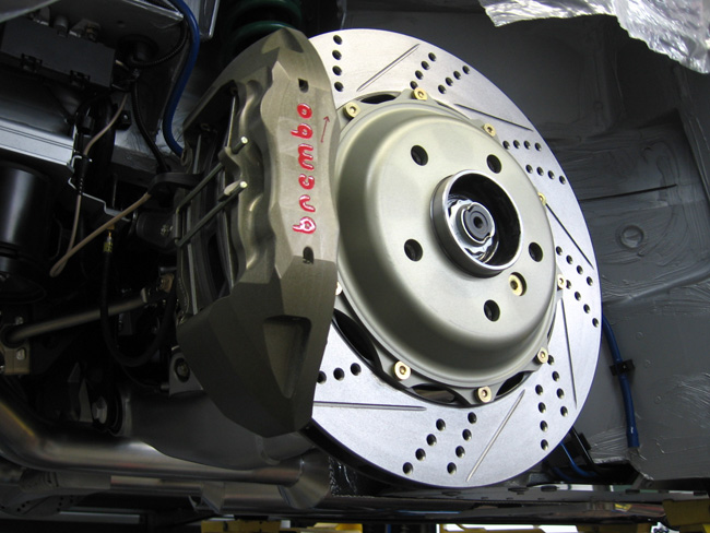

For a Z8 we did a bit of a hybrid kit. For calipers, we used the Brembo GTR but with dry breaks instead of bleed screws (if you look carefully, you can see one in the pictures) as, though requiring far more maintenance, the dry breaks are better at preventing weeping (as F1 discovered several years ago, which is why, when cost is not an issue, the change is made). For hats (bells), we made our own from a high temperature aluminum used in F1 and not found in any of the standard kits. For rotors (disks), we used ones that are lighter weight than those in the Brembo kits (we saved 2.5 lbs. per front and 2 lbs per rear) and had them drilled in addition to being slotted (Brembo can do this too). For brackets, we made our own to reduce weight (one should not try this unless one has the engineering resources to determine what metal can be eliminated while maintaining strength). Finally, for lines we made our own with titanium fittings and covered them in DR25 to prevent having raw metal lines which, through movement and vibration, could act as saws on parts around them. Also, as to the brake line fittings, certain BMWs (and other vehicles) have particularly shaped fittings going into brackets on the chassis side (also seen on the pictures) and no kit that I have seen has these fittings -- and without the these fittings one might have less than optimum line mounting. Finally, as to AP, which, of course, is owned by Brembo, they, too, have excellent kits and excellent street and race calipers (Brembo and AP split, almost equally, the F1 grid and, in sports car racing, they have a substantial part of the field).

Two more pictures to show the kit on the car.

Robert, thats a nice setup you guys made! Can you PM more information about it?
I've seen quite a few GTR setups but that one is just... WOW.
amazing setup Robert.
