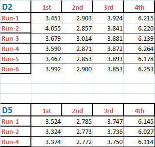

I believed this would be a very easy test to run...all I needed was a car owner with DCT and a vBox. The test to figure this out would be quite simple. Run the DCT in D2 and compare the vBox results against the same car running in D5. Even though the shift speed difference between D2 and D5 is only a few milliseconds, I was hopeful it would prove the results one way or the other. Now all I needed was to find the car and test it. I ended up waiting more than a year until I got my answer.
This weekend, I borrowed a guy's DCT car and took it to a remote road in the desert that was nearly perfectly flat in both direction. There are no side streets, except the ones I would use for the tests. I planned to place the car in D2 and turn on the vBox. I would run from 0-130 MPH -- as this would give me 1/4 and 60-130 MPH results. I would run the car in both directions on the same exact piece of road for three runs in each direction (six runs total), then I would switch to D5 and run the same test all over again.
The car I borrowed was nearly bone stock. Bone stock is ideal because if the results are obvious with a bone stock car, they will be even more obvious and exaggerated on a highly modified car (such as a supercharged car). So taking a near bone stock car for the test was also going to make it the most difficult for me, and give the naysayers all of the benefits.
I found the perfect road, hooked up my Video vBox and tried one practice run in each direction to make sure the road was safe. After I was satisfied, I turned on the vBox and ran in one direction. Then I ran in the opposite direction. Back and forth three times for a total of six runs. I switched to D5 and repeated the runs. I was running low on gas, so after two runs in each direction (instead of three), I abandoned the third set of runs and went home.
The results were overwhelmingly conclusive. Even though I was only changing the shift speed by a few milliseconds, the effect on 1/4 mile trap speed was obvious and I'd say even profound. Wasting a few milliseconds shifting affected my 1/4 mile trap speed by as much as 2MPH. Even the best D2 run couldn't beat the worst D5 run. Sticky was wrong...again. That's right: the self-proclaimed expert of drag racing and all automotive knowledge was proven dead wrong again.

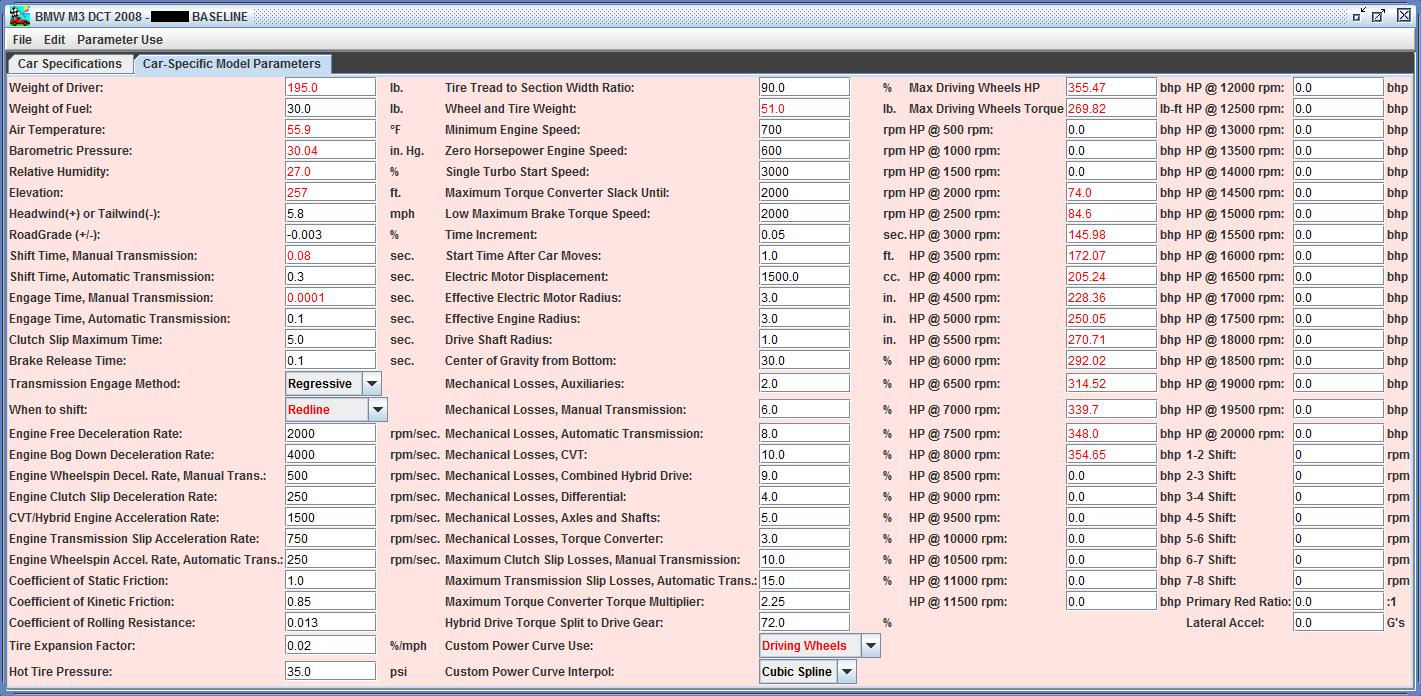

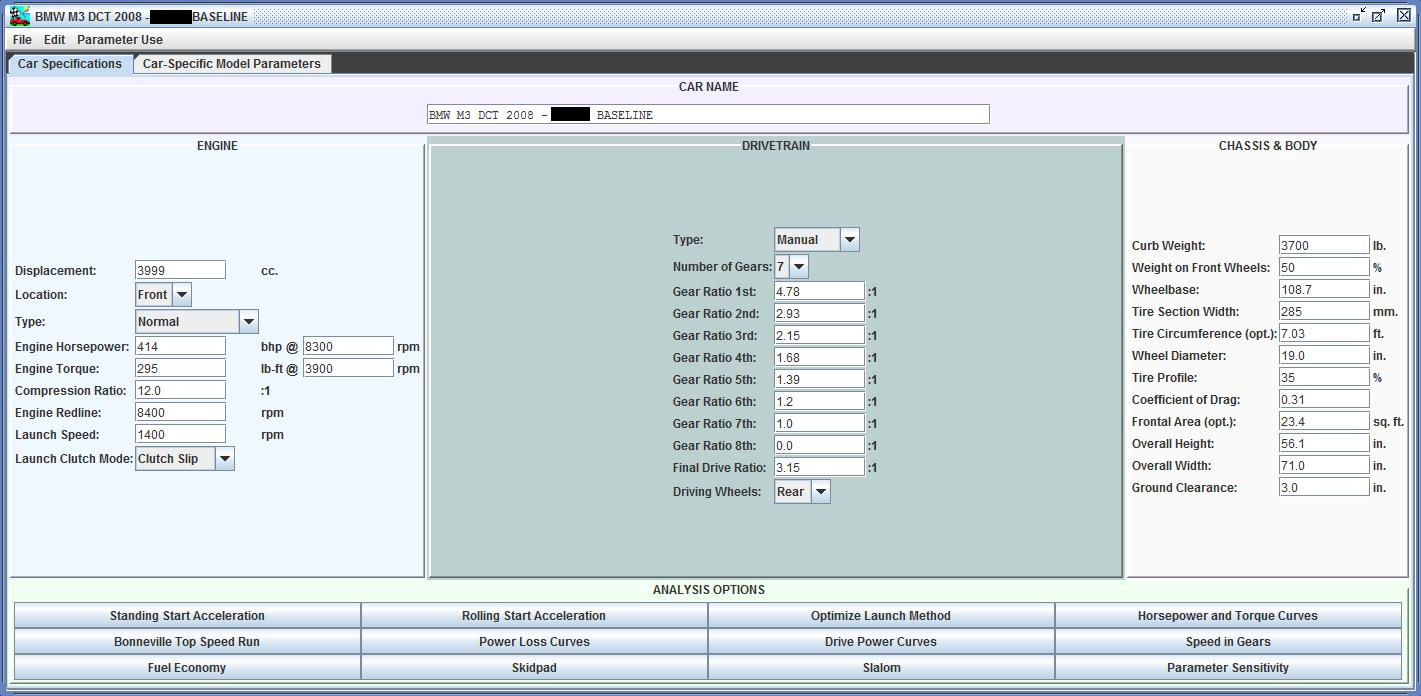

As a final test, I input all of the actual car data in CarTest to see if it could predict the same results. If it did, it would be (yet) another slap in the face to the self-proclaimed expert who regularly mocks the use of this tool. I just happen to have the Dynojet dyno file from this exact car taken only a few weeks ago. CarTest allows the user to input the actual dyno results. After doing so, I adjusted the launch methods to match how I used the DCT. For D2, I selected a 0.20 second shift time (200 milliseconds). I chose this shift time after some research on three or four different car forums and other web sites who claimed that 0.20 seconds was about the slowest the DCT would shift (D2 mode). For D5, I selected 0.08 seconds shift time (80 milliseconds). In input the exact weather conditions I collected during my run, including elevation and wind speed and wind direction. Then changing nothing but shift speed, I let CarTest estimate the 1/4 mile ET and trap speed, along with a 60-130 MPH time as well.

Conclusions:
To me, the results seem pretty conclusive. Even changing the shift speed by 120 milliseconds (or whatever the actual value may be between D2 and D5) created a pretty significant change in all 1/4 mile drag results, and 60-130 times as well. As I believed at the very beginning, shift speed does affect trap speed, no matter what the self-proclaimed drag race expert seems to think.
CarTest results proved to be very accurate as well. The D2 predictions vs. actual results were about as close as they could get. 1/4 mile ET was predicted to be 12.65, actual was 13.26 (4.7% difference). 1/4 Trap Speed was predicted to be 112.55, actual was 112.86 (3/10ths of 1% difference). 60-130 time was predicted to be 12.63, actual was 12.537 (less than 1/10th of 1% difference).
The D5 predictions vs. actual results . 1/4 mile ET was predicted to be 12.48, actual was 13.052 (4.4% difference). 1/4 Trap Speed was predicted to be 113.83, actual was 113.69 (1/10th of 1% difference). 60-130 time was predicted to be 12.20, actual was 12.13 (1/2 of 1% difference).
Trap speed and 60-130 MPH results were both less than 1/2 of 1% difference from the predictions for both D2 and D5. CarTest predicted 1.28 MPH trap speed difference, and the actual was 0.83 MPH difference. CarTest predicted an 0.15 second difference for 60-130 MPH runs, and the actual difference was 0.407 seconds. And even though 1/4 mile ET was 4.4% off, Cartest predicted a 0.17 second difference, and the actual results were 0.224 second difference.

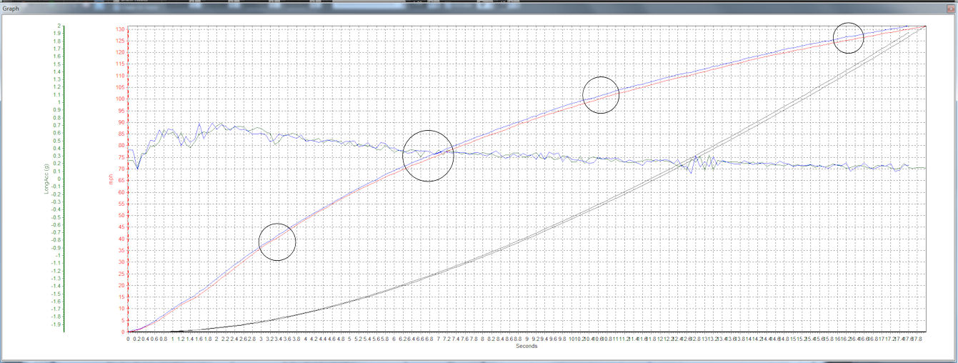

VBox Results (I've highlighted the shift points):
Car Test Configuration:

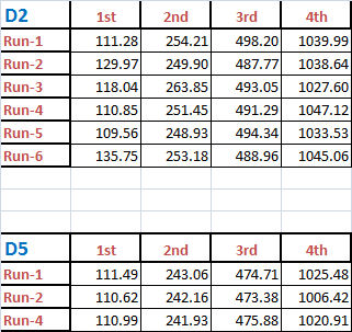

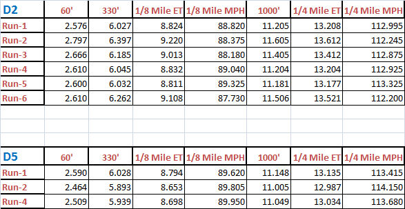

I did a little more digging into the results, and it's very clear that clutch engagement time is different between D2 and D5. I looked at the 60-foot times, and it's clear that the clutch engagement is faster in D5 than D2.
At the same time, I exported as much data from the runs as I thought made sense. I tried making some graphs of the data, but nothing was nearly as clear as simply presenting the data itself.
1/4 Mile results:
Even though these aren't actual drag strip results, I tried to simulate them as best as I could using the VBox tools software. I did my best to look up the NHRA rules and figure out how times, distances, and trap speeds are measured. Then using what I learned, I programmed the VBox software to simulate the same thing. For example, I used a 1-foot roll-out, and the trap speed is the average of the speed at 1321ft, and 1257ft (Q-60 ft, with 1-foot roll-out).

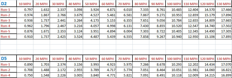

Gear Analysis: Time in Gears
Gear Analysis: Distance in Gears
Speed Analysis: Time to Speed
Speed Analysis: Distance to Speed
