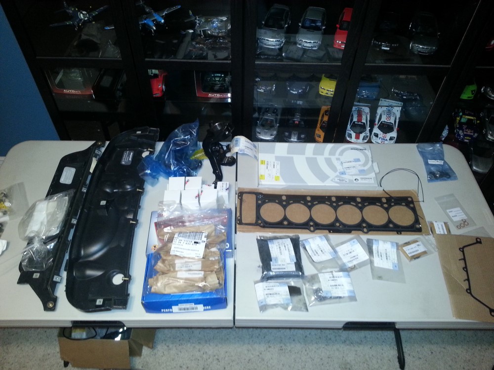

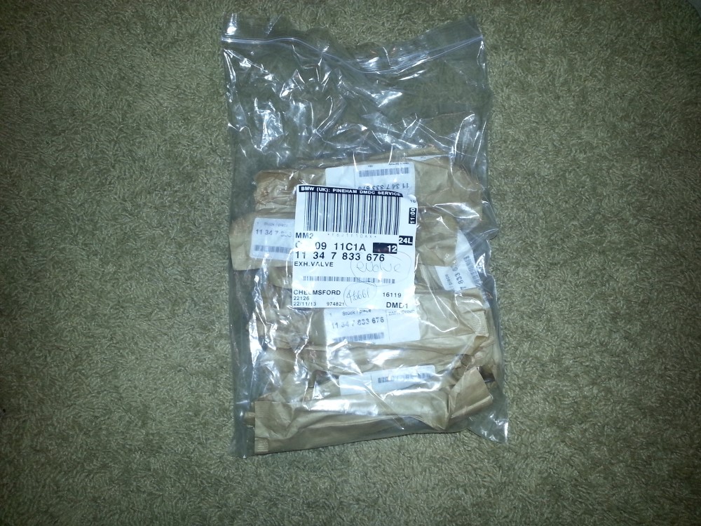

You know you are hoarder when your room looks like the images below.
The Evolve boxes were the last pieces I was waiting for to do the next major service. I have been stock piling the last few months as you can see. This will be the last major upgrade to this car as I have done all I have wanted to for the moment. Car should be going in for the last bit of upgrades in the next few weeks.
Vanos work
X1 -- BS021 -- S54 Vanos Seals Repair Kit
X1 -- BS022 -- S54 Vanos Rattle Repair Kit
X1 -- BS023 -- S54 Rebuilt Vanos Solenoid Coil Pack
X1 -- BS024 -- S54 Vanos Sealing Plate Repair Kit
X1 -- BS025 -- S54 Vanos Oil Pump Disk
X1 -- BS095 -- S54/S62 Vanos Rattle Tools
X1 -- 11367831938 -- Vanos gasket
X2 -- 11121437395 -- valve cover stud grommet
X1 -- 11361401971 -- Vanos oil filter
X2 -- 11367833218 -- S62 sprocket hub diaphragm spring and pressure plate
X12 -- 07129905536 -- sprocket sleeve bolts
X1 -- 11317830159 -- Exhaust upper chain tensioner guide
X1 -- 07119963342 -- Chain guide mounting bolt washer
X1 -- 07119963418 -- Crankshaft chain tensioner washer
X2 -- 07119963129 -- oil drain hose crush washer
X2 -- 07119963072 -- Vanos oil accumulator pipe crush washer
Head work
X12 -- 11347833676 -- CSL Exhaust Valves
X1 -- 11127835918 -- CYL.HEAD GASKET
X14 -- 11127831862 -- Cylinder Head Bolt
X14 -- 11121317361 -- Washer
SPR-2521-BM -- Supertech Performance Dual Valve Spring
RETBM2521 -- Supertech Titanium Retainers
X6 -- 11627830667 -- Gasket Asbestos
X6 -- 13417830384 -- O-ring
Service -- Head blueprint and flow test and 5 angle valve job
Service -- Port Match Throttle bodies
Other engine stuff
X1 -- 64317895939 -- CSL Cabin Filter Housing
X1 -- 64317895937 -- CSL Micro Filter Housing Backing
X6 -- 11247835440 -- Upper (blue)
X6 -- 11247835439 -- Lower (red)
Service -- WPC Metal Treatment to bearings
Suspension and exterior
X1 -- 31212282855 -- CSL King Pin - Left
X1 -- 31212282856 -- CSL King Pin - Right
X1 -- 51137897925 -- Left CSL Roof Molding
X1 -- 51137897926 -- Right CSL Roof Molding
X2 -- 51137895912 -- CSL Fender Grill Emblems
X2 -- 61130005197 Wires for LED Modules
X1 -- ATD-3600 TCK Rattle FiX - ATD-3600 407 Piece
X1 -- 51717894515 Cover Left
X1 -- 51718243812 Cover Right
Install CSL roof rails
SInterior
X1 -- 51477895573 Door sill left
X1 -- 51477895574 Door sill right
X1 -- 82112293533 BMW M3 Floor Mats
Install CSL door and rear seat cards
Engine Parts
Interior and Exterior parts
CSL Exhaust Valves
CSL Door Sills

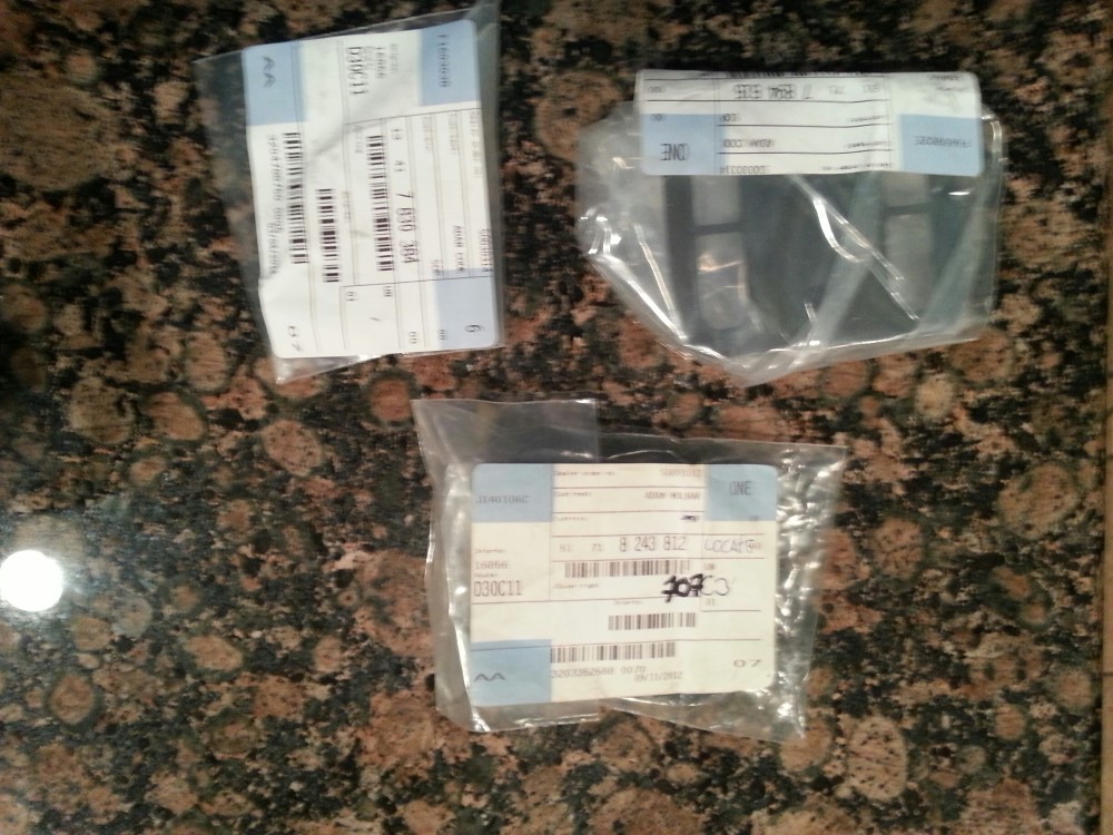

Box showed up with new floor mats. 12 year old ones are still decent but have seen the millage and 12 years of drives. Also got some new O rings for the coming motor work and wheel cover. No longer have break ducts so closing them off from the wheel well.

Sorry for the delayed update. Car has been finally dropped off at the shop for the head removal and other CSL parts install. Head is heading down to LA to have the CSL valves, Supertech springs and retainers, head work, and intake port match work done.
I hope to post pictures of the Vanos rebuild here in the next week or two.
