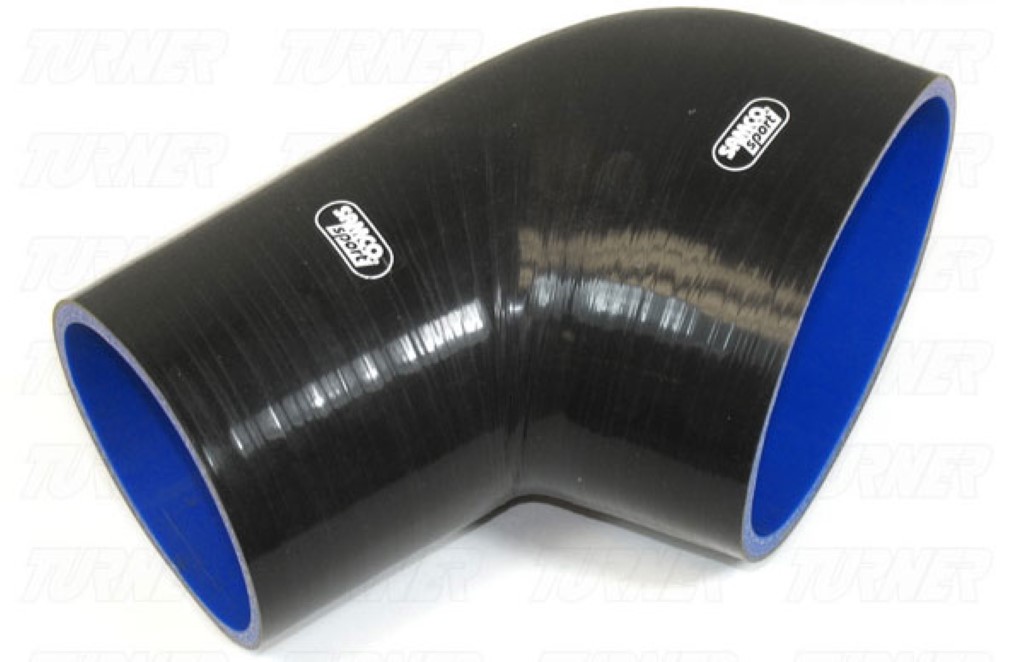

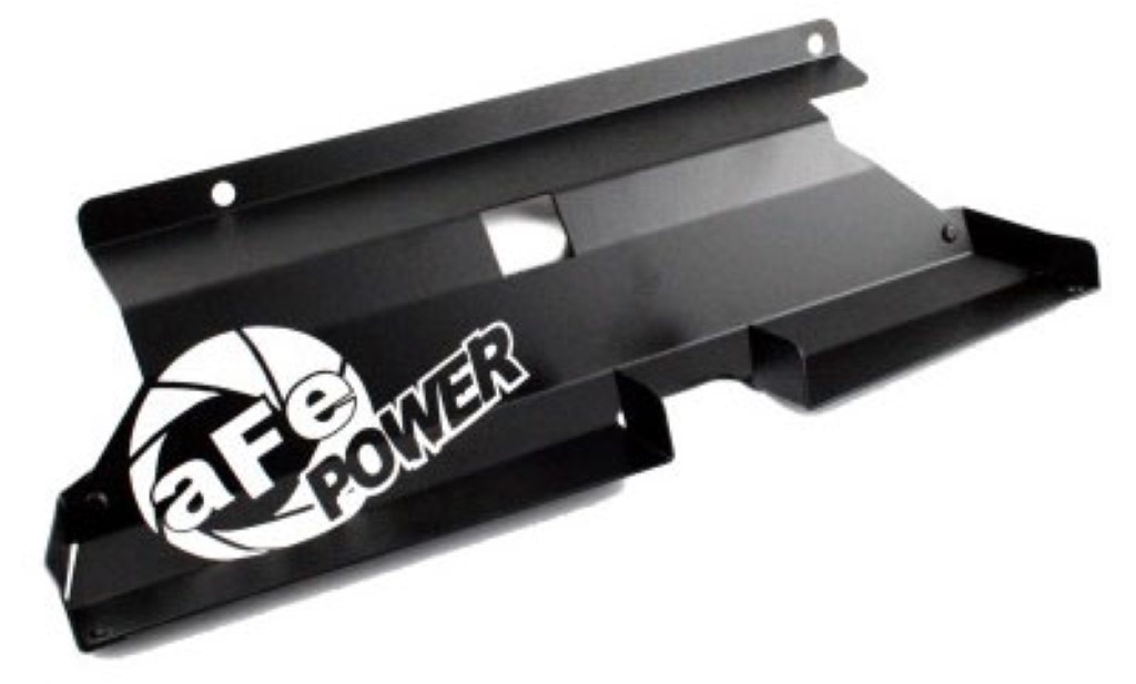

In March of 2011 I ordered the Samsco intake elbow and AFE intake scoops. These were the first upgrade to the car in years sadly

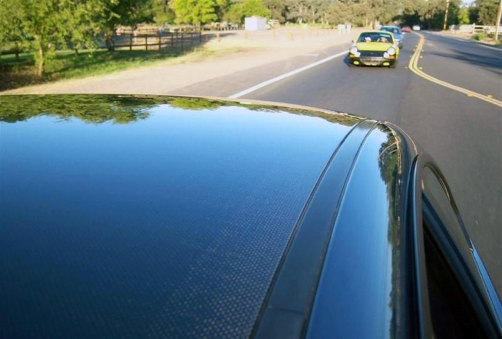

BMW CSL Carbon Fiber Roof

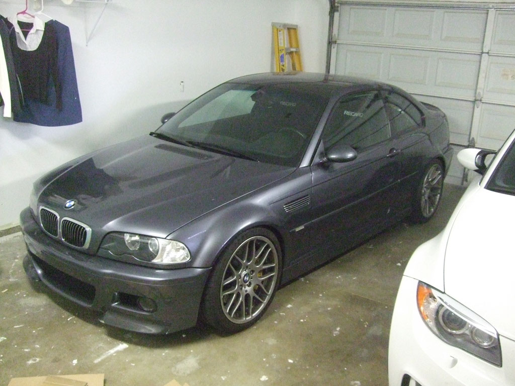

In April of 2012 I went to the Sacramento Delta to take photos of both the M3 and the 1M. The wife drove the 1M and helped me take some cool pictures of both cars. I was hoping to get some better pictures but that just means I just have to go back out there and take more, oh darn.

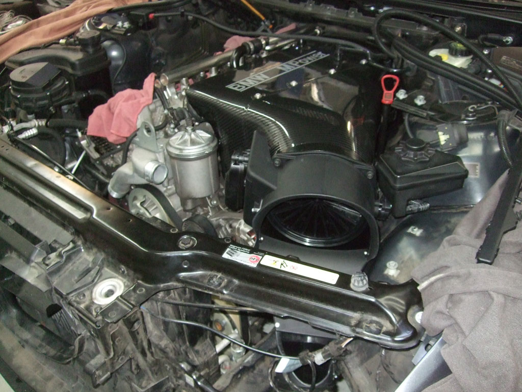

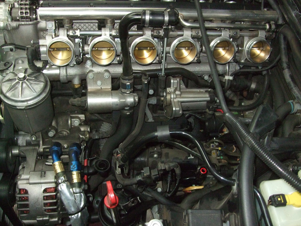

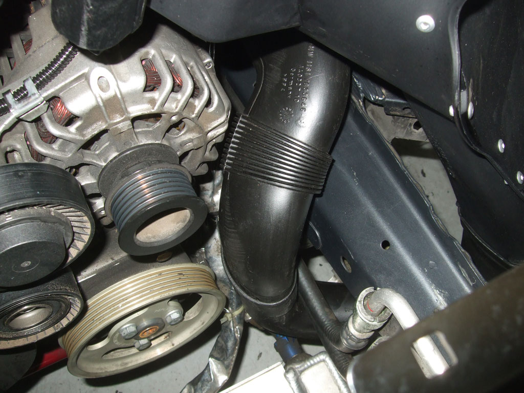

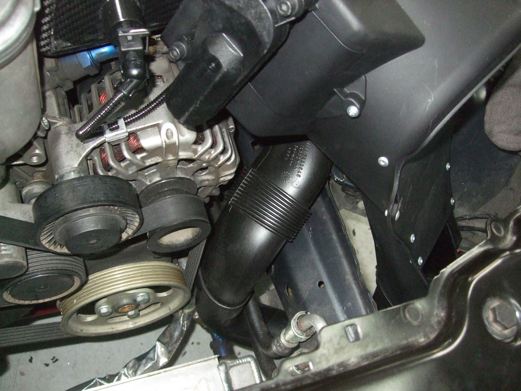

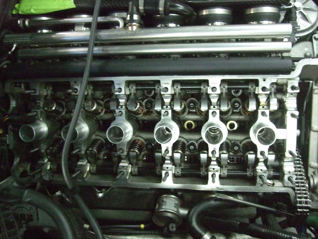

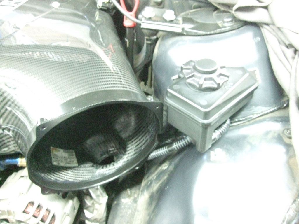

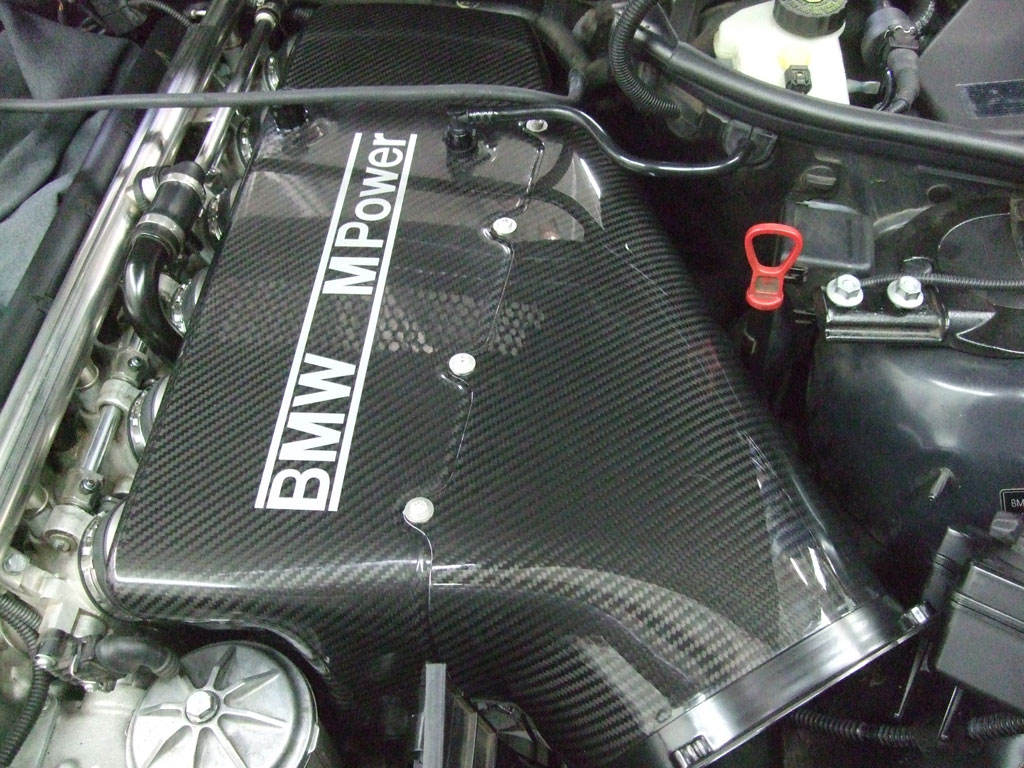

By May of 2012 I had the light bulb moment that said dam the torpedoes and full speed ahead on the CSL conversion. So I placed my orders in May for a LARGE amount of parts. The following list is what the first round of modification entailed.
BMW CSL Airbox (kit)
11617833496 --- AIR COLLECTOR
11617831740 --- BRACKET
07119902973 --- HEX BOLT WITH WASHER
07119900398 --- HEX NUT X2
11617831745 --- MUFFLER CLAMP X6
11617833497 --- UNFILTERED AIR HOUSING
11617833648 --- INTAKE
07129952137 --- HOSE CLAMP
11617833646 --- AIR DUCT
11617833645 --- SUCTION TUBE
07119905016 --- COUNTERSUNK SCREW X4
07119901780 --- FILLISTER HEAD WITH WASHER
16131176747 --- PLASTIC NUT
07119931115 --- FLAT WASHER X2
07129952127 --- HOSE CLAMP
11617833647 --- AIR SHUT OFF CALVE
11157833649 --- VENT HOSE
13717896774 --- INTAKE MANIFOLD
13621739510 --- TEMPERATURE SENSOR AIR
13727838625 --- BMC AIR PANNEL FILTER
SMG tank to replace the one on the stock airbox
21532282549 --- Expansion tank for SMG fluid
BMW Center console
51167895578 --- Console-CSL
51167896362 --- Frame-CSL
51167896361 --- Frame- CSL
51167896956 --- Insert-CSL
51711904843 --- Blind plugD=23MM X2
34417896360 --- e-brake boot
51168235570 --- Bracket
07129901644 --- Body Nut X2
71111180290 --- Sheet Metal Screw X2
I am making CSL door panels in alcataera. I got the idea from the interior of my 1M. Also I wanted to be different then everyone.
51417896919 --- Door handle front left-CSL
51417896920 --- Door handle front right
Differential upgrade. This is all the items needed to make a kit.

Samco radiator hose kit
