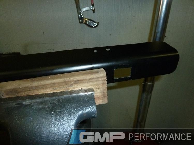

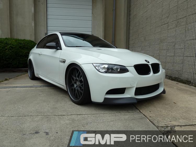

This 2011 M3 is an on-going track car project. Our customer wants to keep the car streetable, but wants it to be safe, fast, and fun for open track days. Our first round of modifications has included some aesthetic tweaks, handling improvements, engine upgrades, safety equipment, and some other goodies.

Autopower Industries Roll Bar (powdercoated white to match)

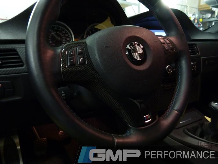

Carbon Fiber steering wheel insert

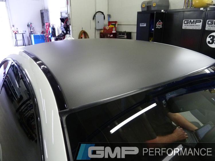

Matte-clear vinyl cover on OE carbon roof

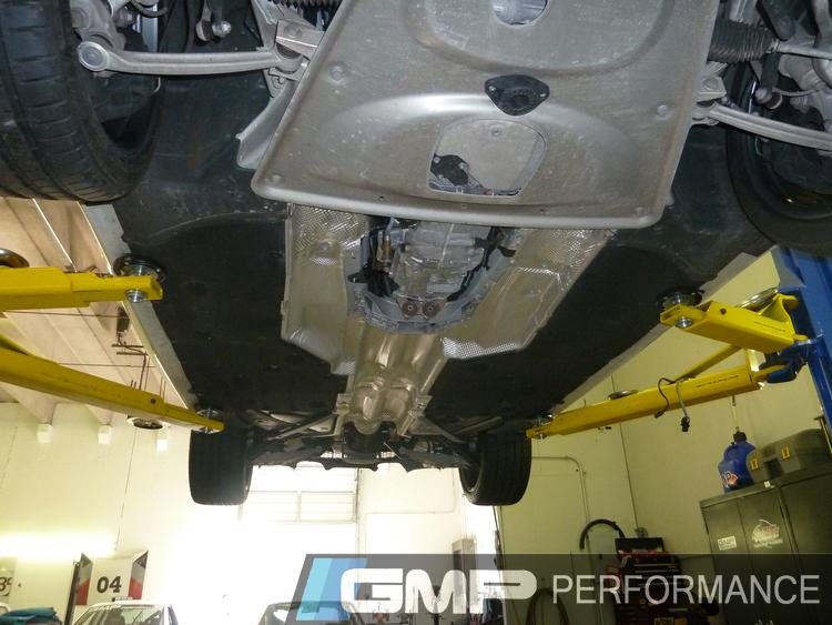

Exhaust

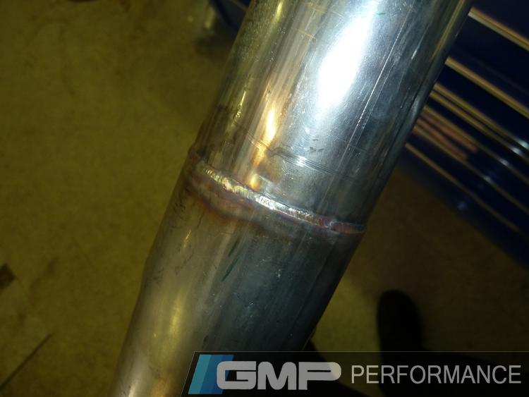

The exhaust system had previously been installed on our customers 2008 E90 M3 Sedan which he traded in on this car. For the installation to the new car we powder coated the rear sections and added cat-less downpipes.
Stock Exhaust Out
The Powder Coated Exhaust
The system was too short so we added piping and off to the welder we went

Carbon Fiber Steering Wheel
Matte Carbon Roof
