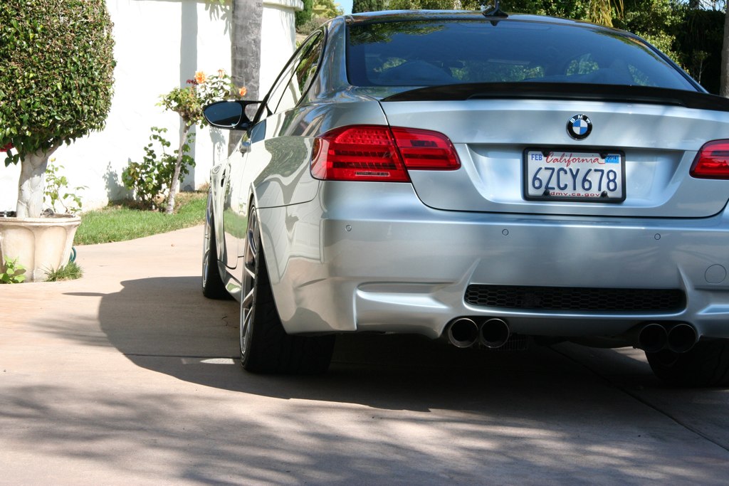

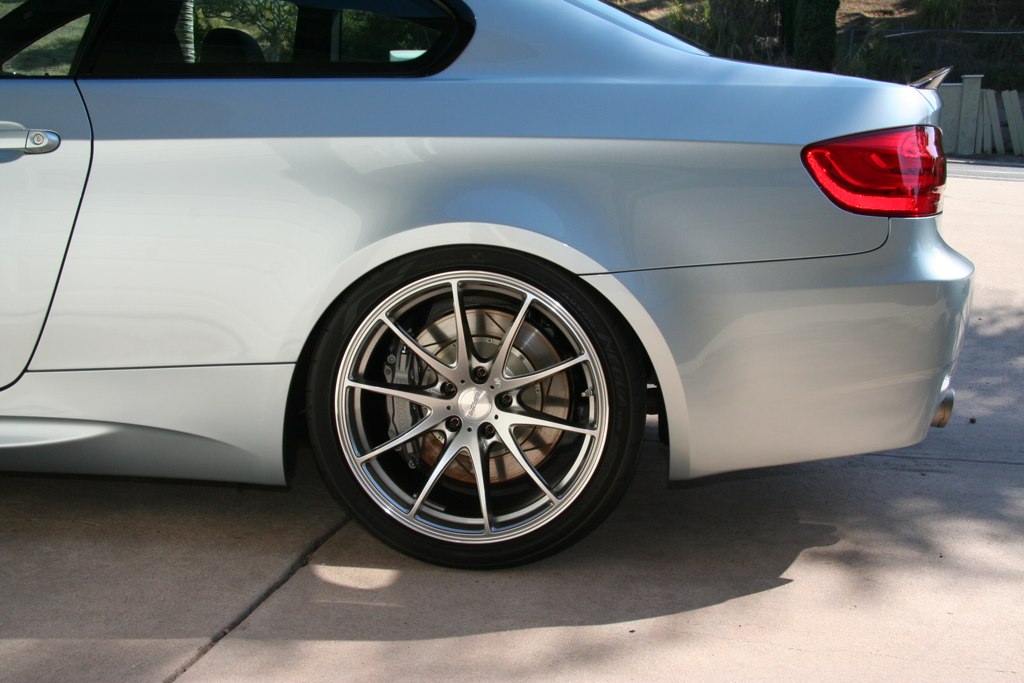

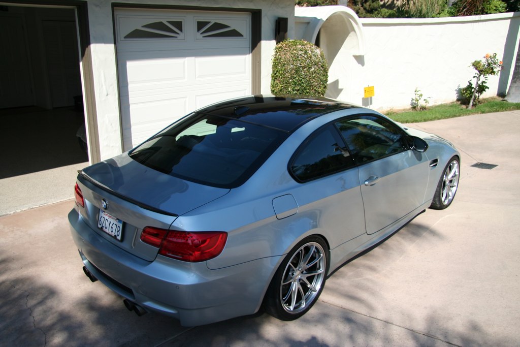

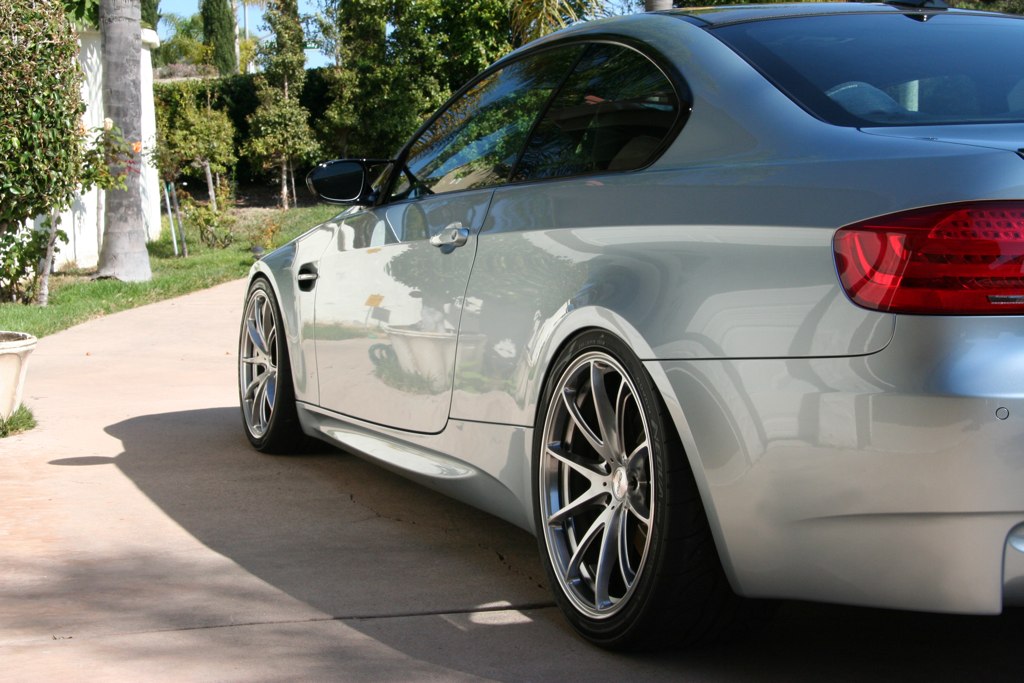

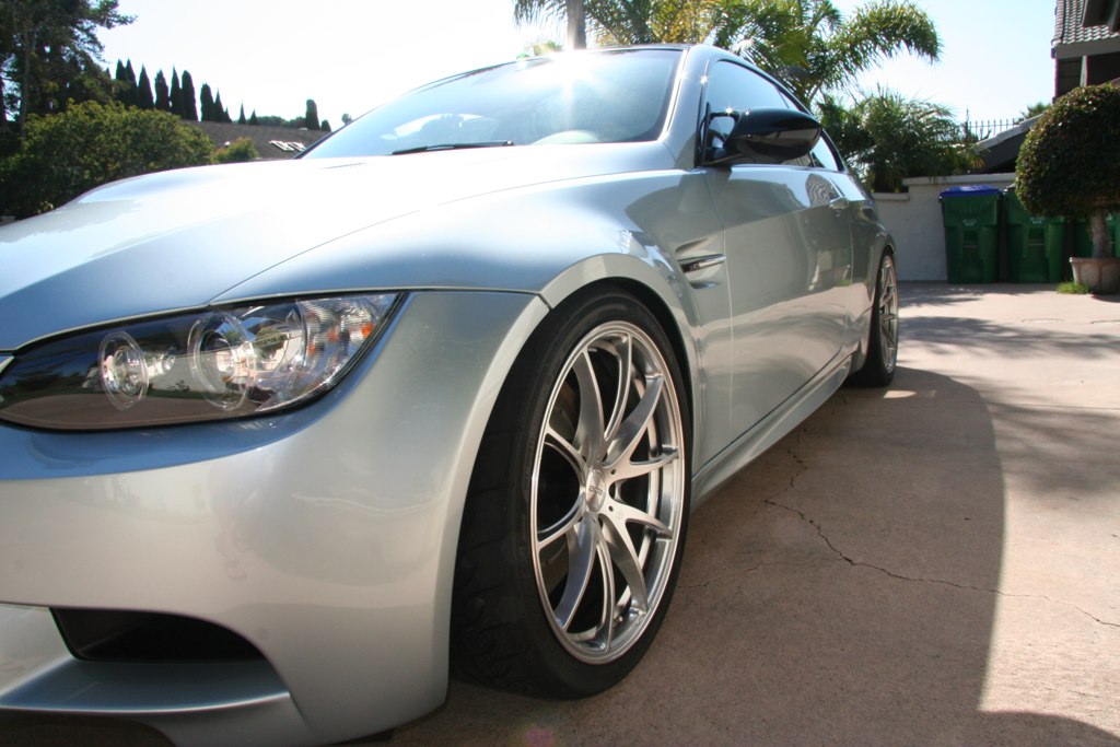

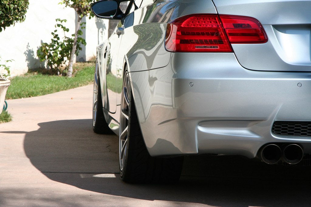

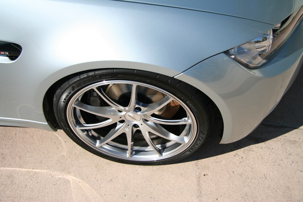

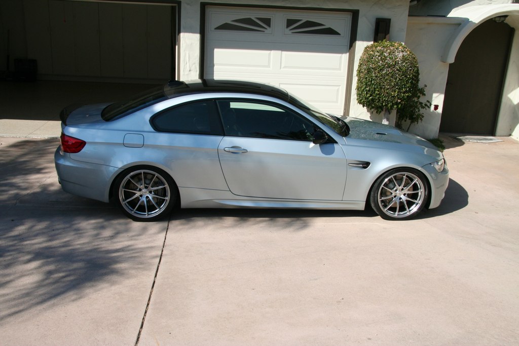

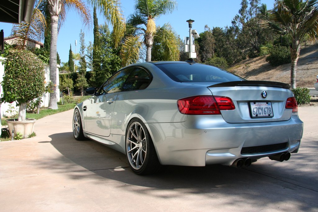

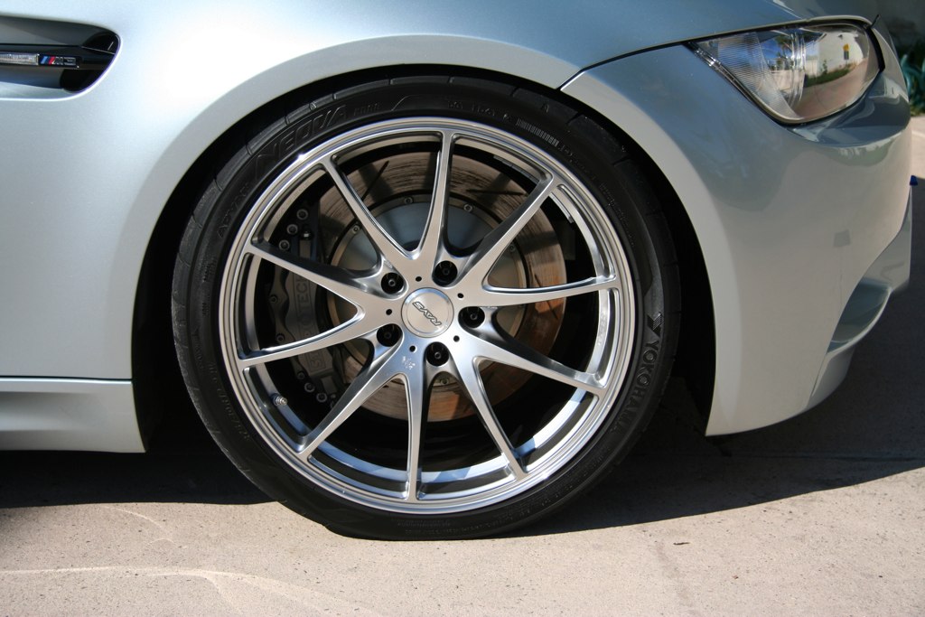

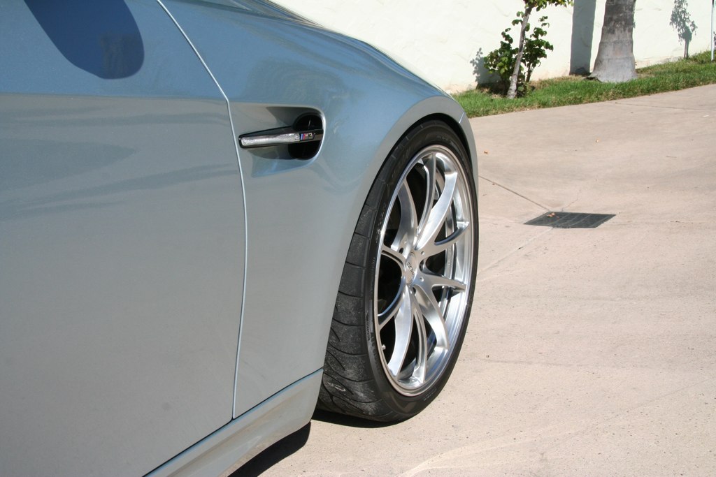

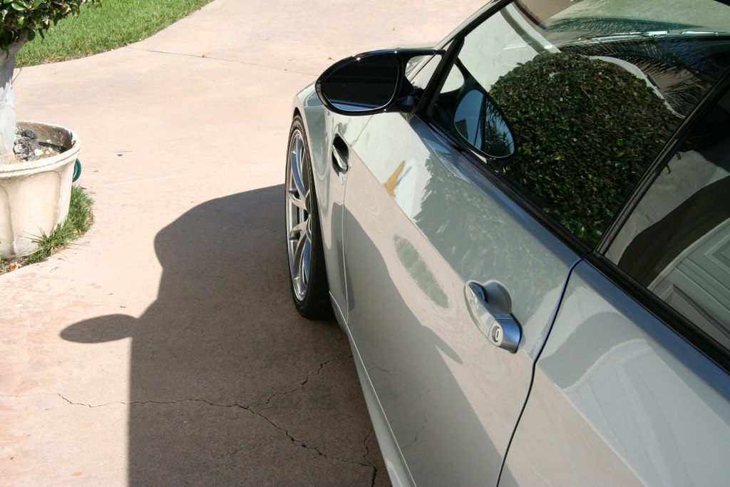

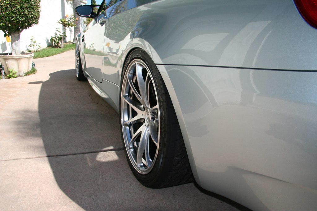

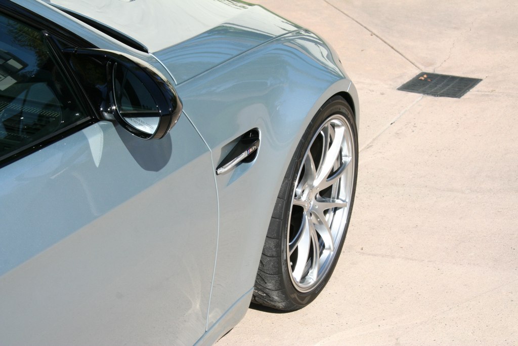

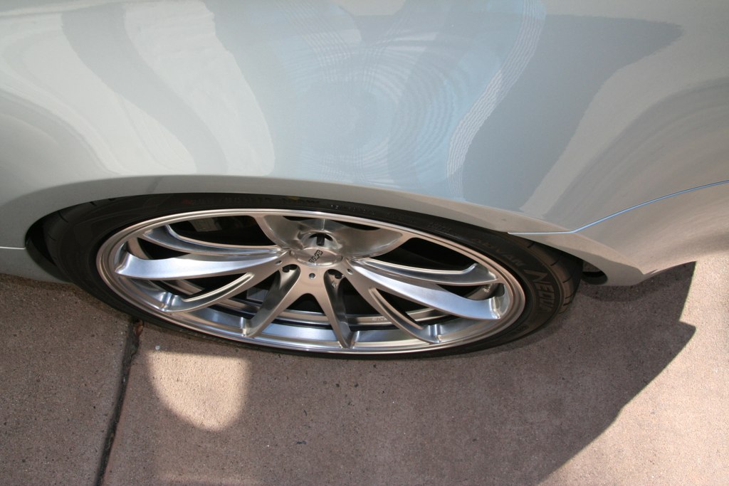

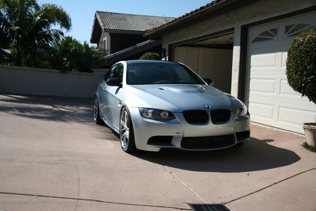

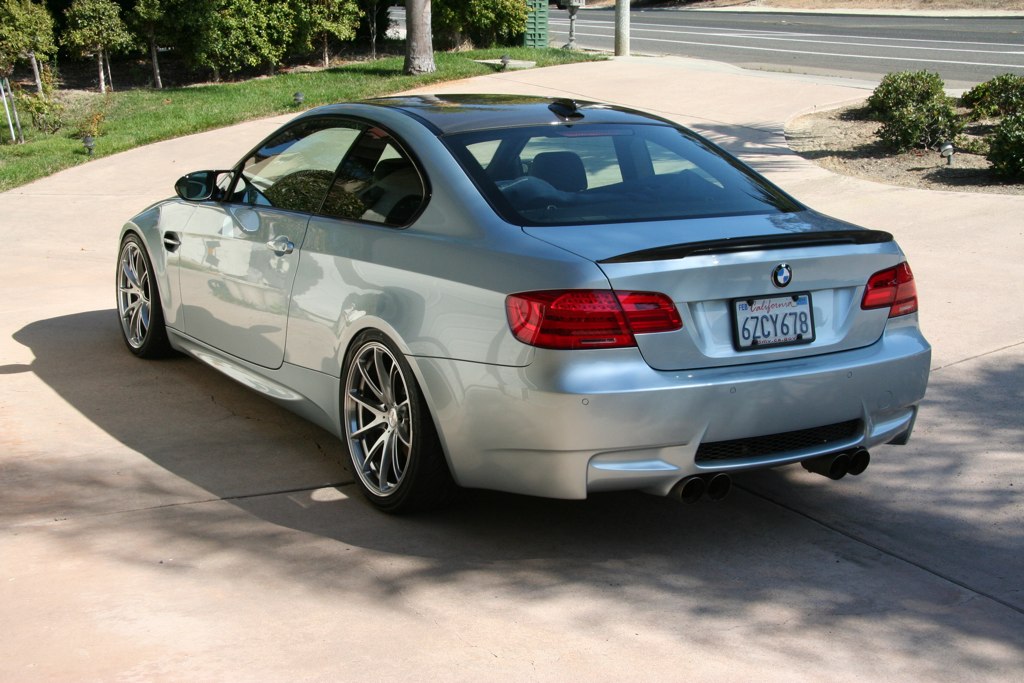

I have had a set of Volk G25's for a few months and finally got around to taking some pictures. The size/offsets/fitment on the wheels and tires are fantastic. They are very light weight, with the fronts weighing 20.0 lbs and the rears 20.5 lbs.
Volk G25 - Mercury Silver II
Wheel Size / Offset: 19 x 9.5 et23 and 19 x 10.5 et25
Tires: Yokohama AD08 - 275/30/19 and 295/30/19
Spacers: Front - 5mm to clear KW clubsport coilovers, Rear - None

any rubbing in the rears

No rubbing in the rear. I have a 5mm spacer in the front to clear the KW helper spring. Fronts rub very slightly at full lock.
