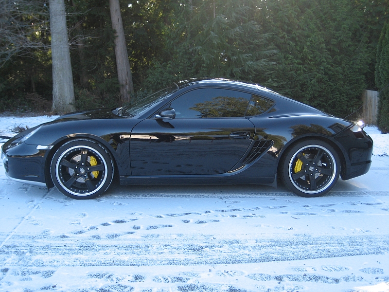

E-bay .Some place in so cal Santa Ana or Garden grove Ca I believe.It was 2 years ago .Here is my updated Pics with the ALL yellow Calipers.Looks much better I think .NO brush strokes and OEM looking .Used Duplicolor Caliper Paint and did not remove the calipers Just masked off everything real good and did 1 wheeel at a time with my floor jack .took about 3 hours do do all 4

E-bay .Some place in so cal Santa Ana or Garden grove Ca I believe.It was 2 years ago .Here is my updated Pics with the ALL yellow Calipers.Lokks much better I think .NO brush strokes and OEM looking .Used Duplicolor Caliper Paint and did not remove the calipers Just masked off everything real good and did 1 wheeel at a time with my floor jack .took about 3 hours do do all 4
