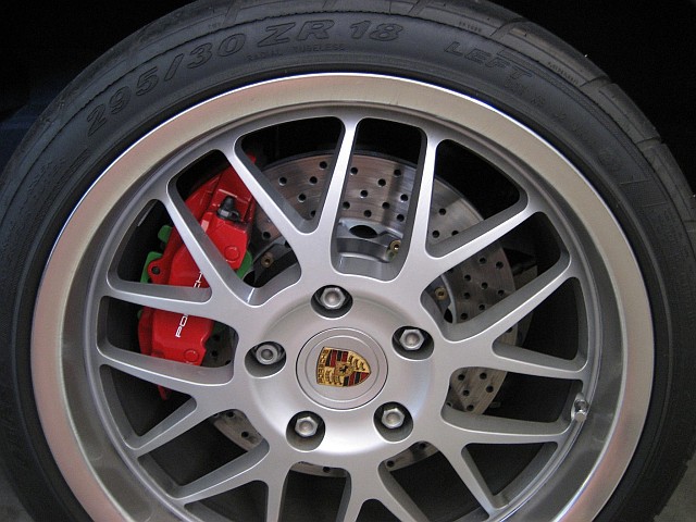

Stage 3
So why even a stage 3? Well, I wanted even more rear brake bias. The only way to do that was to increase the rear rotor diameter. I also wanted aluminum 2-piece floating rotors. Why? The same reason why people "need" a 911 Turbo or a GT3. I'd spent a couple years researching all the dimensions and trying to find someone to fabricate the custom rotors. There are a couple places out there, but honestly, I was not impressed with their quality. A huge problem that you run into is that there are almost no rotor blanks out there with an annulus big enough to fit Porsche calipers and pads. In fact, that causes a problem with the Performance Friction 2-piece rotors--they use steel hats which weigh more than OEM and have pad height interference problems. In order to fit aluminum hat hardware, you must grow the diameter of the rotors (front and rear). Well, I finally found a company that would make the custom rotors for me. I have no affiliation with the company and will post the name later since I'm not even sure they're set up yet for volume production of these rotors. The quality of the work is really too nice to even mount on a car. The top guns in the company used to work for Porsche and Brembo. They know what they're doing, and they have some nice equipment. Their work is pure eye candy. They were also patient enough to work with me for OVER 1 YEAR with countless measurements and prototypes. The incentive for them is they are also making a Cayman S set (which would also likely work on Boxster S and non-S 996s/997s) with minor differences to mine.
I still need to change my front tires, but now that they have been fully broken in, I can say that I am quite satisfied with my stage 3. The braking is really insane, and the brake bias is about dead perfect. My brakes are 340mm front and rear with excellent cooling and heat soak. Considering the aluminum hats, I saved 2 lbs per corner in the front, but lost about 3 or 4 lbs per corner in the rear. My goal was to net very close to stock weights and front unsprung weight is more noticeable to me. I also retained the parking brake. Considering that PCCB saves 50% but this is over the weight of 350mm steel rotors, I figure I'm within a pound or two of PCCB but with slightly smaller rotors and with a lot less cost. With steel rotors, I can also trash on them as much as I want and use any odd pad. With PCCB, I'm sure there is even more ultimate heat soak/dissipation capability, but for my needs and for the weight of my car, my setup is perfect--for me.
I'm posting this first on 6Speed since it is a rather mod-friendly board and it is a Boxster/Cayman board. I know there are strict rules on selling/sponsoring. I am not affiliated with the company that made my custom rotors, but will post their contact info and rough pricing once I talk to them and see where they are in supporting Porsches in a more general production manner.
P.S. Here's a picture of my Stage 3 rears. Note, these are cross-drilled (spouse-friendly) one-offs. All "normal" rotors will be slotted.
