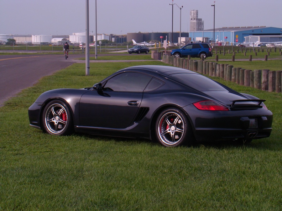

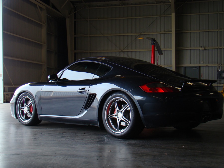

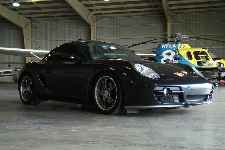

just got the PSS9 installed the other day... thought i'd show some pics..

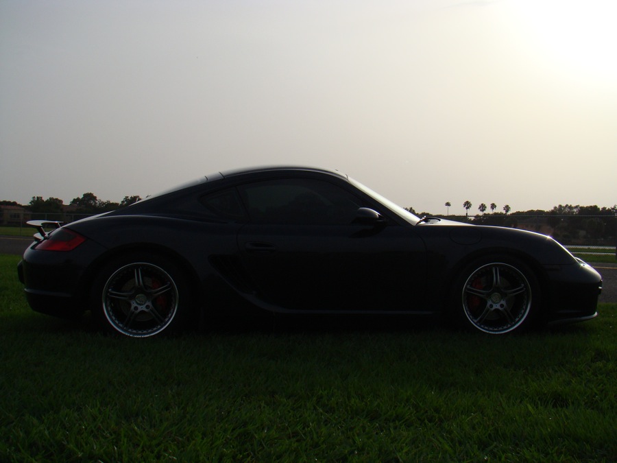

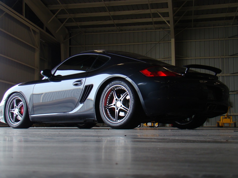

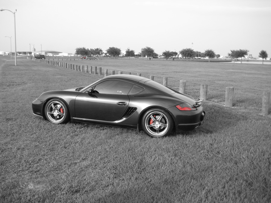

few more

Just curious, what size & ratio are those tires?

How low did you go on the shocks?

Rear 265/40/18
Front 235/40/18
stock tire set up

well i believe its around 1" front and 1.5" rear and the dampening/rebound is set to setting 6.... i still have to get alignment and corner balancing but thats not till next week...

the car looks ****. perfect drop.

Nice job! The tires look a little ballooned but that might be because they are 18's. I like the look though. I have PSS9's as well. Setting is 6 in the front and 2 in the rear. I did that to get rid of a little understeer since I have running 15mm spacers in the rear.
