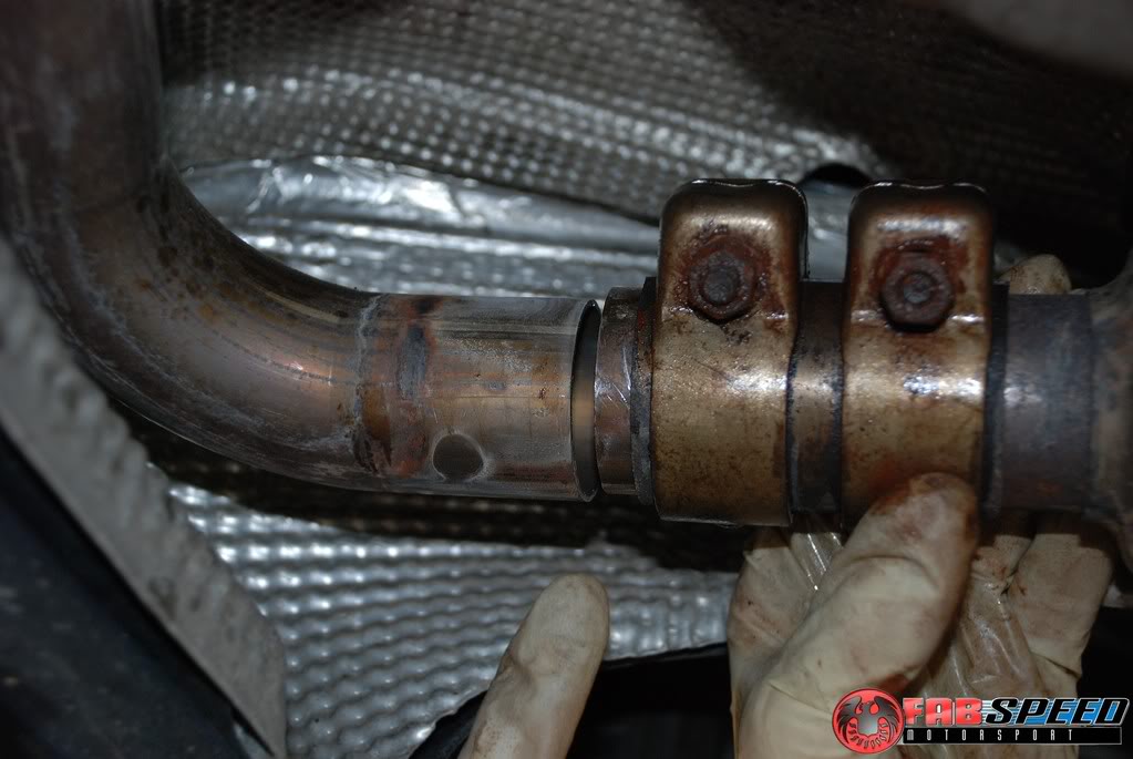

2. Loosen the 4 nuts that hold on the 4” factory clamp
3. Then slide the clamp over towards the cat

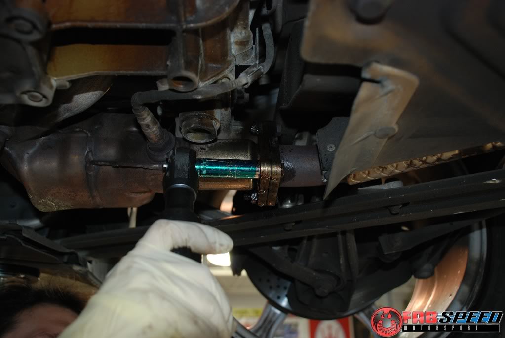

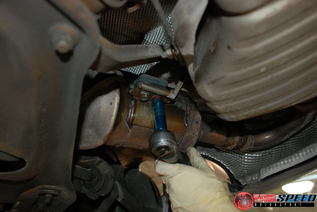

4. Loosen the 2 nuts that hold the cats to the mufflers

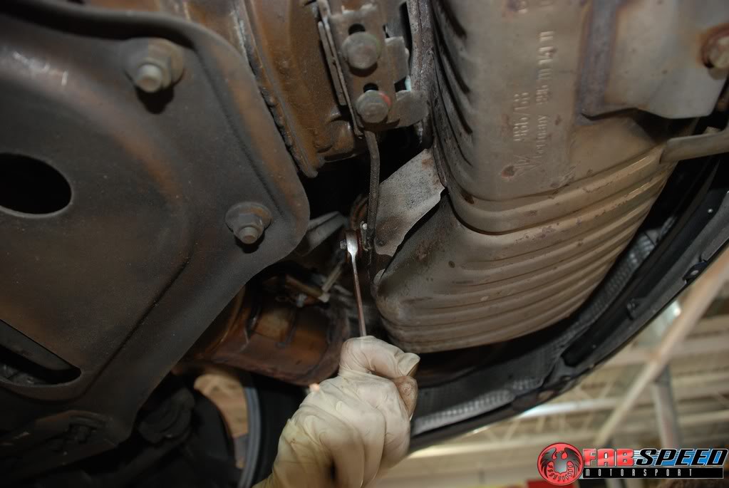

5. Remove nuts on the bottom brackets that hold the muffler

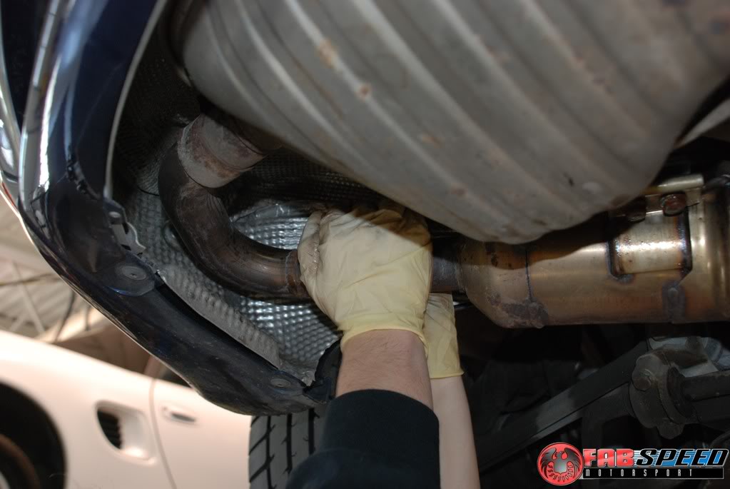

6. Remove bolts on the 3 bolt flange where the headers meet the mid pipe

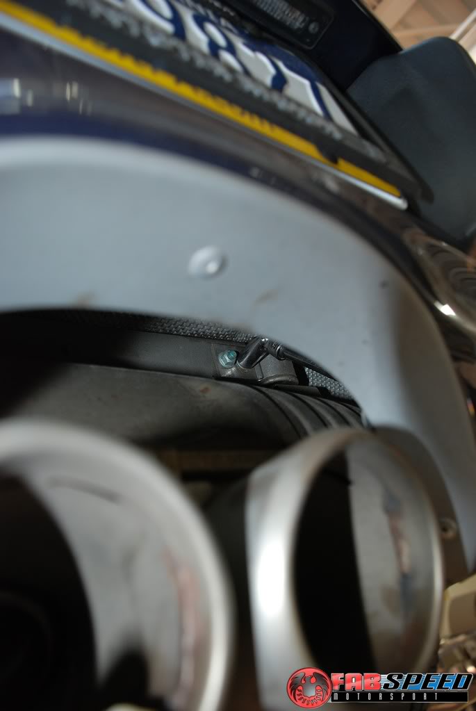

7. Remove the top mounts by taking off the 2 13 mm bolts and nuts that hold the top mount
