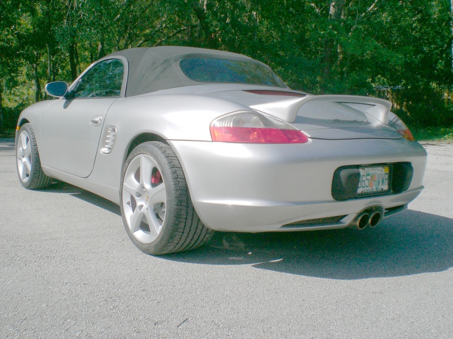

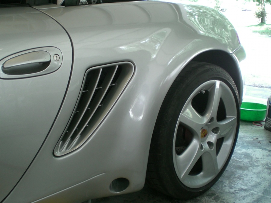

I put 11" wheels from a Carrera 4cs on my 04 S but I needed a 31mm spacer to clear the shock towers. your 05 has wider quarter panel then mine so they should fit fine. like the other guys said its all about the offset and you can get any size spacers you need. I have some extras if you tell me what size you need.. BTW the offset is stamped on the outside of the wheel by the tire valve. I did flare the quarters out later, like I said you shouldnt have to do that.
