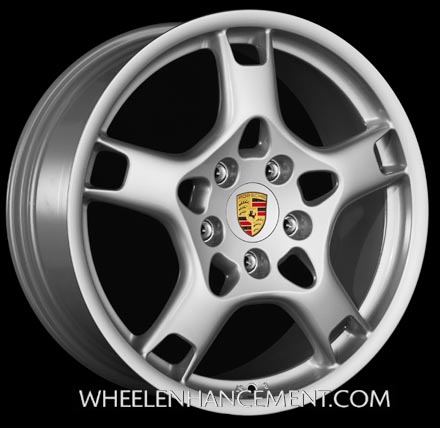

Does anyone know the specs for the 19" Carrera S wheels (that can also be optioned on a Boxster)? ie. what width, offset and weight are they?
ps. These are the wheels I'm talking about:
http://www.wheelenhancement.com/Imag...rreraS_obw.jpg

I believe they come in various specs depending on model of the vehicle. On 997, I've seen 19x8 et57 for front and 19x11 et67 for rear. I have these on my 987 and they're 19x8 et57 front and 19x9.5 et46 rear. Sorry, I don't know what their weights are, maybe someone can chim in with that info...or additional info.
Thanks ... I have them on my 987 as well so I would think that they're the same spec as yours.

FYI - width & offset are usually stamped on either side of the valve stem on factory wheels.

Somehow one of my rear wheels is now buckled ... and cannot be repaired :-( It looks flawless (ie. no visible damage), but is no longer straight. So I'm wondering if anyone can tell me where I could find a 2nd hand or replacement wheel?
ps. It's the wheel shown in the link/picture here, and is sized 19X9.5 et46. Thanks in advance.
