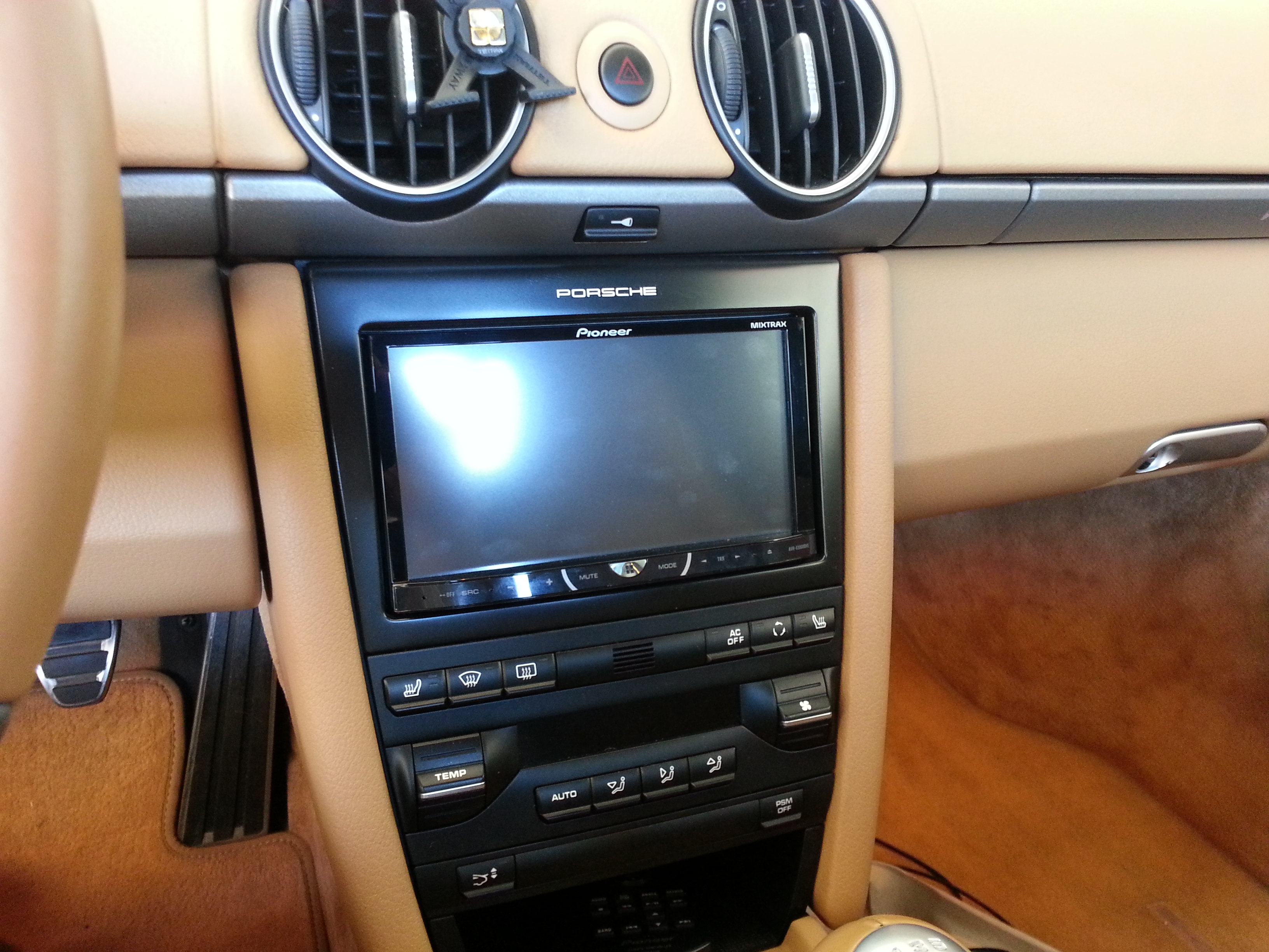

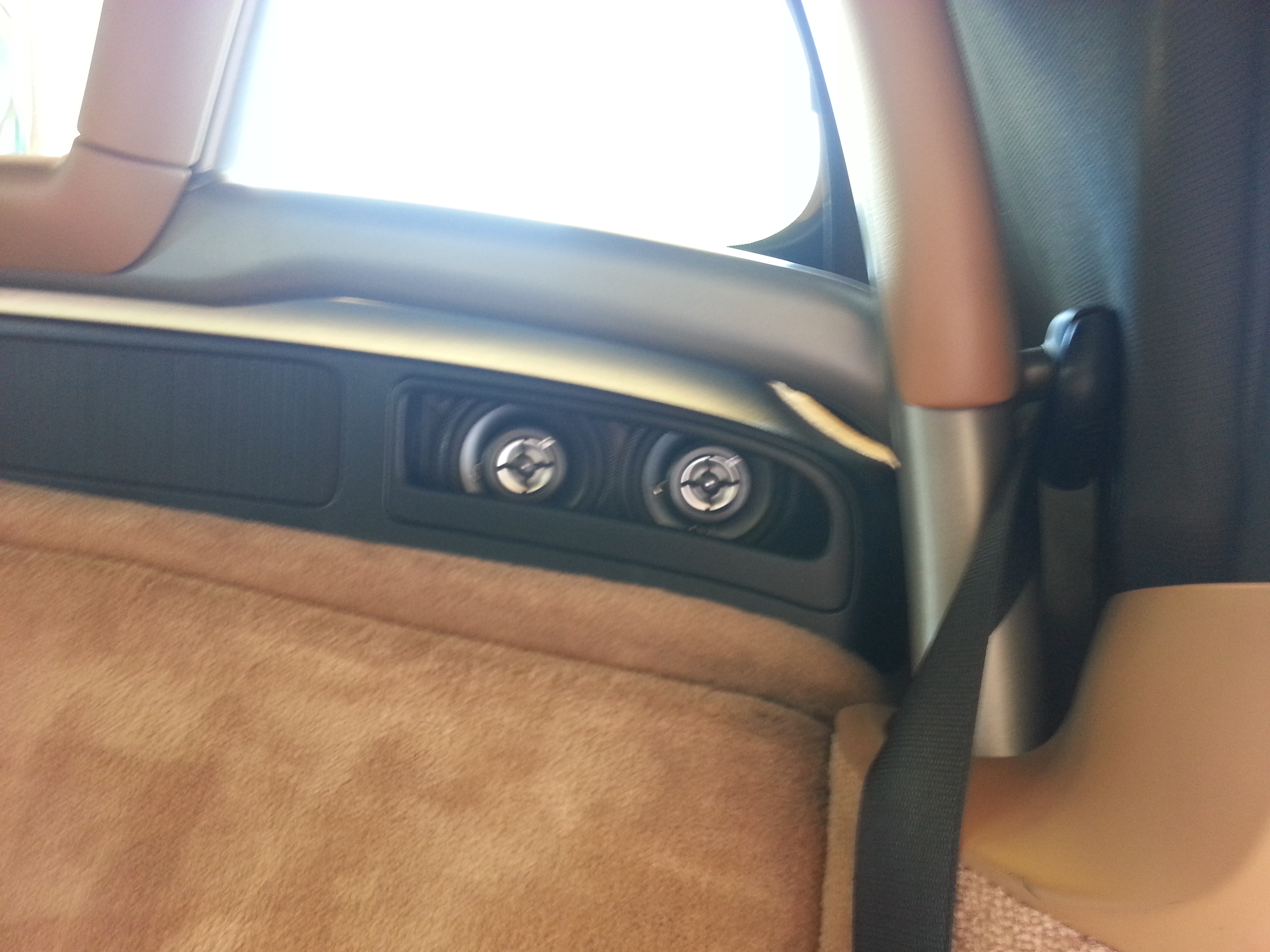

What you need to do is get the After Market Radio Installation Kit from Suncoast its a little pricey for $250 but well worth it...That's what I did to install a Pioneer AVH-X5500BHS which is a double DIN unit in my 2010 Boxster....The kit comes with everything you need, including instructions did the job myself...Here are the Pics...Also, if you install a new head unit you will need new front door speakers the ones that Porsche use look like they came from the 60's. I put 6.5" Alpine speakers they fit perfect no modification needed. I also installed 4 3.5" Kickers wired in parallel in the rear storage bin...Got the mounts from Pelican parts had to do some trimming to make the holes big enough for the speakers, but all I can say is WOW...the sound is unbelievable. Going to get a small 300w Alpine amp...just for added sound boost. But installing the rear speakers really drowns out the engine noise.
The are a little blurry...had to use my phone camera...Sorry
