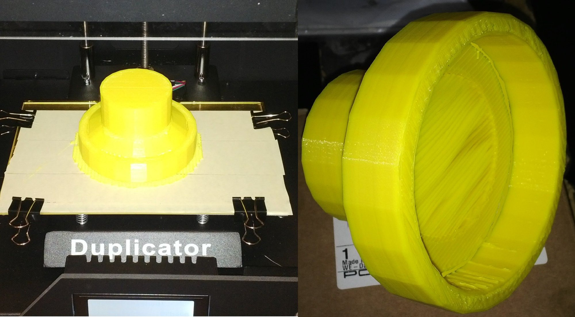

I managed to destroy my first rear main seal by pushing it in too deep, and the only way to get it out was to destroy it !
I then decided to 3d print an installation tool, which actually turned out quite nice
It worked quite well, I was a bit doubtful about the strength when tapping the seal in, but I used a rubber mallet and it went in quite easily and was plenty strong enough (material is PLA)
I worked the RMS installation depth into the design of the tool, so I did not have to worry about pushing it in too deep this time.

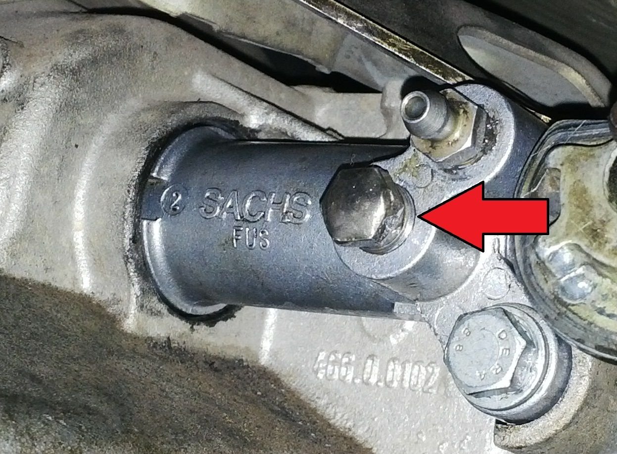

The thing that caught me by surprise was re-installing the clutch slave cylinder. It came out quite easily so I didn't think putting it back was going to be any drama, but boy was I wrong!
After reinstalling the transmission and exhaust (which was also a bit of a pain) I thought I was done. Then I found it almost impossible to maneuver the slave cylinder back into place. I was unsure whether the rod that pushes the clutch lever was actually engaging correctly, so I was hesitant to force it. After about an hour of struggling, I decided to leave it and think about it overnight.
So anyway my solution was to disconnect the fluid line, and then compress the cylinder ie push in the rod and then lock the cylinder with a plug (thereby using the hydraulic force to hold the cylinder in). I then only had to overcome the internal spring force when pushing the cylinder into place.
The slave cylinder then went in quite easily.
I must now bleed the slave cylinder and install a few more bits under the car and she will be ready for a the road !
