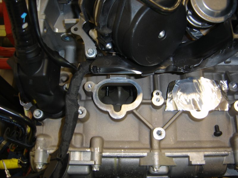

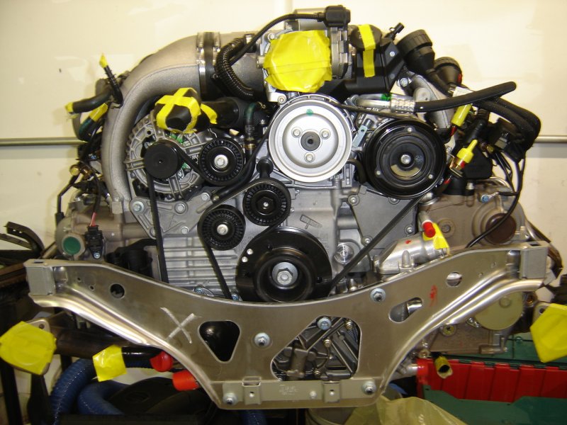

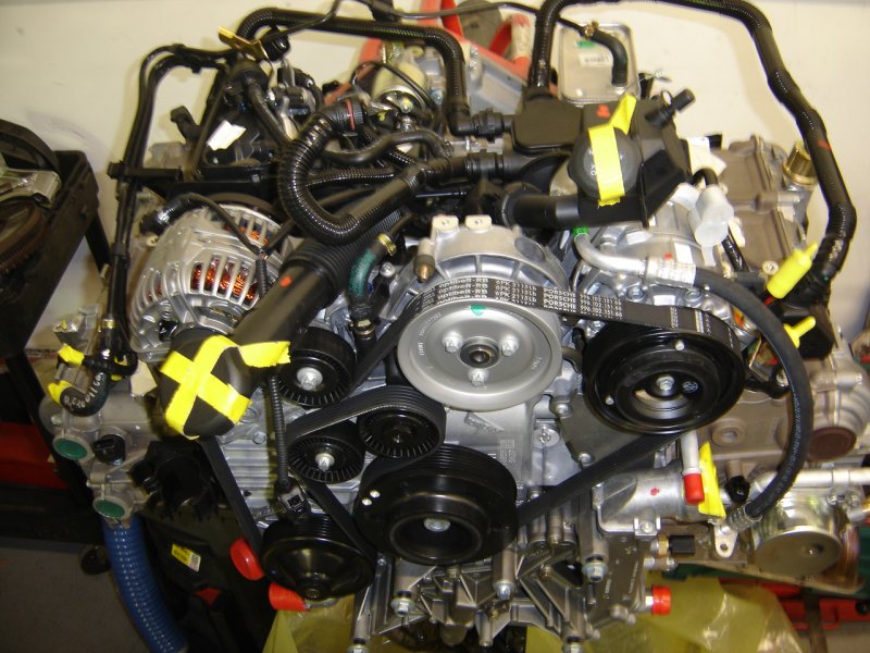

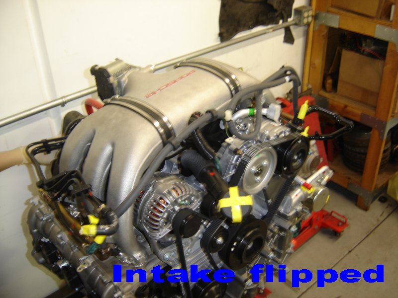

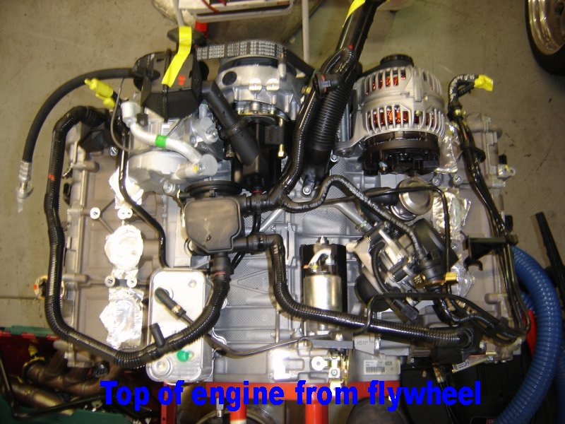

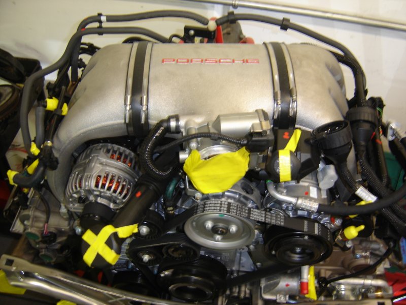

Let the fun begin. The first thing we did was determine what needed to be yanked from the "crate engine" prior to install in Cayman. This is pretty straight forward. We have past experience with 996 engines into Boxsters..soo.. no brainer. See pics Follow along at home.. its easy!!
B
Old Apr 7, 2006 | 10:12 PM
  #41
Brad Roberts's Avatar
Joined: Sep 2004
Posts: 161
From: Alta Loma, CA
Brad Roberts is infamous around these parts

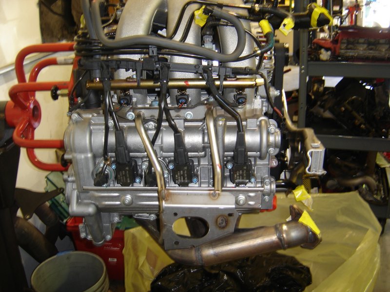

In the pics above we removed the exhaust and muffler hangers, removed the intake manifold, and removed the 997 engine mount.
In the pics below we start with flipping the intake around for the Cayman. This intake is much taller than the Cayman/Boxster intake. We know this from the other conversions. Most shops lower the 996 engine in the chassis around 20mm's or so. Our plan is to use/make a different engine cover. When you drop the engine, it really really makes keeping headers under the car difficult. We would rather leave the engine UP in the car instead of dropping it down. We will need to flip the fuel rails also from side to side.

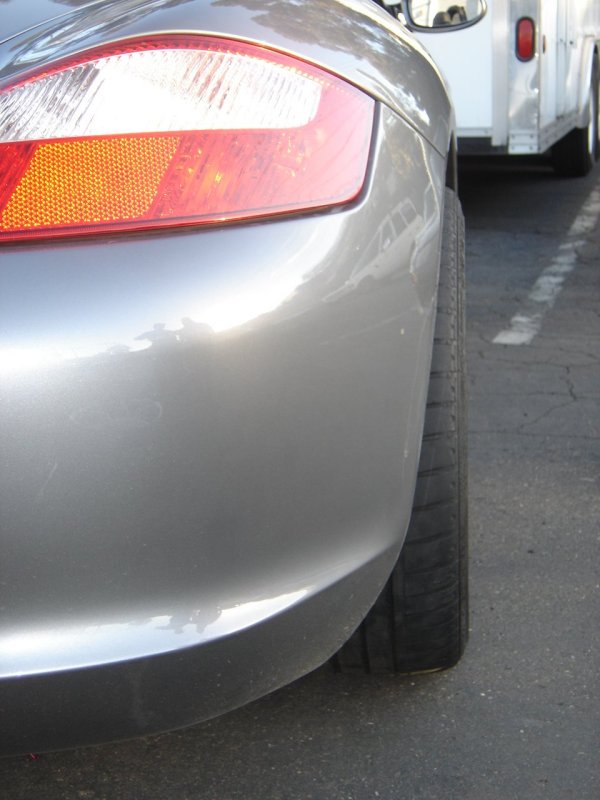

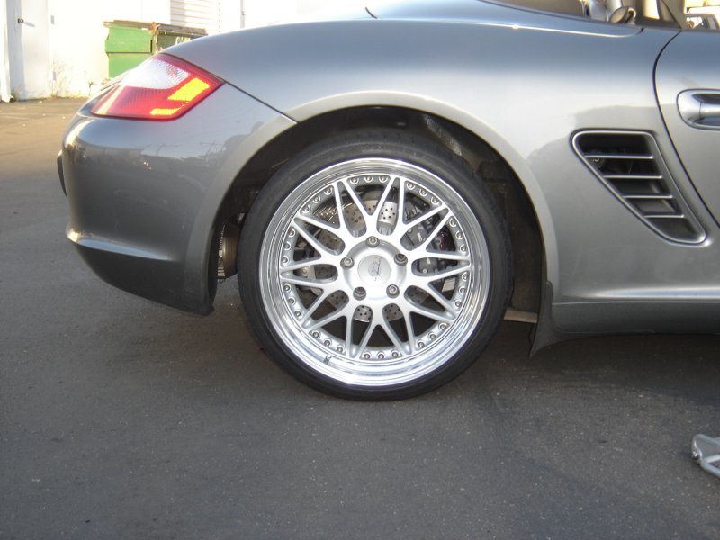

Something else we did tonight: I test fit some 19x11 wheels with a 315 tire on it, onto a 987. These came straight from a 02 996TT. Direct bolt on. Check it out. This means you can put A LOT of tire under the CaymanS and the 987's.
One more thing: I also test fit some 986 stock rear 17 with a 275 Hoosier road race tire on the 987.. NO problem. Note: this is a stock 987 with PASM. Our shop 986Spec car with 275's and coil overs requires a 5mm spacer behind it to keep the tire/wheel from hitting the lower perch on the coil overs. This will be the case with the CaymanS and the 987's also with 17's/18's/19's and coil overs.

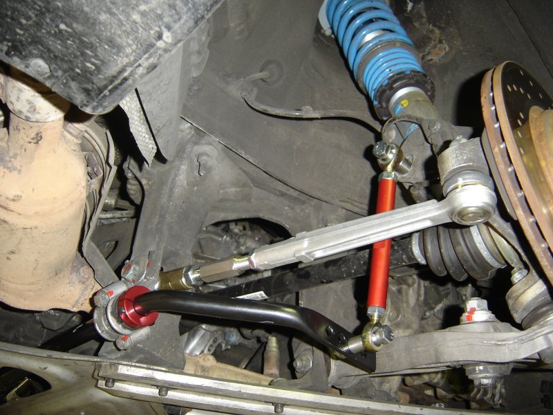

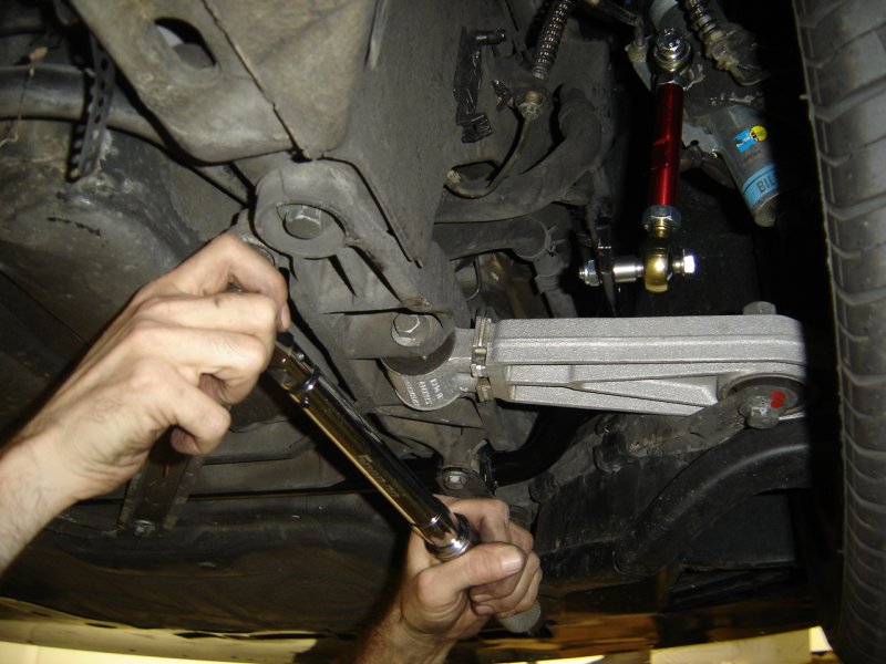

NEW 4 way adjustable rear 986 bar with NEW heim joint drop links AND double adjustable rear toe link.
We got really tired of blowing out factory drop links with the stupid plastic socket and ball.. this will cure it!!
Also.. how to use a torque wrench on EVERYTHING...and install a GT3 5 way adjustable bar in the front of your 986 with new drop links in place.. ha ha
Oh yeah.. and a good shot of the factory GT3 adjustable control arms for your Boxster
B
