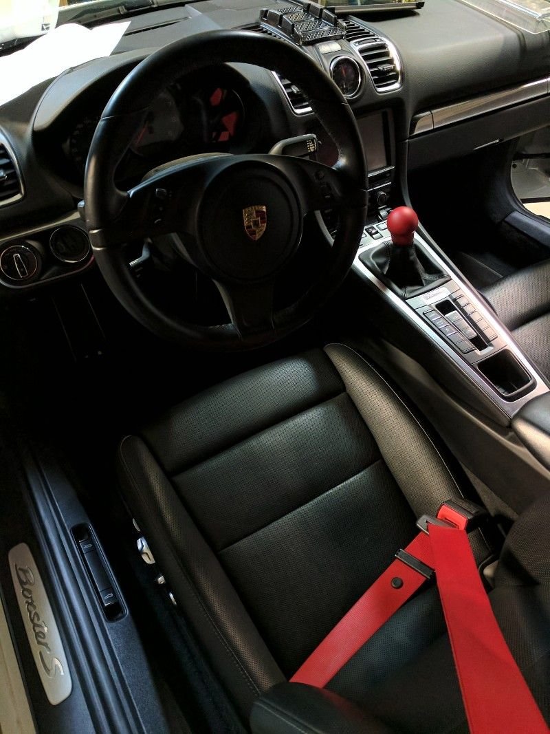

Since my White Boxster S has red seatbelts, I went with the matching Red shift ****:

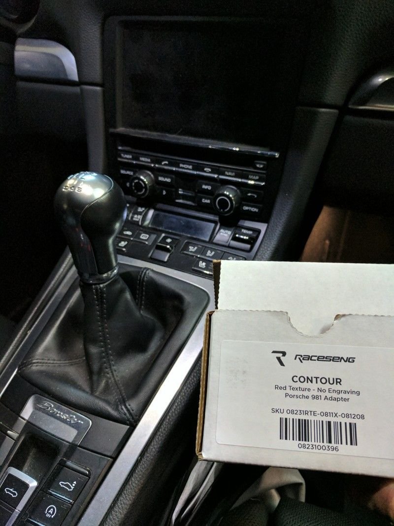

What comes in the kit:

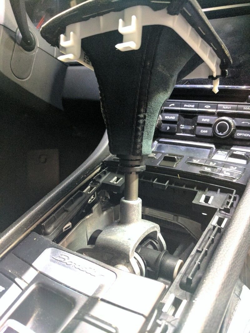

Like shown in several other posts, removing the trim is very easy - just go slow:

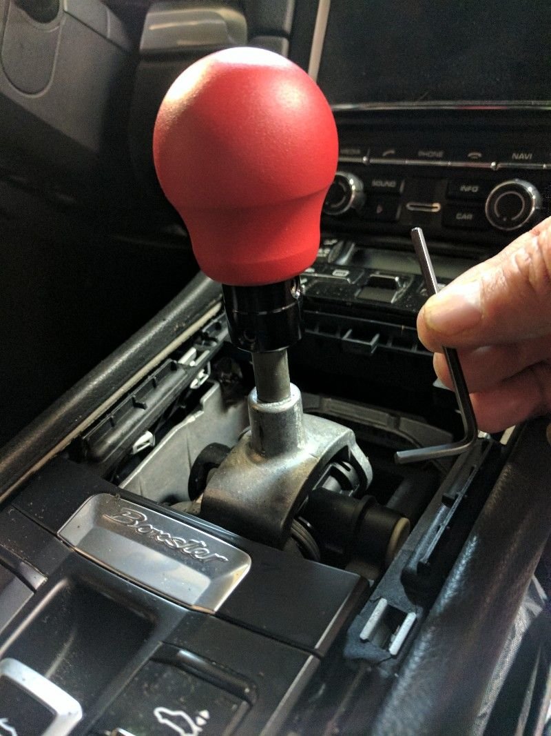

The kit allows to adjust the height of the ****, which I took advantage off by setting it up as low as it would go, therefore giving me a little bit of a short-shift-kit:

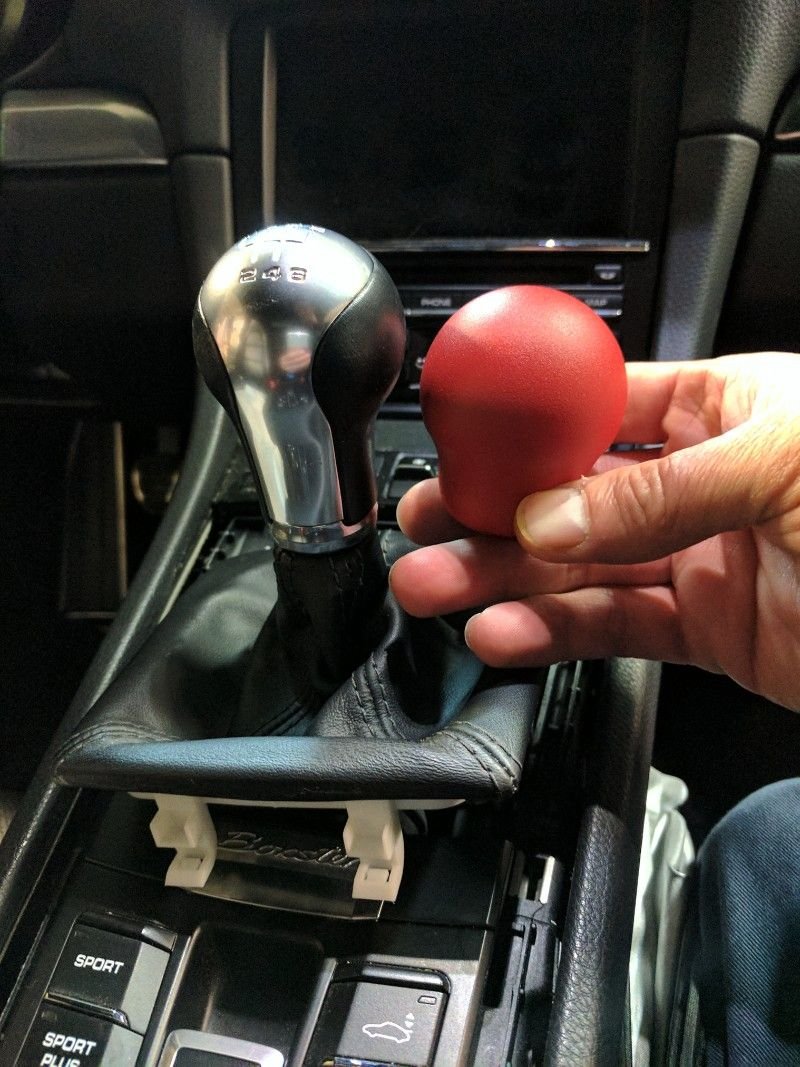

The shift **** is indeed press-fit. You have to simply pull it up, although some are "very" tight, and will take a lot of tries before it finally comes up:
Follow the instructions to fit things:

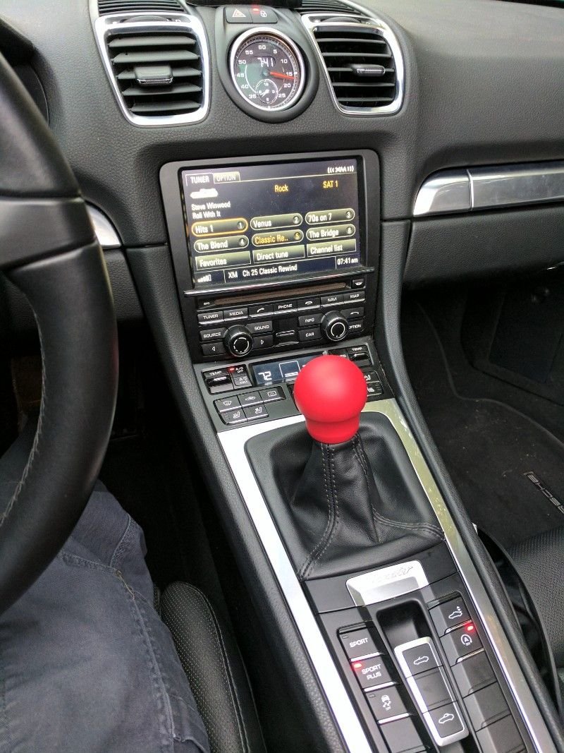

And put the trim back:
Daytime picture on the way to work yesterday (yes, top down):
How does it feel? Great. Much firmer feel, which makes sense since this is no longer plastic covered with leather - it is solid. There is of course a slightly higher shift effort that comes from the **** sitting a little lower (which is what I wanted), but the added weight of the solid SS core helps with that, so I really like it. Highly recommended mod
