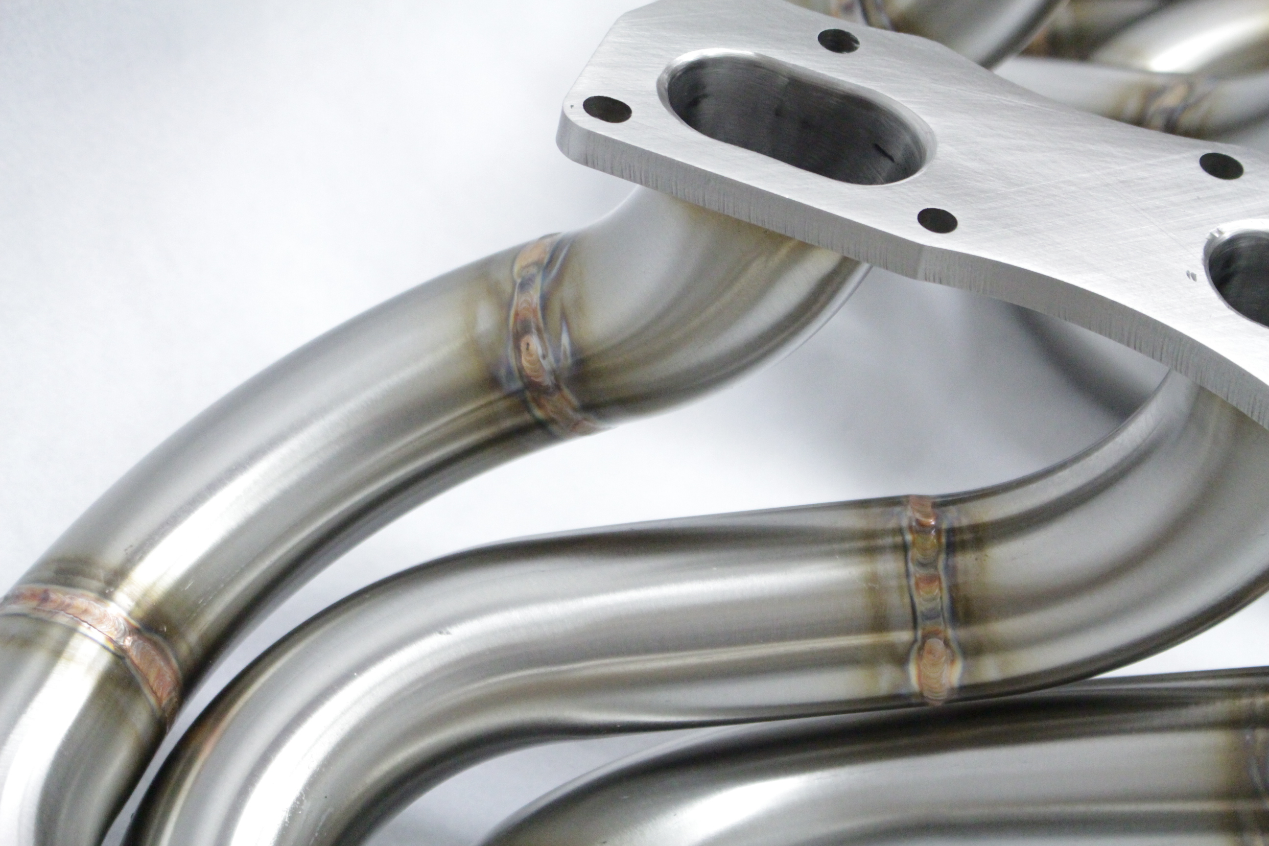

Not resting on our laurels, we looked outside of the box and began designing a motorsport-focused, catless, equal-length long tube race header together with our partners at Ardent Performance Exhaust. By eliminating the catalyst and utilizing all available space underneath the car, we were able to build a header with much longer primary tubes and and longer collector than stock, and the crown jewel of the EVR450 kit was born. After careful tuning, this substantial design departure from the stock manifolds generated very large gains throughout the powerband, completely eliminating torque dips at 3700 and 4700rpm and giving the EVR450 kit peak gains of more than 50hp over a stock GT4 and 20-25hp more than the EVR425 kit. At no point beyond 3000rpm is power lost compared to the stock manifolds, and engine response and power at low RPM as at least as strong as a stock car. The greatest increase occurs at 4700rpm, where dyno testing shows the car gaining a MASSIVE 58lb-ft and 51hp at the ground compared to stock, completely transforming the performance where it is needed to launch the car out of 2nd and 3rd gear corners.

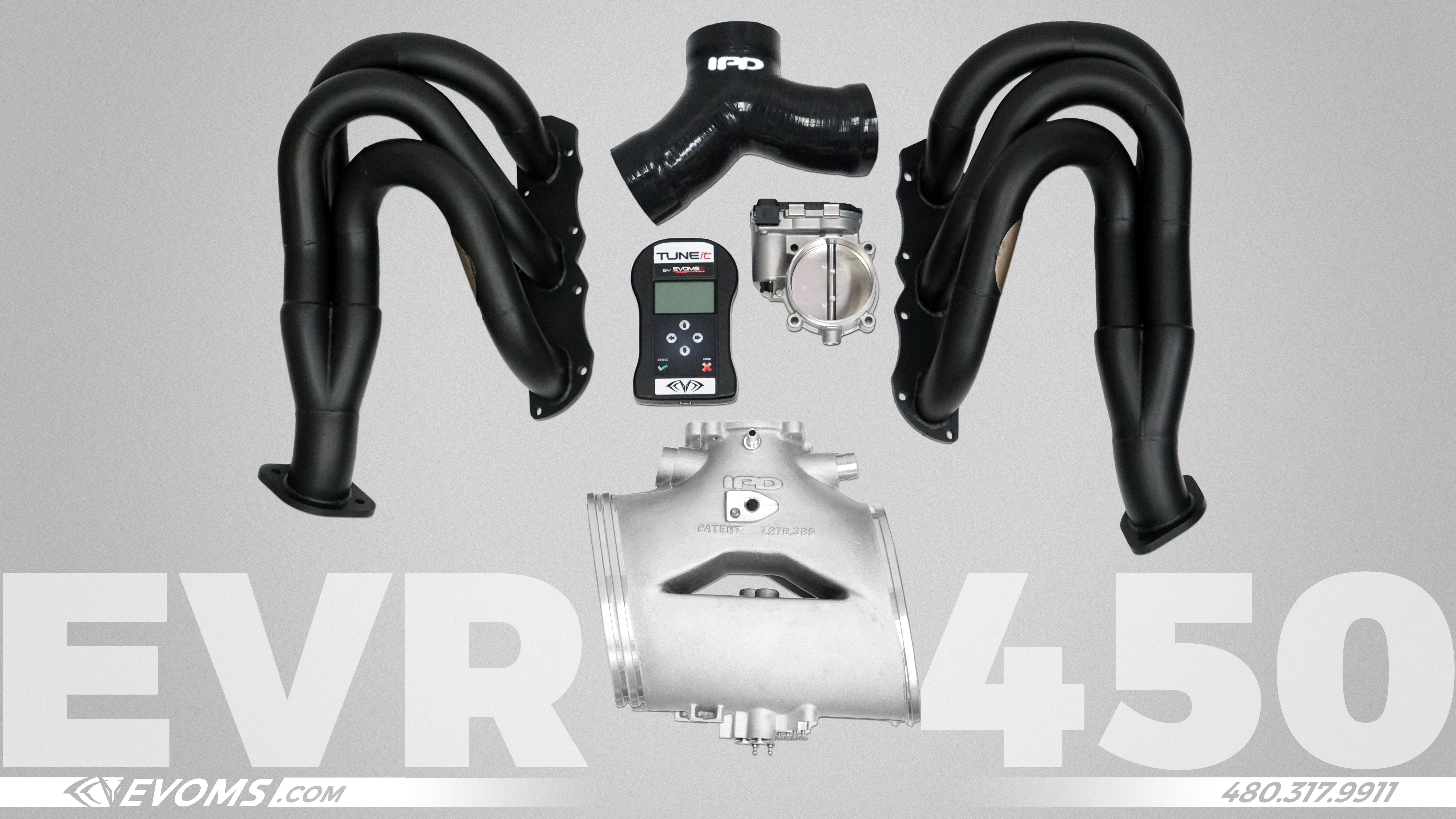

Along with the Ardent Performance long tube race headers, IPD Competition Plenum, and 82mm throttle body, EVOMSit software was developed specifically for the EVR450 hardware to ensure the total package achieves maximum power and crisp throttle response at all engine speeds. Installed over the OBDII port using the included TUNEit Gen 2 flash tool, this software also guarantees no check engine lights will be present due to the modifications. Software is available in 91, 93, and 100 octane (95, 98, and 102 RON) variants, and incorporates Intelligent Tuning's Integrated Switching Technology to safely and automatically adapt ignition timing to deliver the most safe performance for your fuel and conditions. Options such as left foot braking and a raised rev limit are available upon request.
Kit Includes:
EVOMSit EVT450 ECU Software
EVOMSit TUNEit Gen 2 OBDII Flash Tool
OE 82mm Throttle Body
Ardent Performance Long Tube Race Headers
Recommend install time 5hr
