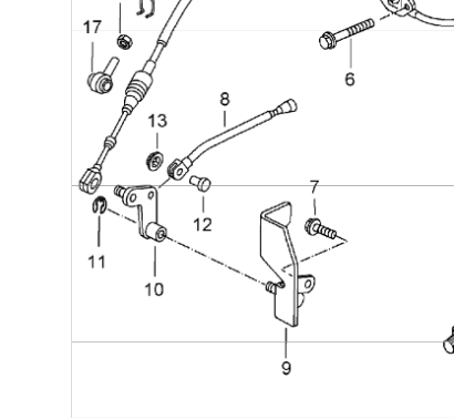

UPDATE: It was the plastic end of this rod.
Shift Push Rod
Part #: 986-426-043-01-OEM
2002 Porsche Boxster S Tiptronic will not start - CHECK THE TIPTRONIC SHIFT PUSH ROD SELECTOR - IT IS PLASTIC AND GETS BRITTLE AND EXPLODES.
The car is stuck in whatever gear you got stuck in.
If you think its the starter relay - wrong - it starts with jumped relay in gear if you left it in gear.
If you think its the immobilzer - thats a racket.
I replaced starter motor, alternator, ignition, relays - and it still would not start.
REASON: The plastic Tiptronic gear selector failed at 20 years.
If its this symptom - wont start. Everything everyone ever said did not work. Then ...
its this piece t the back of the car - you can change the gears with your hand into neutral and car runs perfectly. Just cant change gear but $23 fix easy.

Trying to remove old part - any idea how to remove this push on retainer on the end of the gear shift rod? Dont want to break things.
Ideas? Tools?
Old Jan 3, 2021 | 10:58 AM
jg_atl's Avatar
Joined: Dec 2015
Posts: 152
From: Western NC
jg_atl is infamous around these parts
Use a small screwdriver or needle nose pliers and pry the tabs up until the retainer comes loose. Once it is off, use needle nose pliers to bend them back down so that when you reinstall, they will grab. From the parts diagram it looks like you could replace it with a circlip too.

Awesome - yes I ordered a needle nose sharp plier and a sharp screwdriver - Ill replace with 1/4 inch circlip for easier removal again. The plastic ball came off easy so should be a straight replacement with new part and done.
