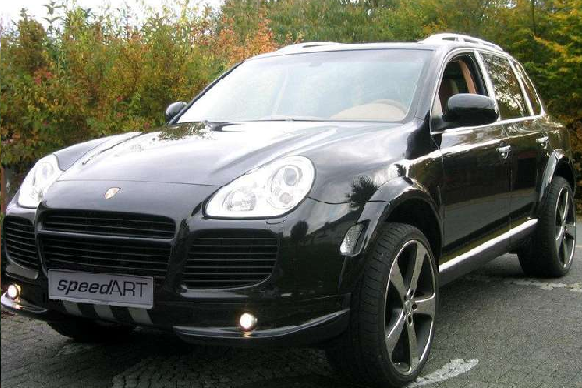

I have an S which I am upgrading and have purchased a SpeedArt body kit w/ 22x10 et 60 wheels. Can anyone tell me the spacers I will need to fill the wells properly?

How wide are the fender flares??? I have 22 x 10's on my Cayenne S right now (stock body) so perhaps knowing how "flared" your truck will be would help with knowing how far to push out the wheels.

I have attached a picture from their website, which is the exact same kit & wheels that I have. You will note that the truck needs to be lowered badly! That's why I purchased a TechArt module.
I have never contacted SpeedArt directly - however, if need be I am sure they'll know the spacers required.. The only problem is that they are in Germany.

probably at least 30mm spacers. Would have been better to go with HRE's and a custom offset, that's a huge spacer.
22 x 10 et50 fits perfectly flush with the outer fender line.
22 x 10 et60 will be 10mm in-facing
so call it 10mm + the flare, maybe 35-50mm?
35mm spacer? Call or email Speedart.
