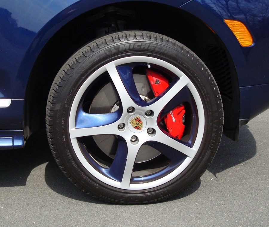

No one makes a good 20" winter tire.
I use a separate set of 18's for my winter driving.
And I have a third set of 18's coming for off-road summer driving.
Why buy a performance car and hobble it will compromised tires?

All seasons are not recommended, especially for a Turbo S Cayenne.
As someone stated to me when discussing the topic, "An all season tire is simply a compromise. It's not a good winter tire, and it's not a good summer tire. There is not a driving condition in which this tire is properly suited."
I have to agree, as I've driven Cayennes on all 3 types of tires. The best choice is: 2 sets= winter / summer.

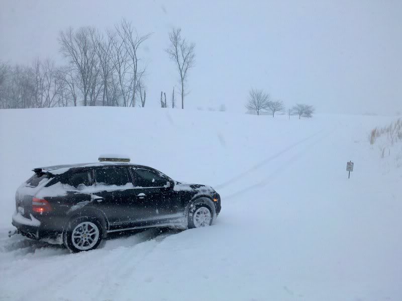

When it snows, I SLOW DOWN ! ! ! I never crowd anybody on the road during a snowstorm. In fact, often I need to dodge idiots who drive faster than their tires can handle. I do not talk on my cell phone and always plan ahead so I can avoid the cars spinning out of control. If you are in the left lane and the road is straight, you can go fast. If you approach a curve in the road, you need to know what your tires and vehicle can handle. Slow down if needed. Careful driving during a snowstorm allows the time and room for me to avoid the people driving too fast for the conditions. If you hit ice going too fast in a curve, no tires will save you.
Yes winter tires perform better on snow and ice, but all-season tires do perform better on the dry roads. Since it does not snow every day, and 95% of the time, the roads I use to get to and from work are dry in the winter, not only is my choice of all-season tires more convenient and less expensive, it is the better performing choice for 95% of my winter driving.
On the days I need to drive on our side streets through deeper snow, my all-season tires have no trouble getting me safely to my destination. If I needed to drive faster on snow and ice, I would have to buy an expensive set of winter tires and wheels. Since I don't, I won't. The thread starter asked for all-season tire recommendations. Mine do the job just fine and when the winter roads are plowed, sanded, salted, and dry, my all-season tires perform better than winter tires.

This week, we got a huge dumping of snow after a week of temps well above 32. In fact, it was often > 40F! So, the roads were SLICK. We had 186 accidents reported during that day in 8 hours.
Unfortunately, I had a medical appointment and then a dental emergency which placed me on the road at the beginning of the snow storm and the end (during rush hour). However, I did not even venture out for my evening class at APD across town for OEC EMT 1 training.
