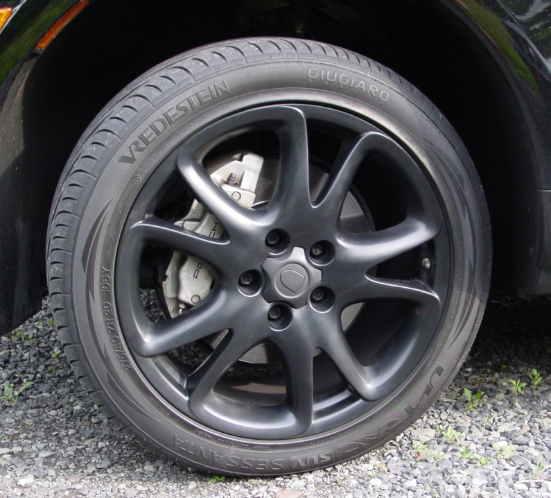

I had a stock set of 20 inch wheels powder coated about 12,000 miles ago. They are holding up well. The process involves removing the tire and sensor, sand / bead blasting the surface down to bare metal, apply the finish, and baking. In my case I had the shop apply a satin clear coat on top of the powder coat because the powder coat process yields a gloss finish. I independently painted the center caps flat black (you can’t powder coat plastic). I was going to top coat the center caps with a satin clear coat but, although there is a noticeable sheen difference in the picture, you don’t really notice the difference from 10 feet away, especially after the wheels get a fine coating of brake dust.
I’m on my second set of tires with these wheels having replaced the original Pirelli Scorpion Ice and Snows with the Vredesteins. Both the Pirellis and the Vredesteins were balanced after mounting using a Hunter GSP 9700 High Speed Balance machine. I’ve had no issues and would happily do the same again.
