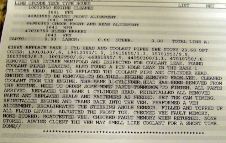

A couple days ago the display showed a "coolant low" message. I noticed the reservoir was completely empty. I filled it up with distilled water (3/4 gallon) and went on my way. When I got home I noticed there was a trail of drops. I brought the car into the dealer and they found 2 leaks. 1 was from one of the hoses, and the other is from a pin sized hole in one of the heads. It'll take a week to fix and is covered under warranty. I am so glad I went CPO!
What's odd is this started just a couple weeks after I had scheduled maintenance done.

$0 later and it's back! The tech estimated it would have cost me $9k. Here is what they did.
