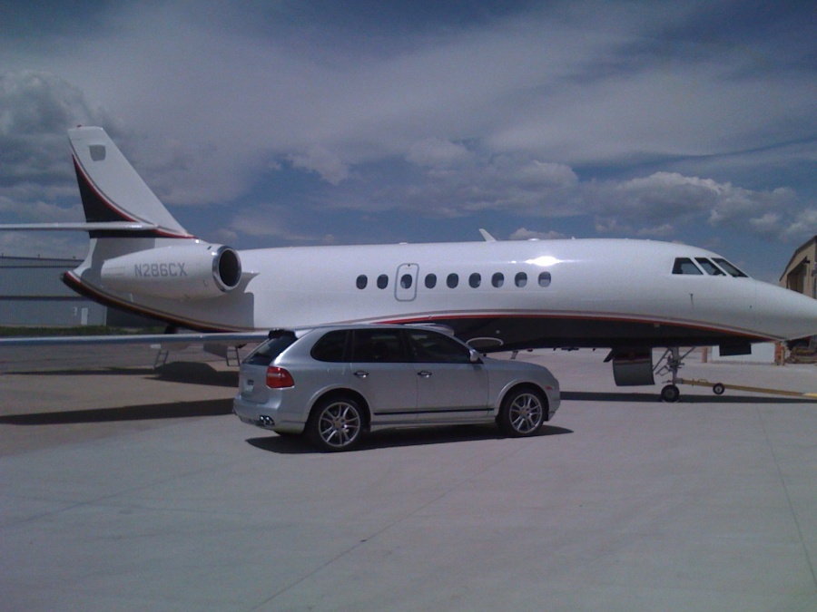

know quite a bit about the detailing buisness, although one of my companies does more of the private jets than the autos.... but either way, here is a pic of one of my mode of transportation, with another more of transportation behind it.

Jaace very nice picture. What do you know about detailing anyway

To have someone just wax the exterior, depending on the market you are in, a normal job, without clay or the extensive methods most of us use on this board, but normal job is about $300.00.
I have seen them as expensive as $1,000.00-$2,000.00 depending on the car and methods used.
when my company does the car attached obviously that job is more around the $600.00 mark.
not much, novice <<<<<<<<<<<<<
