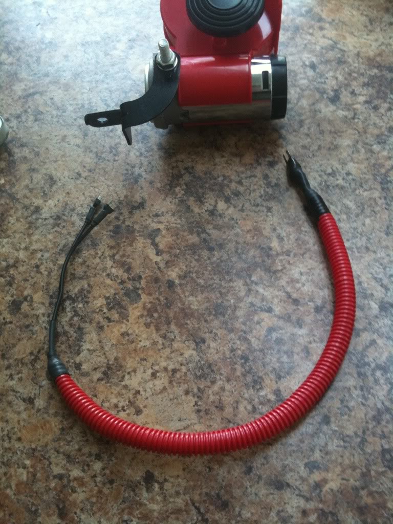

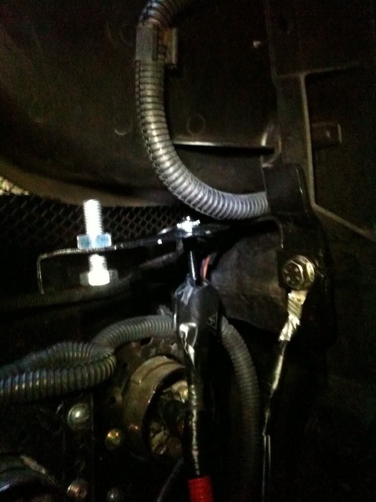

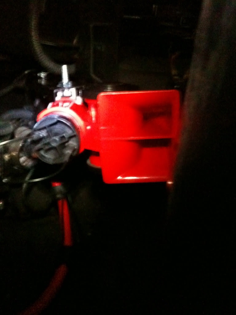

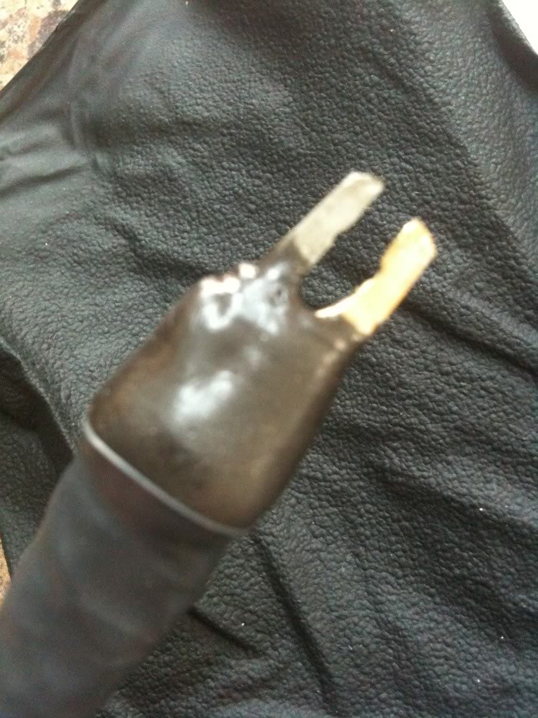

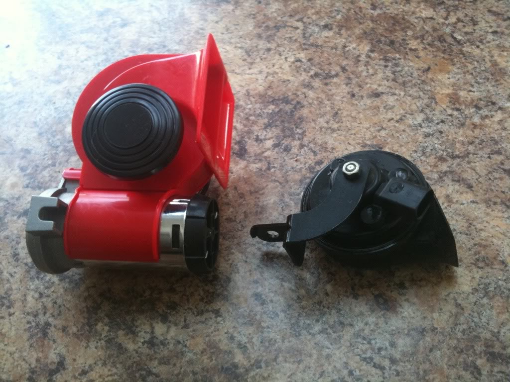

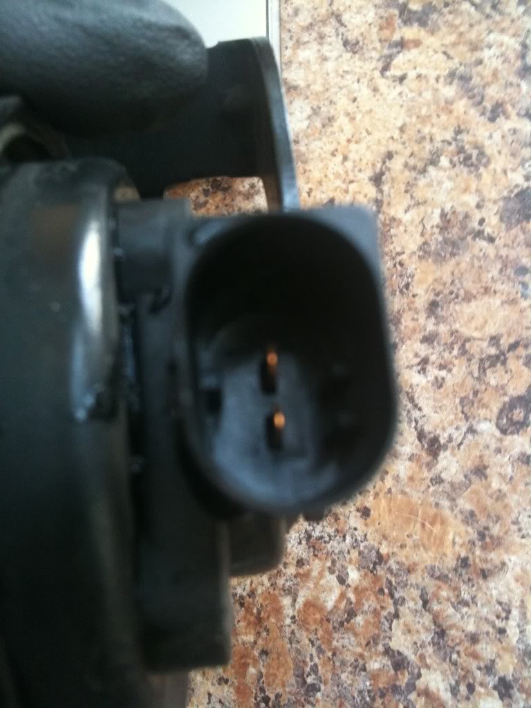

There are 2 - I replaced mine with a manly airhorn, but I have not created a tutorial yet ;( They are located in the fenders. You just need to park with your front wheels (one at a time) pointed inward. You then remove the 5-6 torque screws (I think its a 6mm) that hold the plastic inner fender on. Remove the screws right up to the side marker light. Then pull back the plastic fender well. I held mine in place with some string tied through one of the plastic wells holes and looped through my front rim. Shine a flashlight in the well and you will see the horn. There is one on each side and you only need a socket to get them out.
Here are some pics of my change over to the really nice and loud compact airhorn:
(On mine I reused the stock bracket and made my own harness so that I did not have to cut anything)
