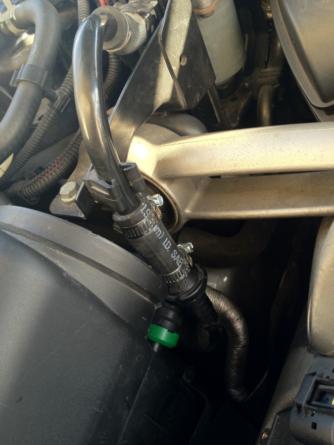

Same here
Got the same error code, vacuum plastic line is like 135. I did a fix for like 6 bucks.
Ya what size of tubing did you use ?
