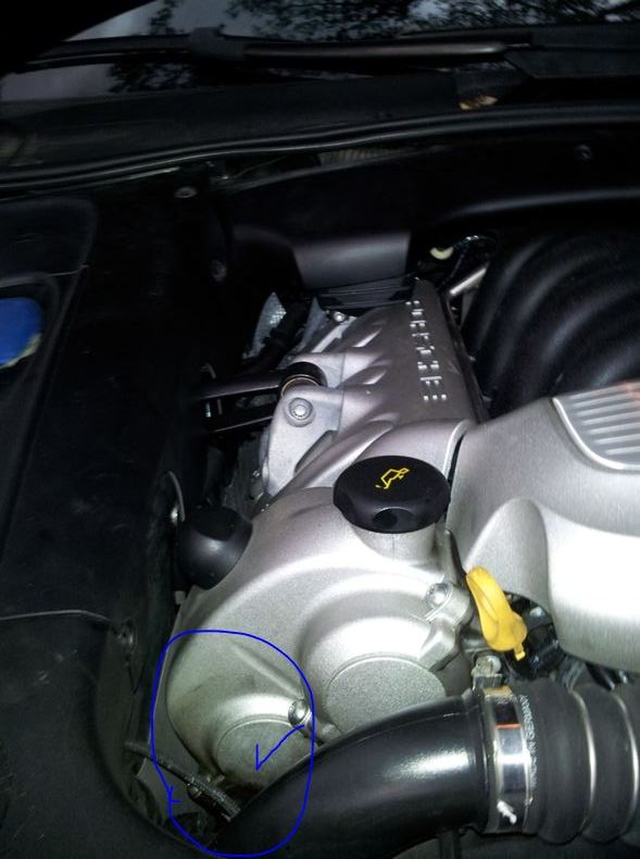

- In left side of engine valve cover (closest to front of car), noticed a possible oil leak (ran fingers through area and picked up black dirt, kind of moist. It was oil. How expensive is that to fix? DIY? No?

You ARE taking this to a mechanic for a PPI right? Ask him all those questions. Interwebz guesses are worth exactly what you paid for them. A cheap used Cayenne can be the most expensive car you've ever bought.

The engine leak bothered me most. Seats bother me, the liner bothers me. Not that I could not fix liners easily, just dont feel like I want to bother.

here is a pic of the trouble area inside the engine on the ctt I looked at. The dealer said it was just dust but when you touch it, it is moist, dark black and smelled of oil residue. lol.. anyway, this car was not chosen.
Was I right about it being a valve cover? or is this something that may be more serious? Want to know in case my car starts showing something like that (I saw 2 ctts with similar spots on the engine and wonder if this is typical of the car)
