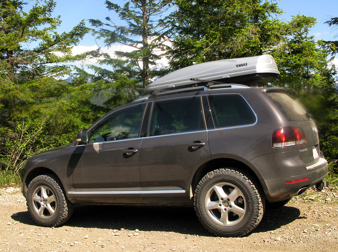

and when I had the v10 Touareg, I used the BFG in the Cayenne size 265/65x18 and it was a perfect fit.

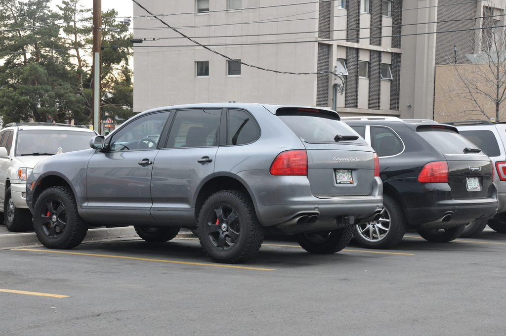

265/65/18 BFG AT
Since nobody else seemed to actually try this on a Cayenne I figured I would dive in now that my winter tires needed replaced!
They are tight when turning, but clear at the normal height setting. Just graze the fender liner on the turbo at the low setting(turning, clear fine straight)
The contact on the low setting is literally just a super light dusting type contact. It would also be very early to just trim out the fender liner for an even bigger tire.

How do you find the ride quality?

Rides nice!

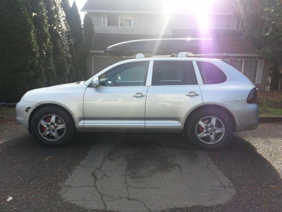

Finally getting around to posting some pics. It took me awhile to find some 18's and TPMS, but it was worth the wait, as I am pretty happy with the new stance and the improved ride quality due to the extra rubber. I went with 265/65/18 Goodyear Wrangler Silent Armour, I was going to get the BFG's as that's whats on my truck and I'm pretty happy with them, but the higher speed rating and promise of less road noise made the Wranglers seem like a better fit for my Cayenne. I definitely like the look of the wheel well filled up, but I have also definitely noticed a reduction in quickness.
[IMG][/IMG]

Still lovin' them! Gives the CTT a nice aggressive SUVness that it needed.
Next to a stock steel spring S on 255s
those are the best looking 18 inch wheels i have ever seen
