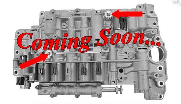

I'm on the way to change valve body. I want to order it, but they said to me that they are two versions with or without 2 pressure switches (sensors).
I there any option to know this without opening the transmission?
I really don't want to be without car 14 days because of that.
I attach picture to know about what I'm talking.

Your 2004 Cayenne S has the two hydraulic pressure switches fitted on the transmission valve body.
From the PET parts list, the part number of the valve body you require is 955.325.03910.
(955.325.03900 is for turbo Cayenne)
www.sonnenporscheoemparts.com has your part for USD $1015.
