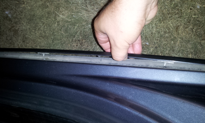

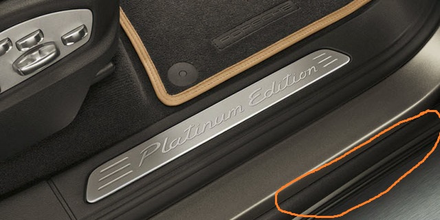

The trim strips are located on on lower part of each door entry, and the door closes onto the trim pieces themselves. Sometimes, when exiting the car, your foot can catch the edge of a trim strip, causing a clip underneath to break, loosening the strip. After a few clips are damages, the strip is very loose and you may need to replace all clips to repair this.
Attached pics show which trim strips these are (total 4 on the car - 1 per door).

Name:	Trim strip that comes loose pic.jpg
ID:	336543   Click image for larger version
Name:	Trim strip with clips underneath.jpg
