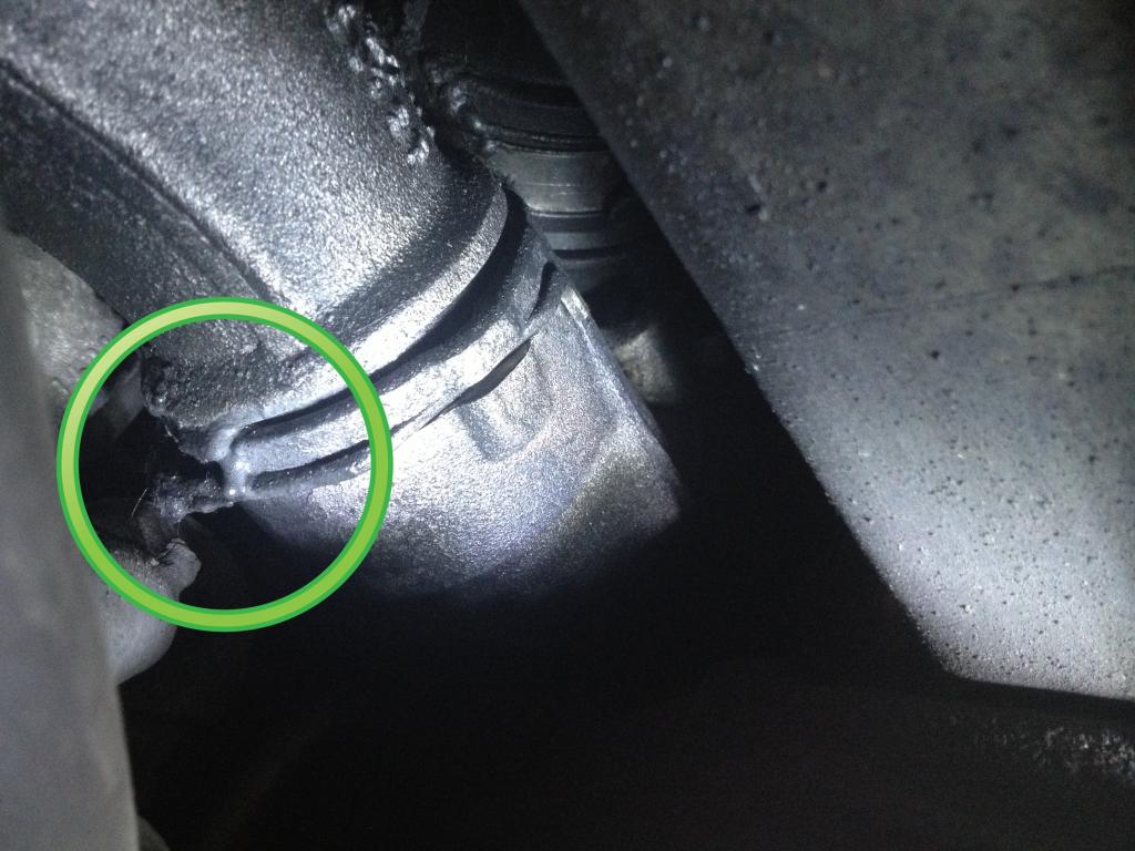

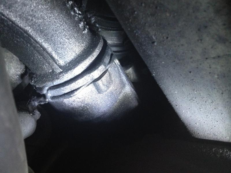

I haven't done another data log yet, but I do know that there are no boost leaks detected.
I contacted the tuner to see if he could make any recommendations and he suggested I unplug the battery overnight. I assume that's to clear the long term fuel trims but maybe there's more to it than that. While it was disconeected, I decided to change out my driver side charge pipe gasket due to significant oil residue in that area.
I found a good amount of gray metallic liquid in, and dripping from, the charge pipe, strongly pointing to my driver's turbo compressor wheel rubbing the housing...looks like a new turbo may be inevitable.

Wow...That grey metallic liquid, which I am theorizing is metal infused oil, is really concerning. Unfortunately, I do not think you are not too far off with your internal damage conjecture.
What are your next steps?

Push it into a lake...JK!
I've done some research on turbo rebuilds and IIRC my turbos are IHI RHF5. Won't be attempting this myself due to the engine (and likely the trans) to be dropped for the swap. I've been quoted 14hrs of labor, so if I'm going to do it, I may get both turbos rebuilt and possible go with a slightly larger compressor wheel.

That's a bummer man. You'll want to do a compression test as well for sure. Those metal flakes from the turbos are torture on the cylinder walls.

Oil on the drivers side is normal, thats where the crankcase ventilation go's to. If you really think its silvery I would investigate further.
Here's the thing. Your CTT has an IHI RHF5. It's a tiny turbo and only rated for 208 hp. In stock form the 4.5 is using up every bit of the turbo map. Both my turbine housings were severly cracked internally radiating from the wastegate flapper. I never would have guessed. Word has it that the IHI turbine housing is made from crappy metal, I dunno.

It's definitley silver, not just oil...I've done some searching on the RHF5 and I'm considering just rebuilding plus machining with 60mm billet compressor. Cost is $1,550 for both turbos from http://midwestturboconnection.com. I've read estimated flow increase of 15% for this setup. What did you decide to do for your turbo replacement? Thanks for the insight!
