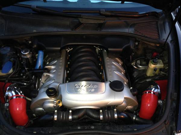

I finally got around to completing piecing together and installing my intake modification for my 05 Turbo.. Just curious if anyone else has similar experience.
1) Massive induction noise increase at part throttle/low rpm. Lot of spooling sound, I can hear it over the radio at low speeds. Its MUCH louder than I thought it would be. I think it sounds quite nice to be honest
2) Similarly loud increase in noise from the diverter valves. It sounds similar to past cars Ive owned with vent to atmosphere blow off valves. Its audible from outside of the car as well. Definitely did not expect to have these sounds coming from the Cayenne!
3) Part throttle response and spool up is much better. It feels like the midrange has gained a lot of power/torque. Worth it just for these gains alone.
4) I don't really feel much difference in top end/high rpm power at all...
Anyone else have any impressions?
The little to no gain in high rpm is leading me to believe that there is another bottleneck in the system somewhere that is reaching max cfm somewhere in the midrange rpms. Maybe the intake manifold/throttle body, maybe the factory 955 intercoolers or the piping...

Yeah I built my own intake system from the MAFs forward. I think my next step in the intake path is going to be moving from the intake side of the turbo piping to the intercoolers then up to the TB/intake manifold.. Just not sure where I want to begin or what path to take. Actually, I may go for primary downpipes the more I think about it. So many things I'd like to do.

I made one. Incredibly easy to piece together. Took some measurements, ordered a few parts from Amazon, did some more measuring and trimming/cutting.. I spent less than 2 hours total time and saved a good bit. The most expensive part was the filters.

Ive been off the forums a bit lately, but I've still got them in the car and its doing great. Probably my favorite modification.
What kind of questions do you guys have and what specific photos do you want?
I only have this low-res photo on my work computer, but I can get specifics with better quality if needed.

Seattle,
thanks for the picture, looks great - the questions we have is you mentioned you'd do a write up and we were waiting for that: what did you order, types, bends, which filter and size, what was the last minute change.
The basics of a DIY intake. I intend to do one as well however this is my daily driver but maybe this weekend I'll take it apart to get an idea of what to order and such.

My last minute change was I used a larger filter, about twice the size as most intakes (more filter area = more cfm) and I wanted to make sure it would fit. I did make it fit, but it was probably a lot of effort for minimal gains, if any. I'm also working on ducting cold air into the filter area, but I haven't really done much with this yet other than measure and brain storm.
Im going to give this a quick write up to get everyone that is interested in doing this started, I can follow up with more clarification if anyone needs it. I take no liability for any damage or harm you cause by following the path that works for me, everyone's experience may vary. I'm away from the car until the weekend so pics will have to wait, but I will add them later.
Parts (I have linked to what I purchased, I am not affiliated with or receive any endorsement from any of these manufacturers or companies, this is simply what I used in my project)::::
-2 quantity 90 degree silicone reducer elbows (
Amazon.com: Upgr8 Universal 4-Ply High Performance 90 Degree Elbow Reducer Coupler Silicone Hose (3.0"(76MM) to 4.0"(102MM), Black): Automotive Amazon.com: Upgr8 Universal 4-Ply High Performance 90 Degree Elbow Reducer Coupler Silicone Hose (3.0"(76MM) to 4.0"(102MM), Black): Automotive
-2 quantity 90 degree 4" aluminum mandrel bends (
Amazon.com: Spectre Performance 9799 4" 90 Degree Mandrel Intake Tube: Automotive Amazon.com: Spectre Performance 9799 4" 90 Degree Mandrel Intake Tube: Automotive
-2 quantity air filters (http://smile.amazon.com/gp/product/B...ilpage_o09_s00 ) ****NOTE ABOUT THIS FILTER; this is the one I used. This larger filter does not fit easily. I had to cut the aluminum bend short to make this fit, and it still barely fit; It will make the project much simpler to use a filter size similar to the other intakes on the market especially since Im not sure that the larger/higher cfm filter even makes a difference. The bottleneck is further down in the intake system after the MAF.. http://smile.amazon.com/Spectre-Perf...let+air+filter I did a quick search and found this one that will *probably* fit much easier, but I can't guarantee it since I did not use it. This second filter is 6.7" length compared to 11.4" for the one I used; When I was testing my setup before using the larger filters, I just used a pair of mismatched random 4" inlet air filters I had in my garage left over from other cars)
-You will need 4 hose clamps (I used T-bolt clamps because that's what I had in my garage)
-You may elect to install a breather filter on the line going to the air suspension. I ziptied it up and out of the way and have had no negative effects.
-You may want to fabricate a heat shield; I did not. I worked on a design to add a carbon heat shield to mine and measured temperatures at the air filter with and without a heat shield under various driving conditions, and there wasn't enough difference (less than 1 degree at the filter) to make it worthwhile for me. I think the best difference in reducing intake temperature will be when I finish my cold air ducting.
Tools needed:
I need to check on this and get back with you guys, I will update it once I look it over. It wasn't anything out of the ordinary and you will probably already have it in your garage if you have been wrenching on your Cayenne before.
Installation:
***Im going to assume that if you are piecing together your own intake, you are somewhat mechanically inclined, so I may leave out some steps that are obvious since I'm not walking this through bolt by bolt, again anything you do is at your own risk and I'm going to touch on the overall procedure and what I remember the trouble points to be***
First thing you want to do is remove all of the factory stuff (obviously).
Start with the airbox and work towards the turbo; I don't remember the airbox being too difficult, but removing the headlights make it much easier to do. The passenger side airbox has the connection for the air suspension, its a kind of tricky connection. There is some wrestling required to get the airbox out of the fender. If you need to be walked through bolt by bolt on removing this, follow this guide http://quvpr.powmx.servertrust.com/v...ow_Install.pdf through step 7.
After this is complete, you are going to need to remove the MAF and it's housing piece from the turbo inlet pipe (there is a small worm clamp just below the MAF connection). I found it very easy to damage this plastic pipe below the MAF, I think its brittle from the heat over the time because on one side when I pulled the MAF out the flexible section of the inlet pipe came off with it and I had to source another turbo inlet pipe. Proceed with caution.
Once the MAF is out, install the small end of the silicone reducer goes to the MAF section, then put the MAF and reducer back to the factory turbo inlets. Next you have to get that 4" aluminum bend into the 4" side of the silicone coupler. Angle the pieces to get it positioned correctly so the stock plastic cover fits back on it, then add the filter on the end.
I don't have the step by step pictures or anything like that, and like I said I'm away from the car until the weekend so pictures will have to wait until after I'm back to get specifics.
