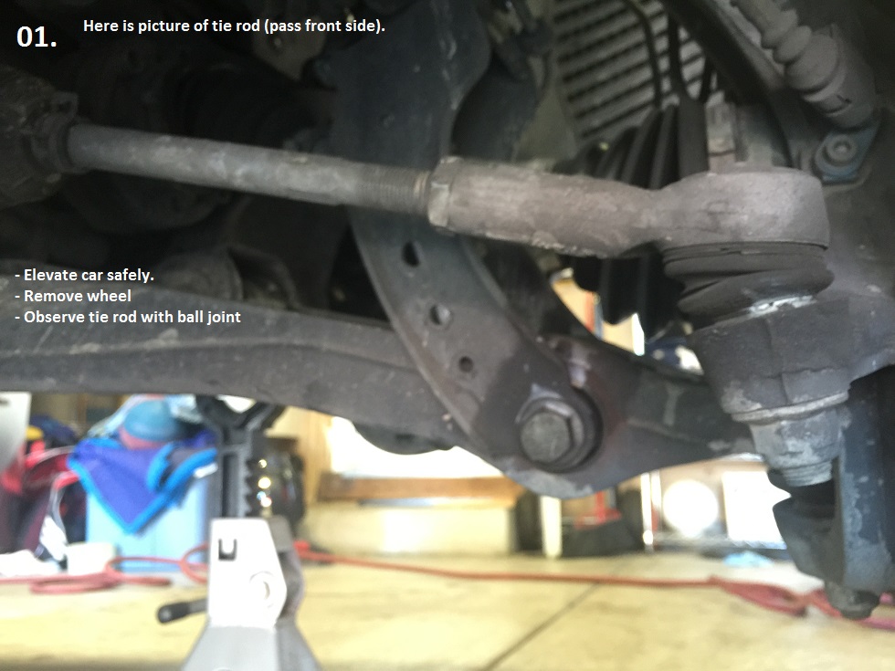

Cayenne Front Tie Rod Replacement - DIY
In the course of doing suspension refresh, I took some pics and made them into separate DIYs. Hoping it will help others in their quest to keep their rides feel like new.
Just follow the pic numbers. Instructions are imbedded into the photos.
I am sure if you have questions, just let us know and we can help resolve them.
Enjoy.

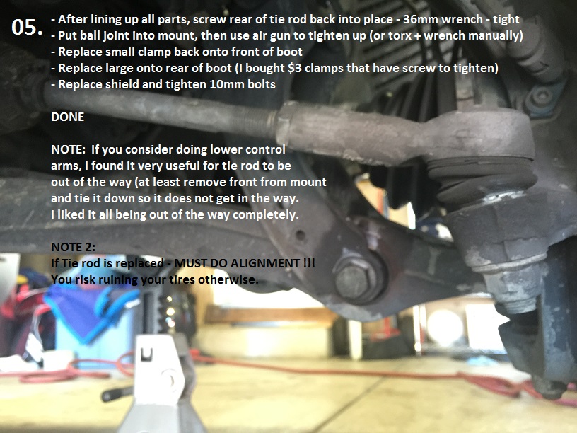

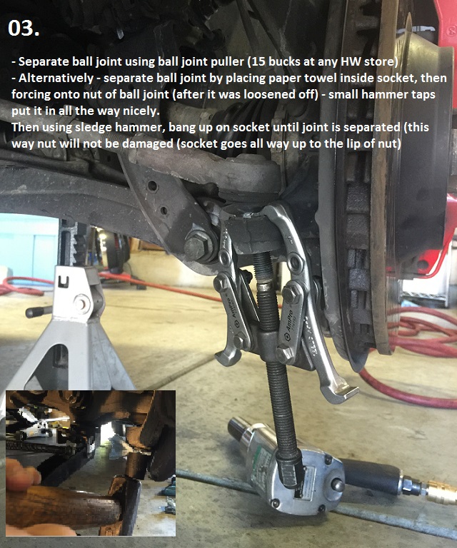

NOTES:

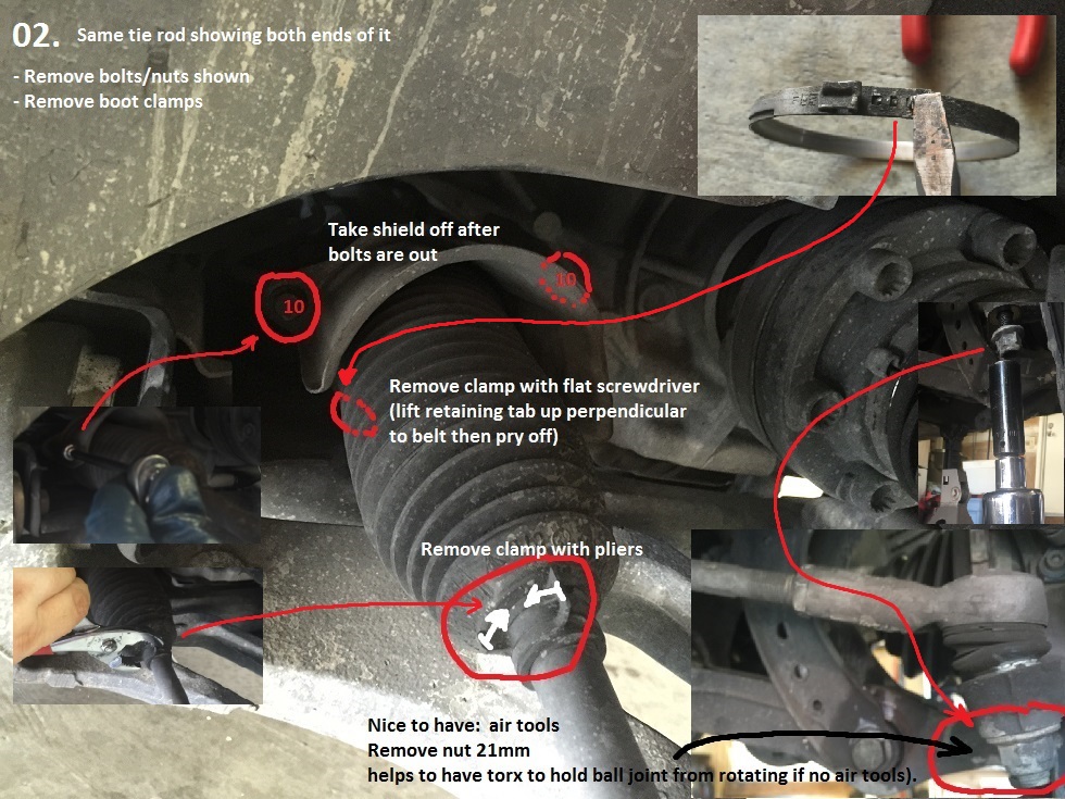

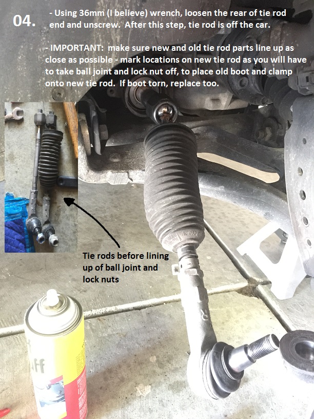

Picture #4 - Idea for tie rods is to line them up so that new rod length will be same as one you remove. That will get tweaked at alignment time, but will get you close enough to drive to alignment shop after doing the work.
Picture #2 - Front driver side tie rod does not have the metal shield on it, so its one less thing to worry about during the swap. Pic 2 shows front passenger side.
