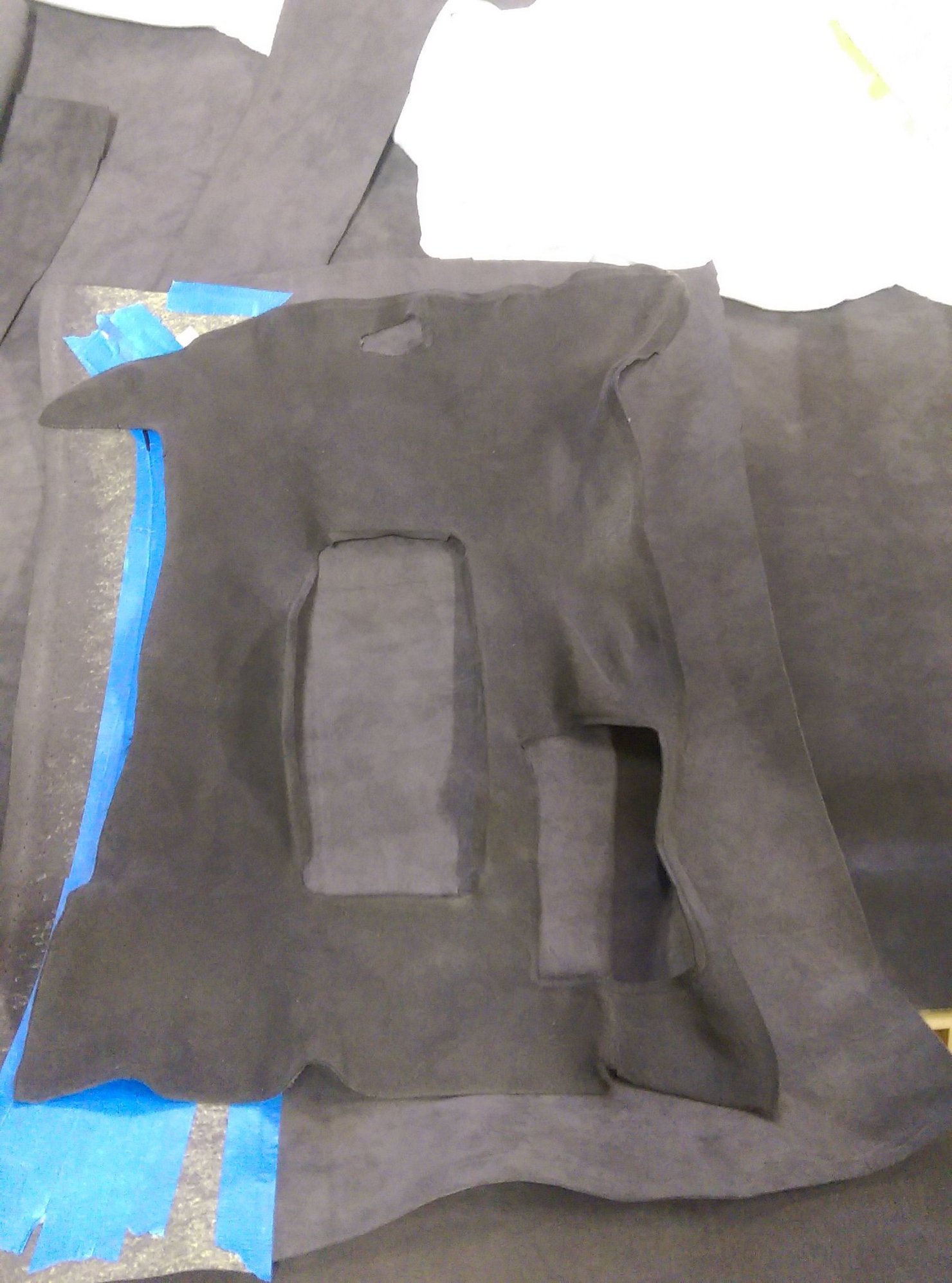

When you get to the clips that hold the headliner to the sunroof opening frame just stick a flathead in there on top of the clip in between it and the frame and give it a little twist and that clip will pop right off. There are a bunch. Otherwise if you are fighting to remove these just stop because your doing it wrong. The rest is pretty straightforward. Use the instructions in the FSM. At the top of the four door openings there are plastic clip things holding the headliner to the roof frame. You cant see them because the headliner goes into a groove in the rubber and you cant pry far enough to see them. To release, push up on the headliner at the top of the door openings and IN at the same time. they are like little hooks that hold the headliner up here. If you break these you will not be able to fix them or get new ones and your headliner will not stay up @ the door openings.
I did my headliner a while back and while it turned out really good if you are doing Alcantara it's something I would think twice about. My best advice would be to procure the fabric, the foam, the glue, and remove and prep the shell, then take it all to a professional that you are SURE can do it and walk away. This still leaves you with visors, a sunroof panel, and a,b,c pillars that will possibly be dingy compared.
If you say you have some idea on how to fix what you have and your not going to do all that the I say its not possible to have a fix that is astheticly pleasing and functional without a complete redo.
I ended up doing my a,b,c pillars as well and cleaning the visors. The sunroof itself was good and got a light cleaning. What sucks is that the B pillars usually look the worst and get so much dirt on them and the fabric gets all ragged out but this pillar is hard to do because you must first dissasemble the vent and seat belt trim. Then the Alcantara fabric has a seam in it that must be sewn. I made patterns from my old Fabric.
I also covered my vents in carbon look vinyl....that gooey black mess had to go!
