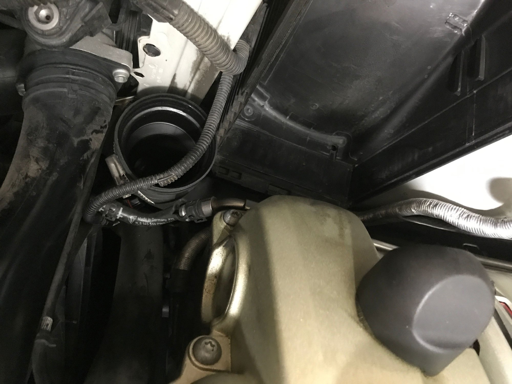

Hi guys,
I was installing a custom Cold Air Intake and came across this hose that seems to be some kind of pressure hose that connects to the intake side. It appears to be broken so I need to replace it. Can somebody tell me what part number this is? The hose on the side has markings 7L5 145 555 PWO but I can't find anything with that P/N.
Thanks for any help Identifying the p/n for this hose!

I believe it is where the air suspension compressor draws fresh air for filling up the tank. Wrap it good with tape and zip tie both ends...
