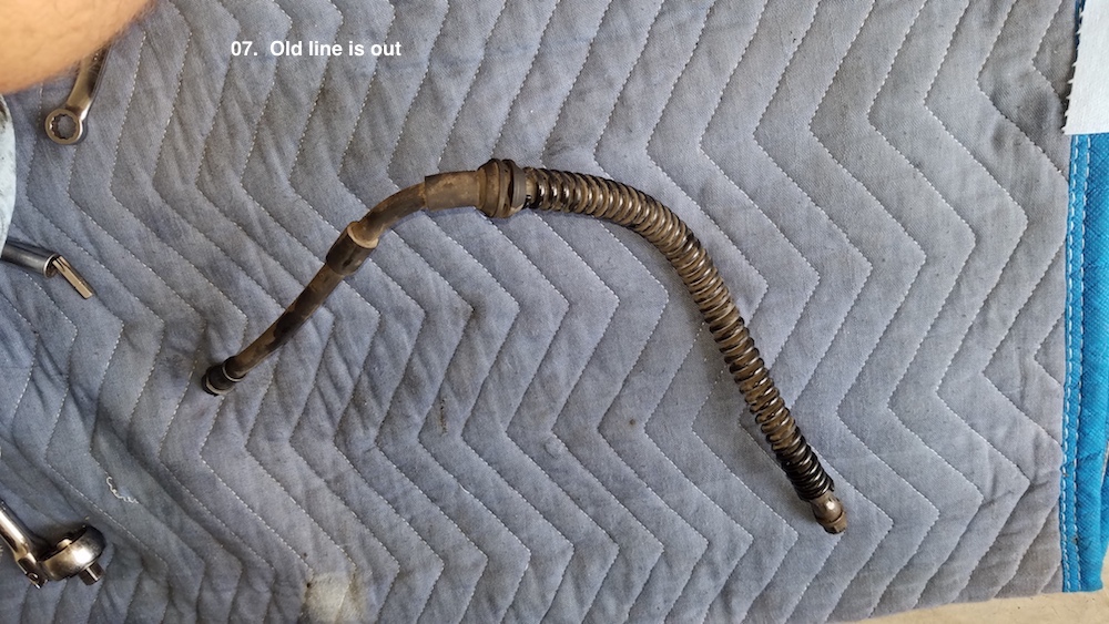

Only option then wass to replace brake lines.

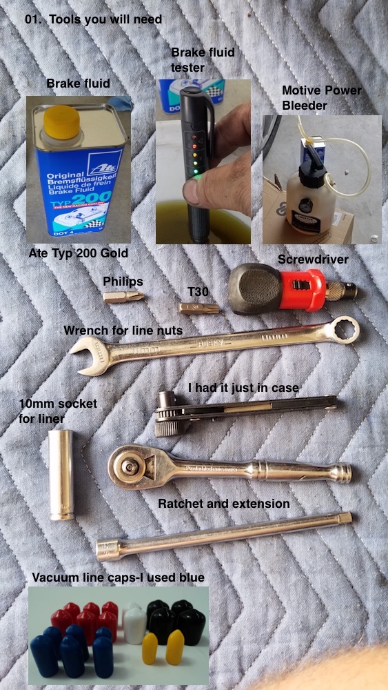

Ordered from ECS tuning for a great price of $55 per front (2 lines!). Braded steel lines, red color matching calipers.
Easy DIY, take your time, follow bleeding/flushing instructions exactly, and you will be fine.

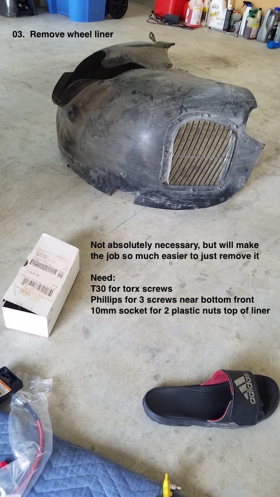

Each new line has a metal notch on end of the connection. That notch goes through a cutout on the line connection bracket on the car. Make sure you match them together so you can have full and secure connection.
The DIY uses vacuum line caps (I used blue, not sure of size). Got off eBay for $5 shipped. Search for vacuum line caps and you will find them. Pic of the kit is in diy instructions. Very useful to prevent line fluid leaking after you open it (stops air from coming in and fluid from leaking all over the bottom of car).
