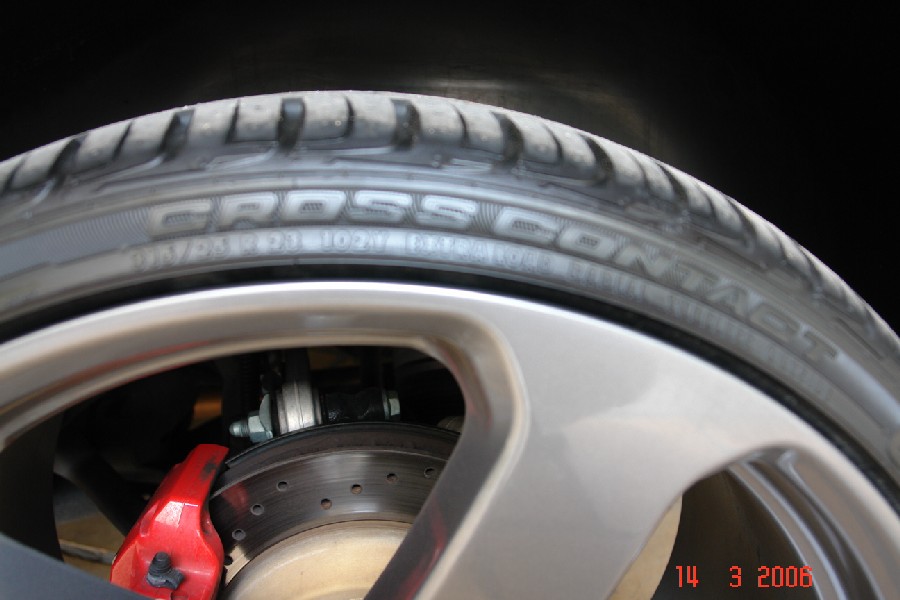

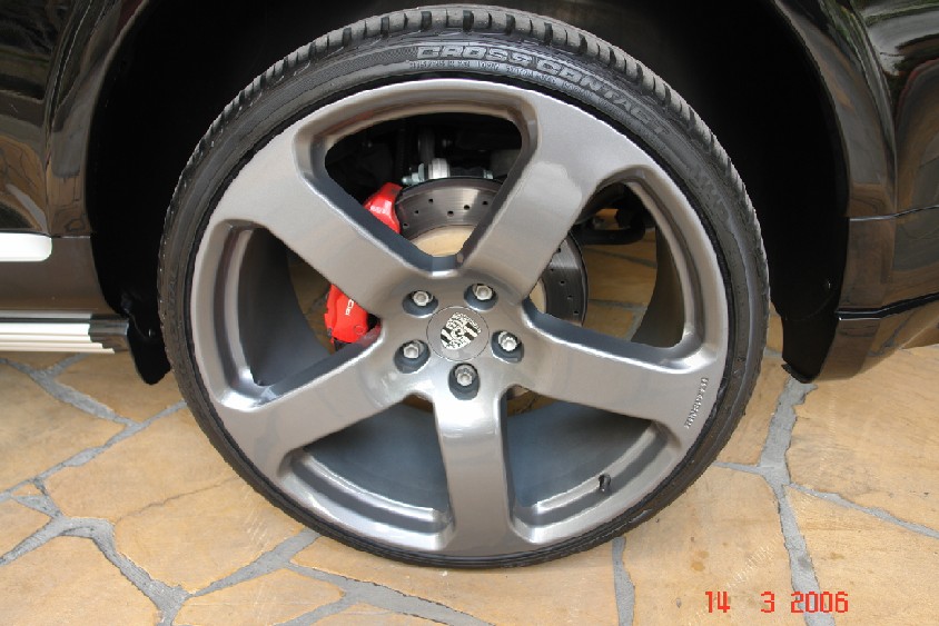

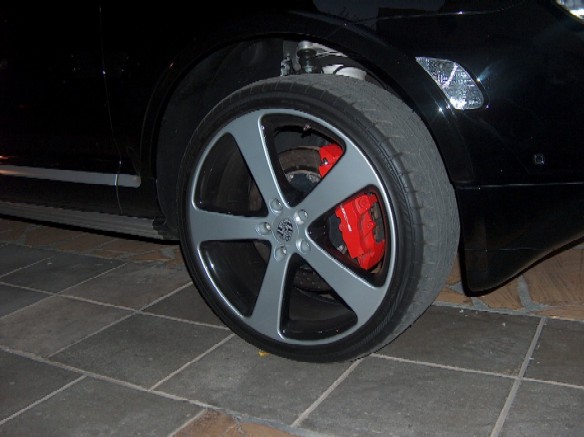

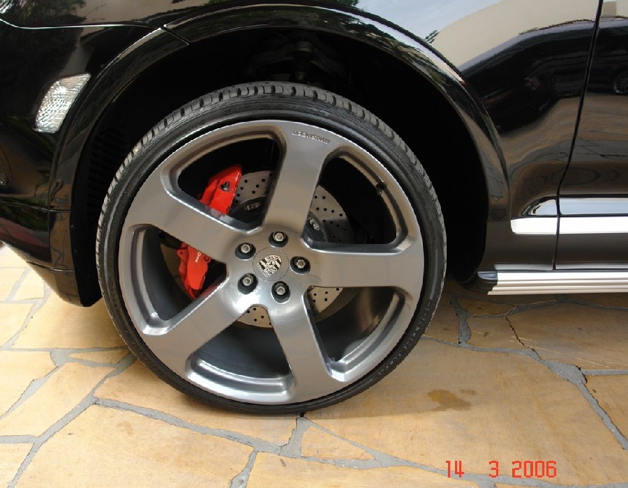

Awesome wheels, mine took a while to arrive but finally got sorted out. Thanks to Red Line Motor Group.
To Bigdog: The first one is the Gemballa 22 and the rest are the best , plus one interior shot with CF.

buzz, very nice CTT. The brakes look so small insde those 23"
