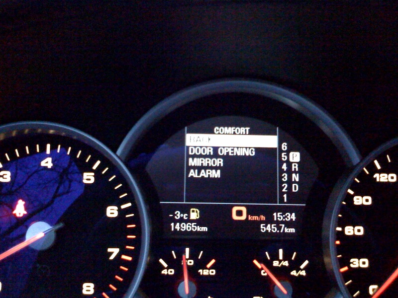

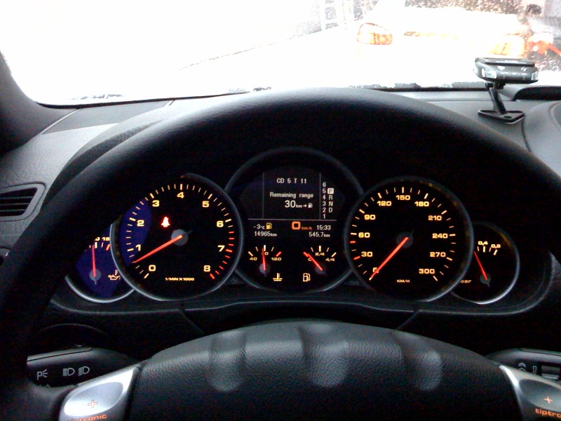

Finally i have made it
Turbo cluster on my CS '08

When we have simply connected the panel, it gave out an error "pressure of oil". The gauge of fuel showed incorrect value. And the menu "comfort" was displayed incorrectly.
Masters had to study the protocol of exchange of CAN bus to find the signals causing errors. Further they read firmware of the instrument panel, have changed some values, and write it back.
After that, cluster started to work correctly
