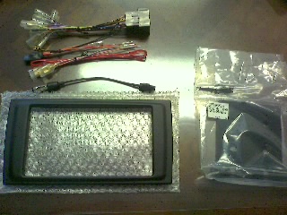

I just received this double DIN kit from japan.. The finish is exactly the same color as the stock factory dash - looks great. They also include some adapter brackets so you don't have to fab your own, as well as a harness for the factory side of the stereo.. there are a couple other wire harnesses included which I don't know about (perhaps for the Bose system).. unfortunately all of the documentation that came with this kit is in Japanese.
Overall, i'm happy.. and feel a little less pain from dropping $330 for this kit

the only part im worried about is some of the extra wires that came with the dash kit - the instructions are 100% japanese.. i'm going to have a japanese friend translate.. if all goes well i'll post up the translated instructions

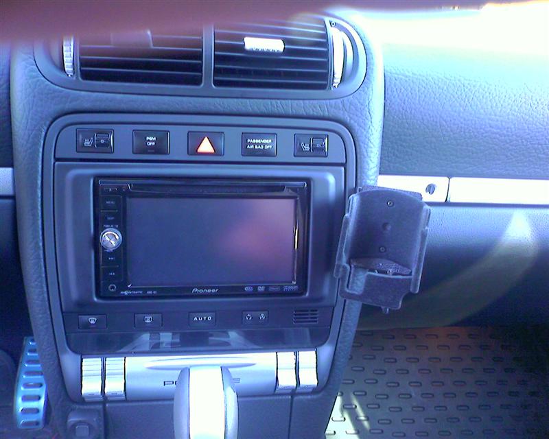

Ok, so after about 12 solid hours, the project is complete.. Avic-D3 with the XM w/ traffic nav, sirius, bluetooth, rear view cam modules. I put all of the modules behind the passenger dash (plenty of room back there), then put the sat antennas (for the nav, the xm and the sirius) under the rear trunk spoiler (i took it off, only about 8 bolts and put the antennas in there.. since its just plastic, the signal gets through OK). I put the rear view camera just above the rear lic plate.
That $350 kit from Japan turned out to be well worth it.. the brackets fit just right, the wire harness is great because now I can put it all back to stock within a matter of minutes.. and the trim piece looks like a factory finish piece.
