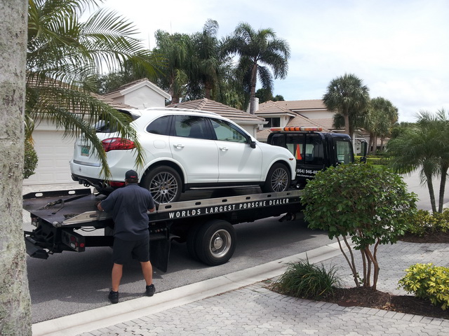

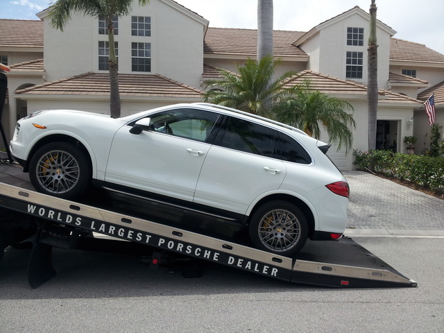

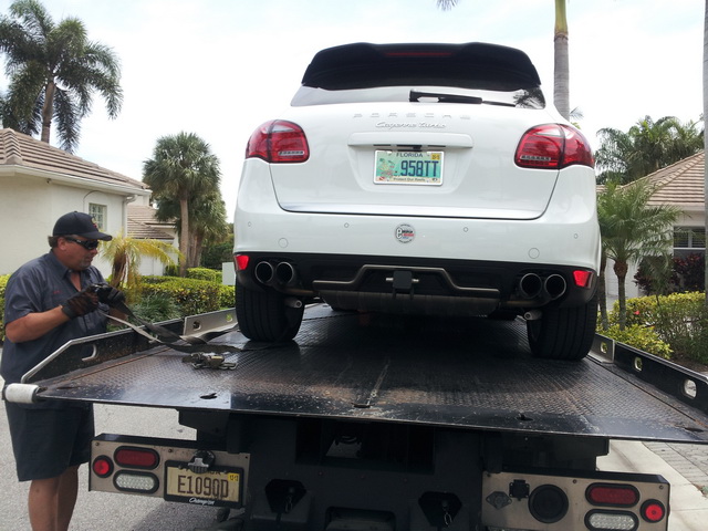

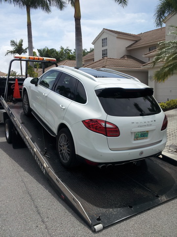

Driver started her up, backed her up out of the garage and loaded her on the truck. His thought was it sounded like a valve sticking. Everyone has their theories. We'll see.

From: Long Island, N.Y.
Rep Power: 45
Harlequin NY is a glorious beacon of lightHarlequin NY is a glorious beacon of lightHarlequin NY is a glorious beacon of lightHarlequin NY is a glorious beacon of lightHarlequin NY is a glorious beacon of lightHarlequin NY is a glorious beacon of light
Great license plate!
Great neighborhood- wow!
Thanks, Rob!
