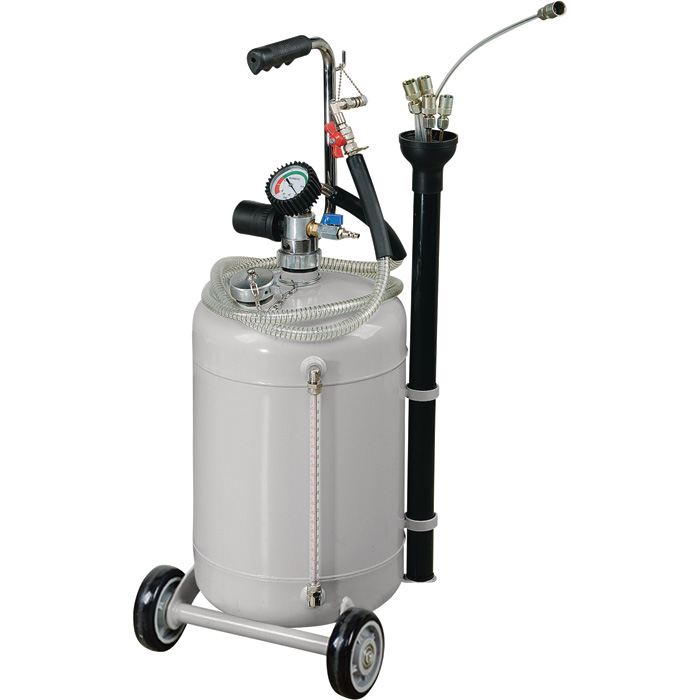

I use an extractor like this I bought from Northern Tools. It works very well. One handy thing is to extract as much oil with it as you can and very little mess when you pull the plug if you still desire the plug out. I used it on a Friends Explorer this weekend just to make the job cleaner before pulling the plug.

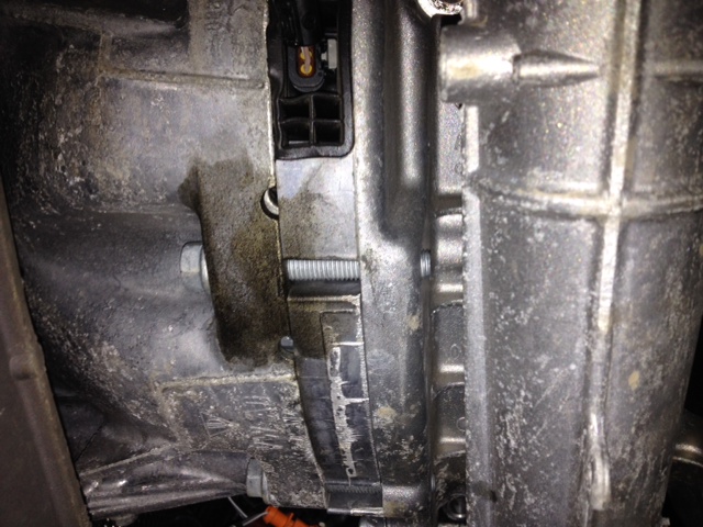

Did my 3rd OCI tonight. Glad I documented the first
Oil went everywhere. Then the cheap POS pan I got decided that the drain cap wasn't meant to actually hold oil in. I lost a grommet from the engine cover too
Also found signs of a light leak where the transmission meets the engine. This is mentioned by someone else on renntech last month, so you might want to make sure yours gets looked at too. I'll call my dealer tomorrow to get them to take a look.
