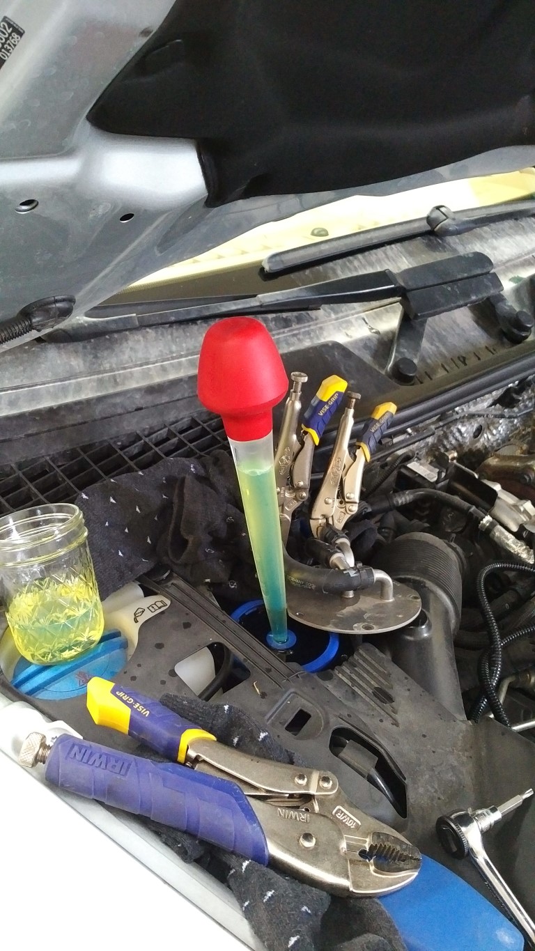

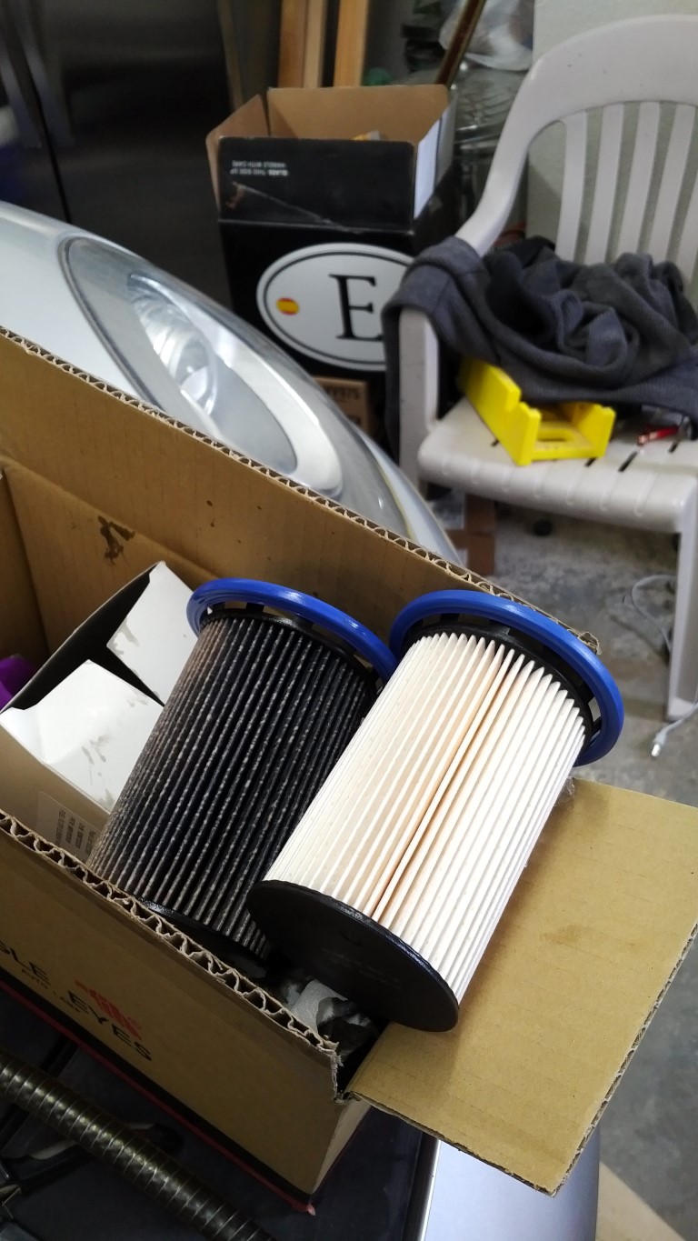

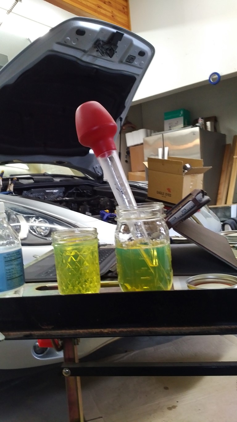

gnat thanks for the great write-up. I used a cheap turkey baster from the supermarket to extract the fuel from the filter housing. Worked fine.
If you did it like the first pic (through the filter), then you didn't do it right
You have to remove the filter, insert your device to the bottom of the case, let it settle for awhile, then extract fuel/water.
The issue is that when it is in a non-agitated state the water settles to the bottom.
Your idea for the extraction device is perfect though. Even cheap enough you don't have to worry about cleaning it up and storing it. Just toss it and get a new one next time
