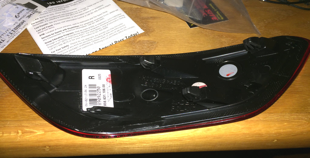

Had a similar accident, only I bumped into a tree backing up in my yard. You can get the reflectors at any dealer. Below is a link to Sonnen Porsche with the reflectors as item 23:
http://sonnenporscheoemparts.com/par...iagram=6941850
Make sure to pick the correct side since they are not interchangeable. Mine came to $22.00 including shipping. This is for a 2013 base
The reflector is held in place with three spring clips and a couple of fixed guides. From the orientation, it looks like you have to pull straight back to remove. I briefly tried to remove with a trim tool, but could not get it to release. I plan on trying more this holiday season. Maybe slipping some fishing line behind the reflector and tying a loop will help get a better grip.
Hope this helps.

thanks a lot for the help!! do you know by any chance what side is the driver? is it left ?

Yes, it is left

Got mine replaced. Put the end of a plastic trim tool between the bumper and the reflector near the rear where the spring clips are and it will pop right out. New one snaps in place.
