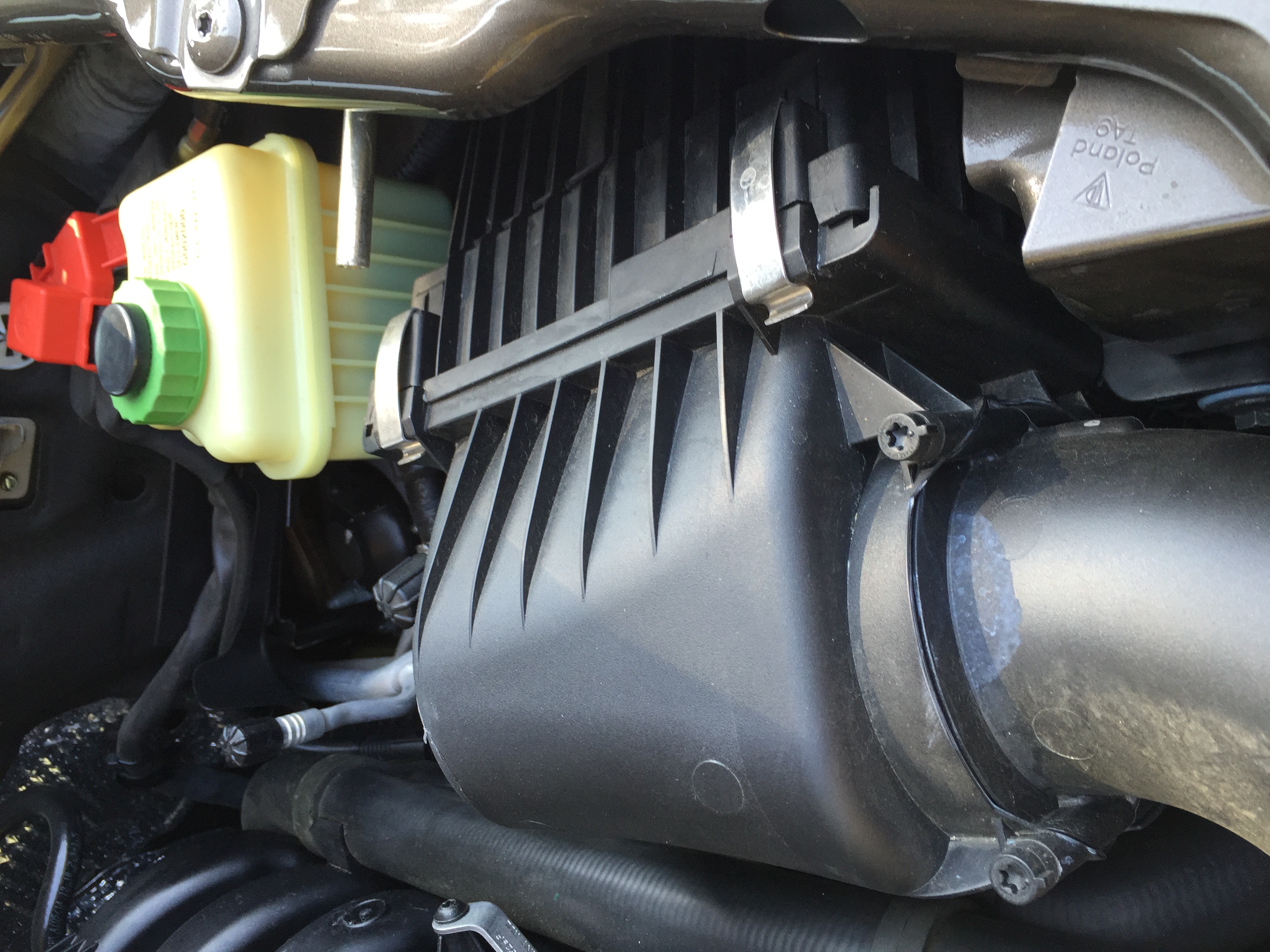

2014 Porsche Cayenne base - Air Fiter
Originally Posted by BlazinPond
Very easy and cheap DIY for the air filters on a 958 Cayenne Turbo.
These filters are pretty universal between various Cayenne models and VW Touareg, regardless of engine size (V8, turbo or diesel).
IIRC, i spent around 30 bucks for two filters.
Start to finish time took no more than 30-minutes.
Remove the small additional cover (top portion for coolant access) on passenger's side.
Passenger's side: Remove the plastic 'push pins' in order to remove the side cover. This provides access to the air filter box.
Driver's side: Remove the plastic 'push pins' in order to remove the side cover. There is approximately 4 per side. This provides access to the filter box.
Removal of the plastic housing on either side requires removal of the 'push pins'. Use a small flathead or knife to pop the middle section up...then lift the entire 'pin'
Passenger's side air filter box after side panel removal.
Driver's side air filter box after panel removal
The above plastic screws/bolts only need to be pulled straight up. While there is a slot/key at the bottom, i didn't have to use any tools to turn and align. This allows you to disconnect the tubing from air filter box. Once disconnected, you will be able to lift the air filter box to allow access to the filter.
A close up of the hole slot and end of plastic 'bolt'
Gently pull the plastic tubing out from the air box then lift the air filter box straight up to access the filter.
Air filter element is pretty obvious once air filter box is lifted up and out.
One year old filter left....new replacement on right.
Filter specs and cross reference for various brands
Thank you BlazinPond for posting this excellent air filter replacement DIY. I did it today on my 2014 Cayenne base. it is easy to remove filter as soon as I can remove the 2 long plastic screw to hold the intake tube. Put it back takes some times to align the box.
I like to add few pictures for this air filter replacement DIY. I will do Oil change next week. that is my do list.

Great write up & Photos. I can only add:
-for the four air filter pins, point the tabs towards the back, pull straight up w pliars
-when replacing element, I found easier to place the element into the cover and then
mount cover/element as one unit
Highly recommend doing this yourself, as on mine, I found the old element to have a crushed rubber seal which had no double let unfiltered air bypass the element. Also, with the airbox removed, I was able to more thoroughly inspect my vehicle and found one of my turbos is leaking oil.
There's not a lot of wrenching to be done on modern vehicles but this is in everyone's wheelhouse. The satisfaction exceeds the $$ saved. Thanks for the write up!!!

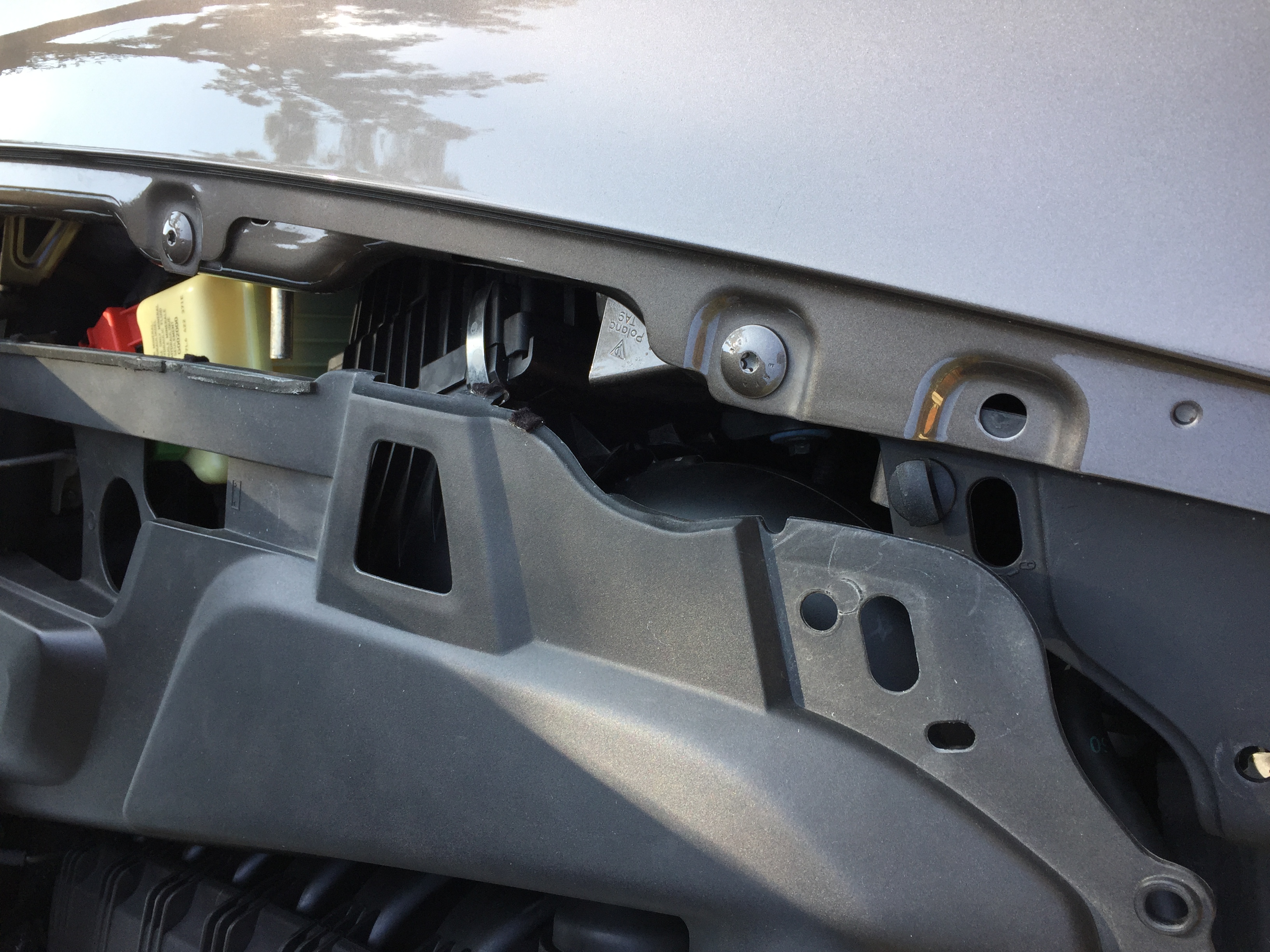

Removing the front engine bay cover panels
Not to revive such a long thread but can someone advise on how to remove the foremost front panel? On my V6 I was able to remove the 7-8 rivets holding down the engine bay covers that prevent access to the engine air filter but that foremost front panel seems like such a pain in the rear to pull out and I didn't want to use excessive force. Any secrets to this?
Been driving and loving the 958 for the last ten thousand miles-finally got around to changing the cabin air filter and thought the engine air filter would be a nice and easy next rite of induction to the club.
Thanks in advance to anyone who can chime in.

I don't believe the front most beauty cover has to be removed (you're speaking of the one around the latch assembly?).. at least I didn't remove it when I did the filters on my 958 turbo.
