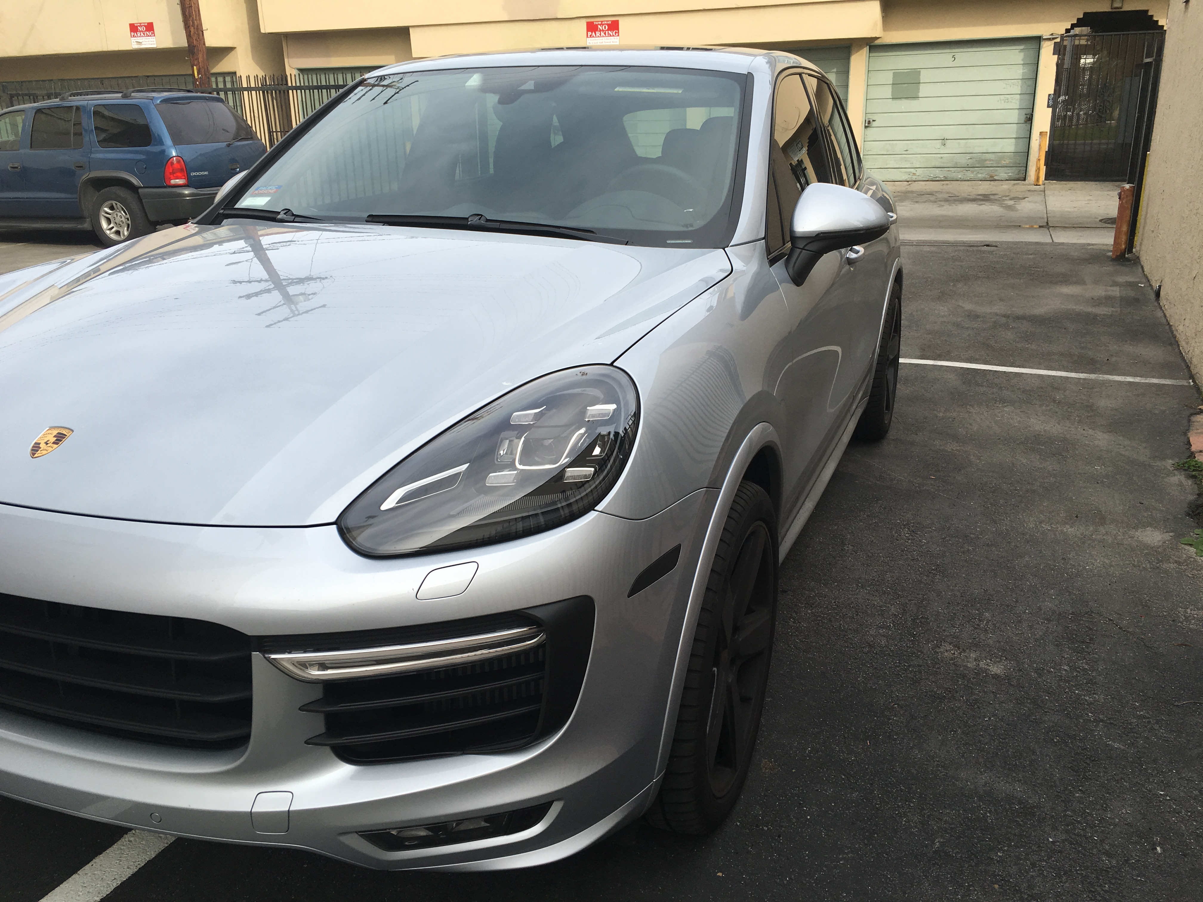

15 front 18 rear
ECS offers kits with matching bolts
Nice black finish for the spacers
I have the 21 inch wheels first responder in this thread posted 20 inch wheels with 23 in rear.
Mine stick out about 2 mm because the fat 21 inch tire but it now looks staggered

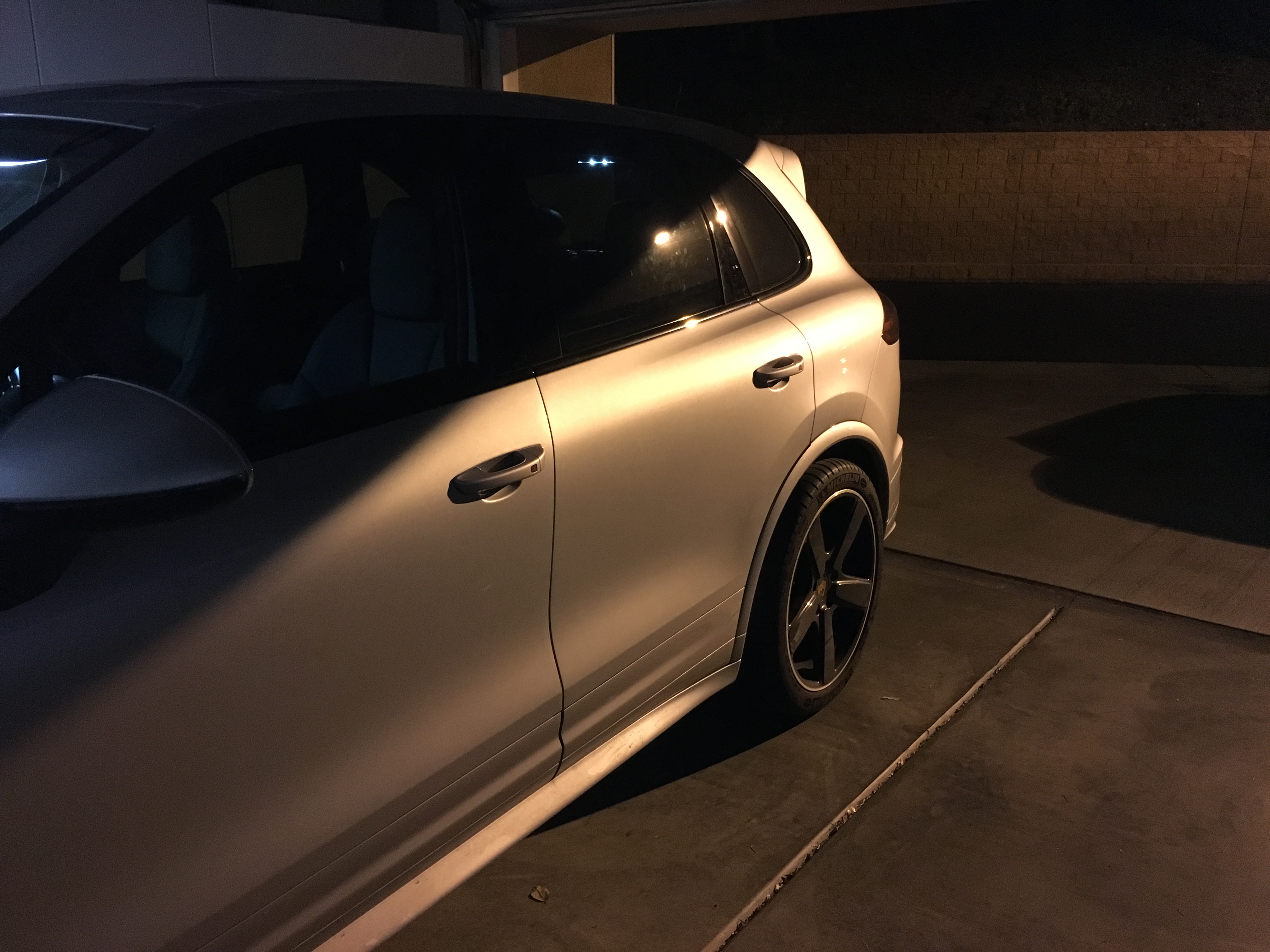

Other side

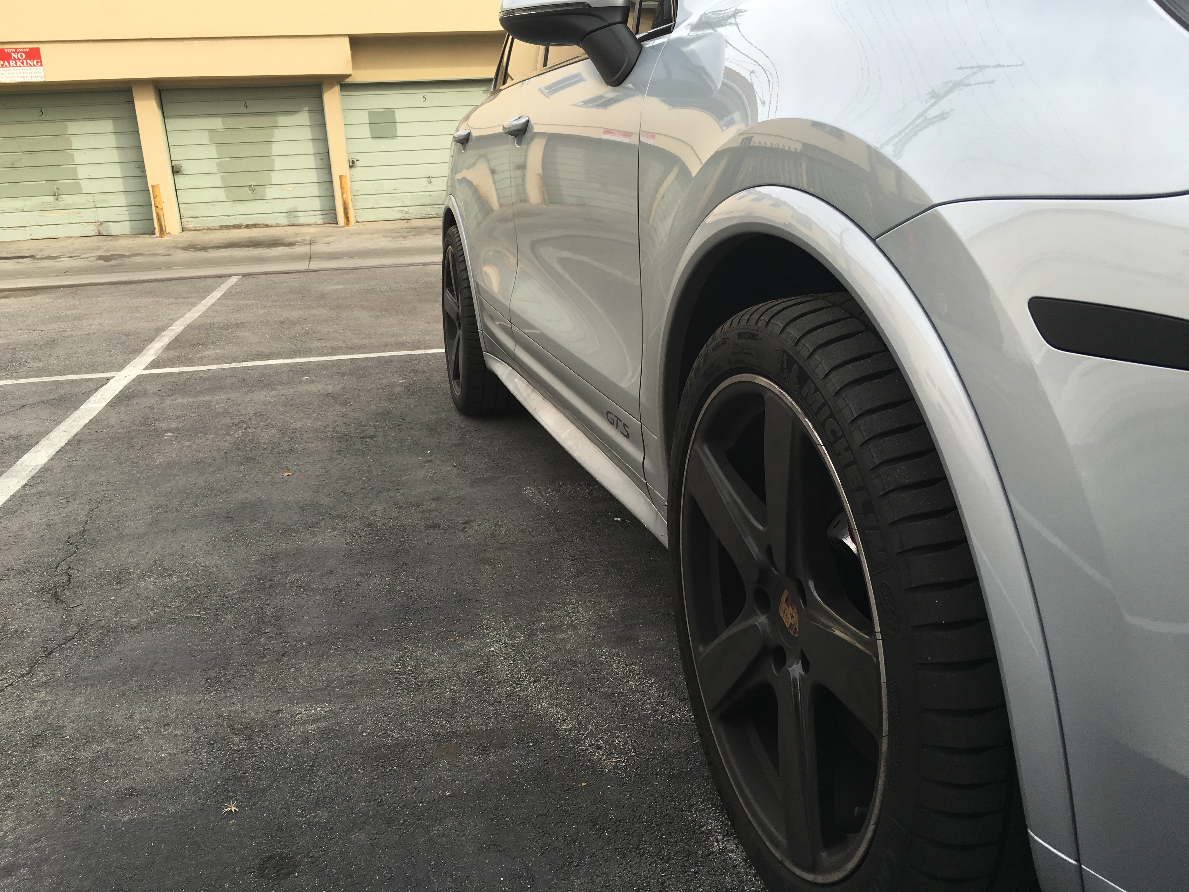

One more
