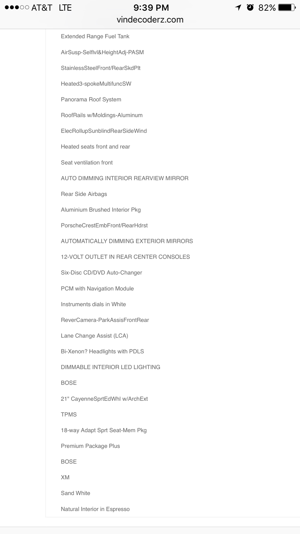

Hey guys....I am looking to pick up a 2011 Cayenne S with 47k miles. Any known issues to look for? I have attached all the options the car has. I felt a slight shudder at highway speeds...they are going to road force balance the wheels and I am going to re test drive. Please feel free to vent out your gremlins stories here.
