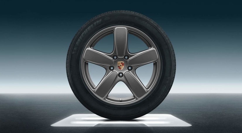

Cayenne GTS, 958.2, 20" Winter wheels & tires...

Originally Posted by [SS]Shooter
I have semi-gloss black 20" rims on my 2016 GTS with Pirelli winter/snow tires.
Which rims are those?
I ask because I've not seen those come up on the porsche website. The closest I've seen are the 20" Sport Design in silver for the Macan.
