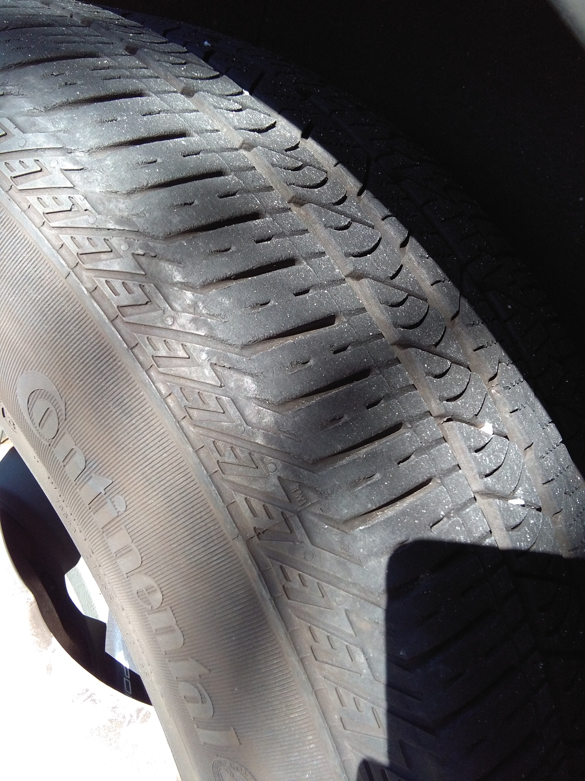

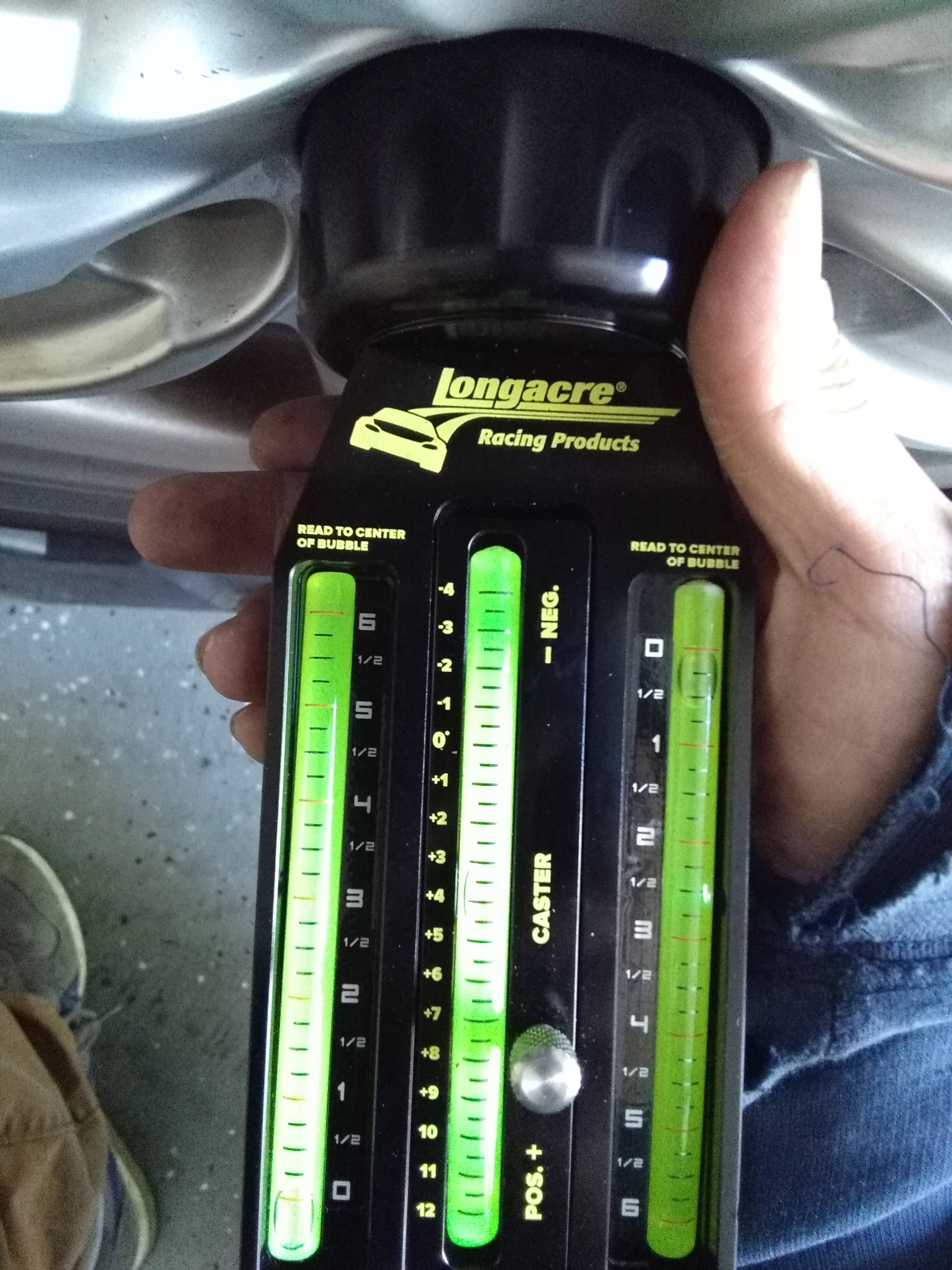

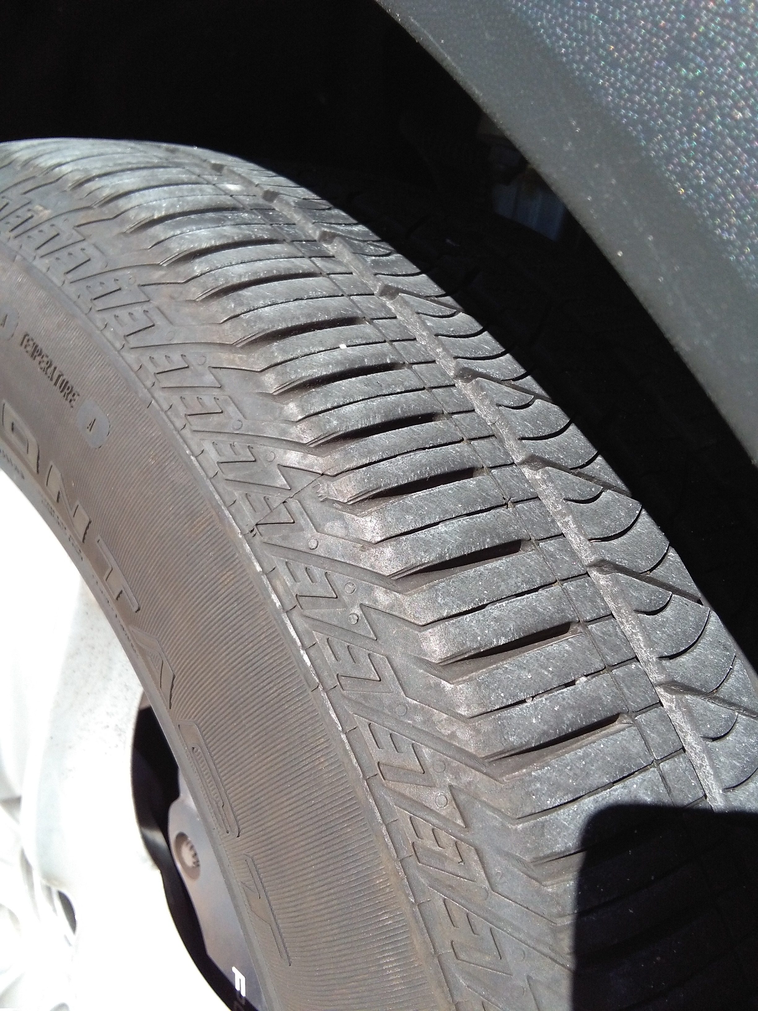

I just did the brake flush and tire rotation today and noticed that on the front tires, both the outside are wearing out faster than the inside edge. I checked with my Longacre camber gauge and it read +.25 camber on both fronts. The rear are wearing evenly at -1 camber.

Here is the front wheel rotated to the rear:
Rear wheel rotated to the back:

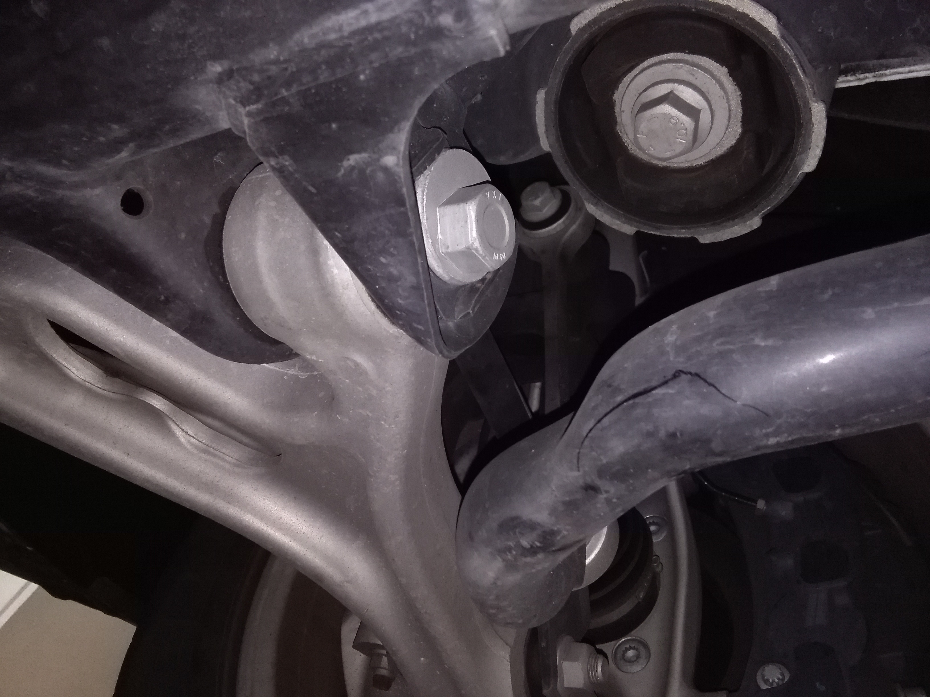

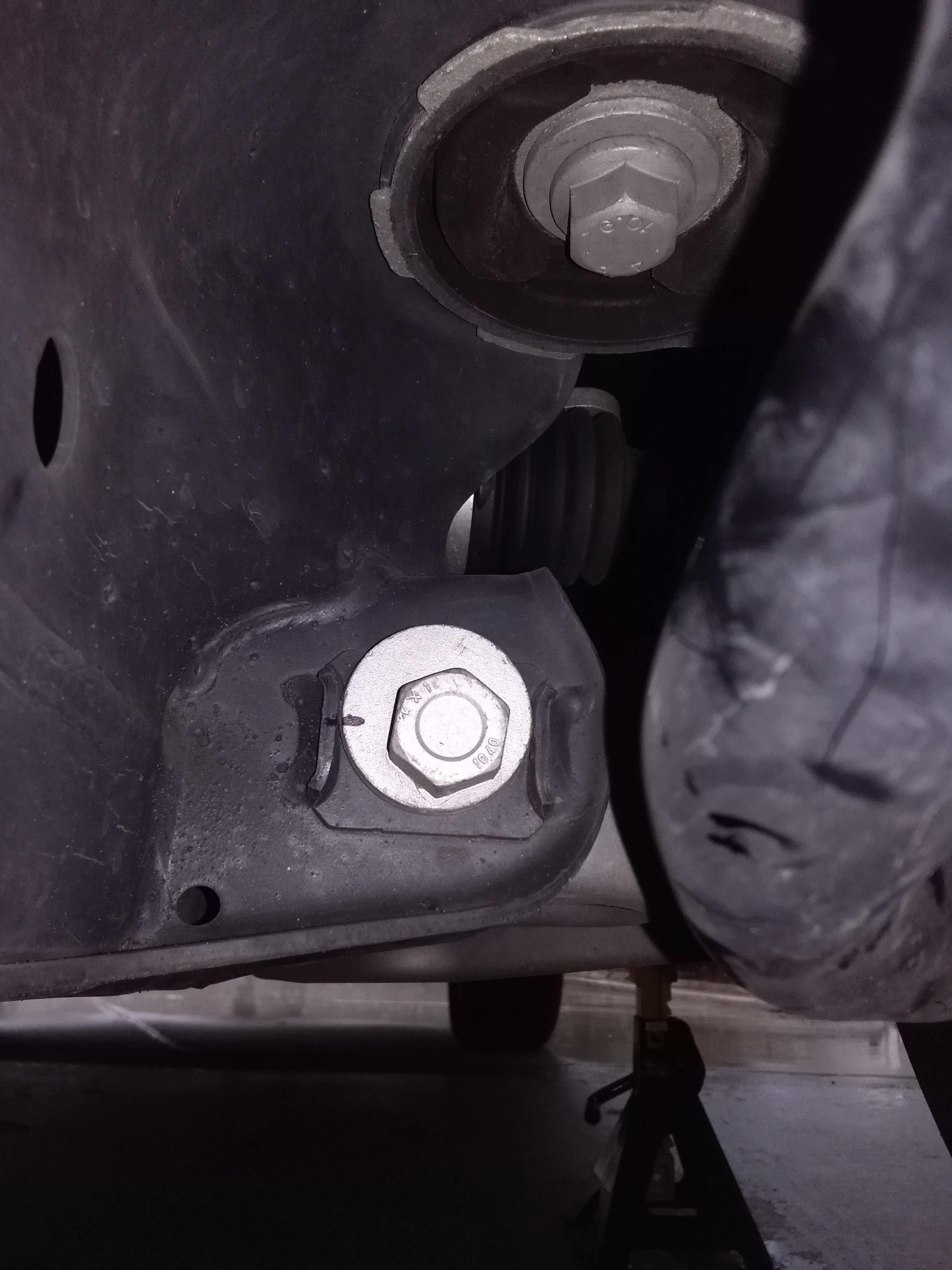

This is the camber adjustment bolt. It is towards the front of the Lower A-Arm:

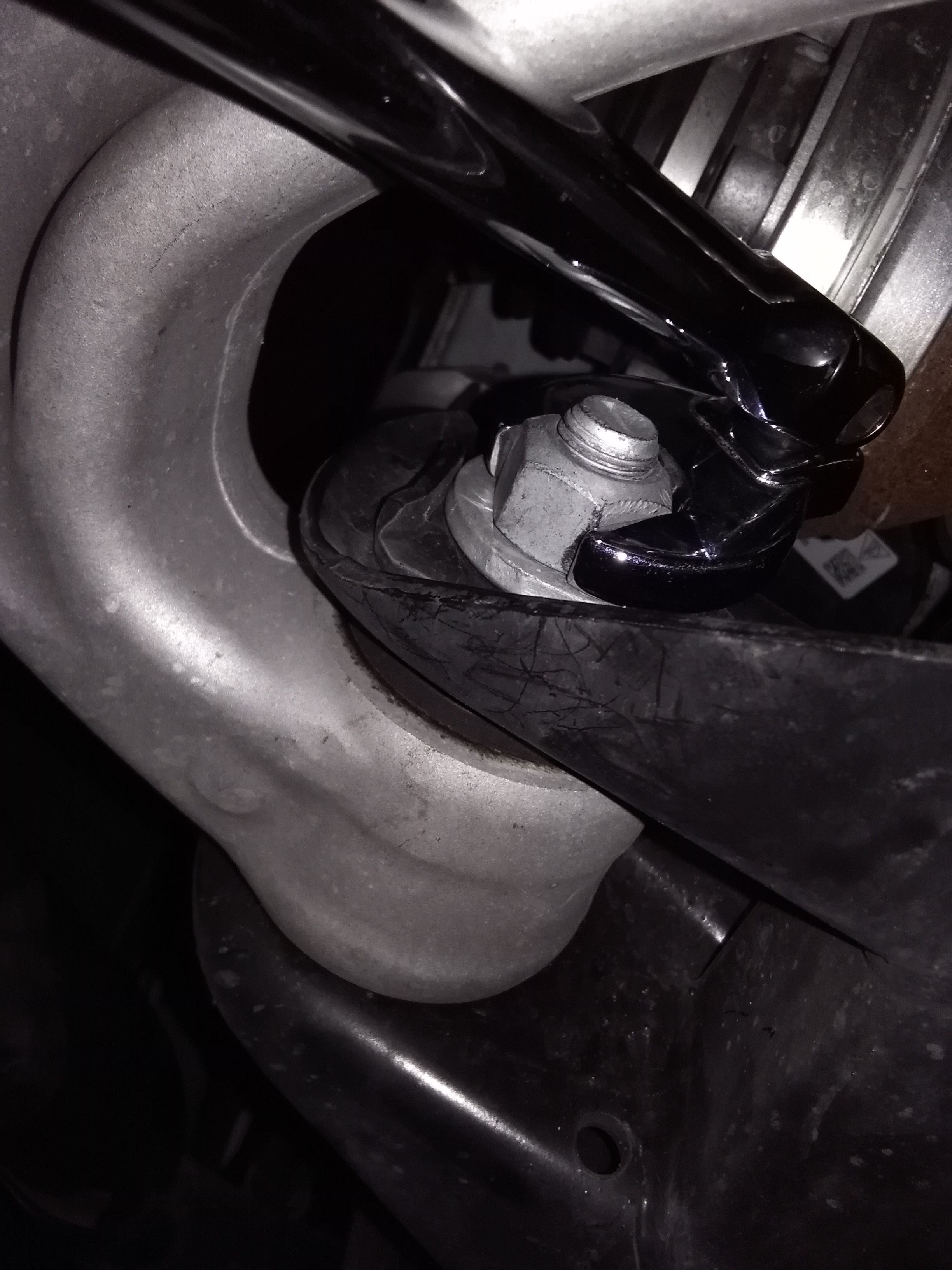

Used a sharpie to mark the original spot:
Working on the ground gives you limited space. Here I used a 21mm crowfoot wrench on a 12" breaker bar. Push your leg against the tire to give you more leverage. The nut torque spec is 126 ft/lbs:
Started off at +.25 camber, set to about -.30 camber. I adjusted the toe after this as well but did not take pictures:

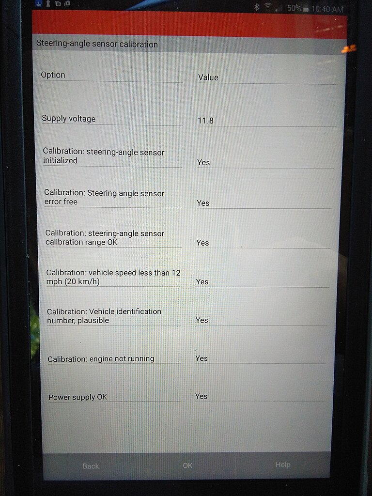

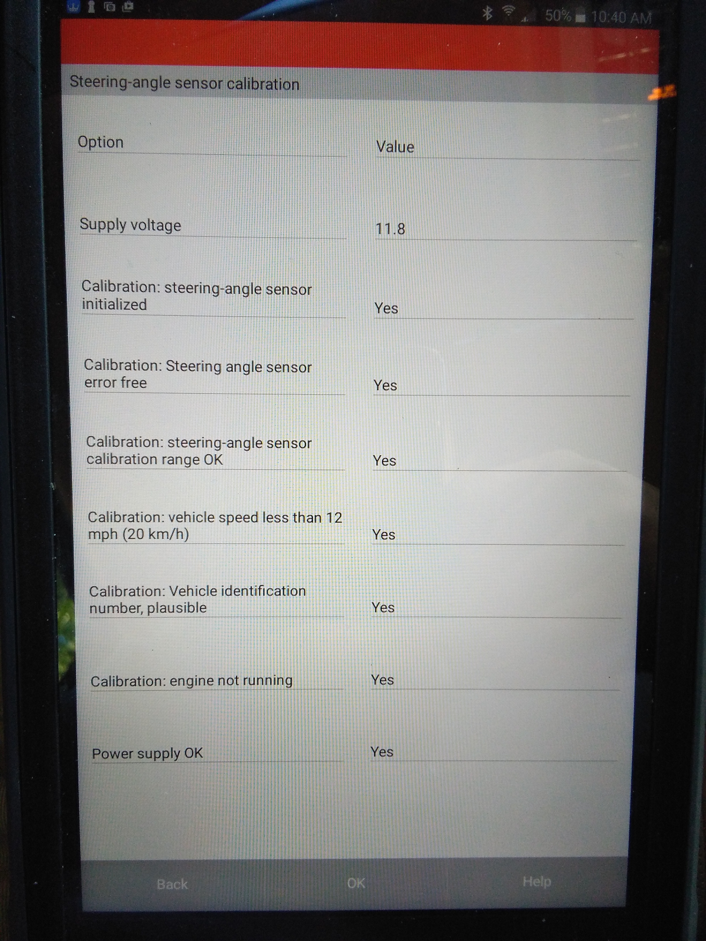

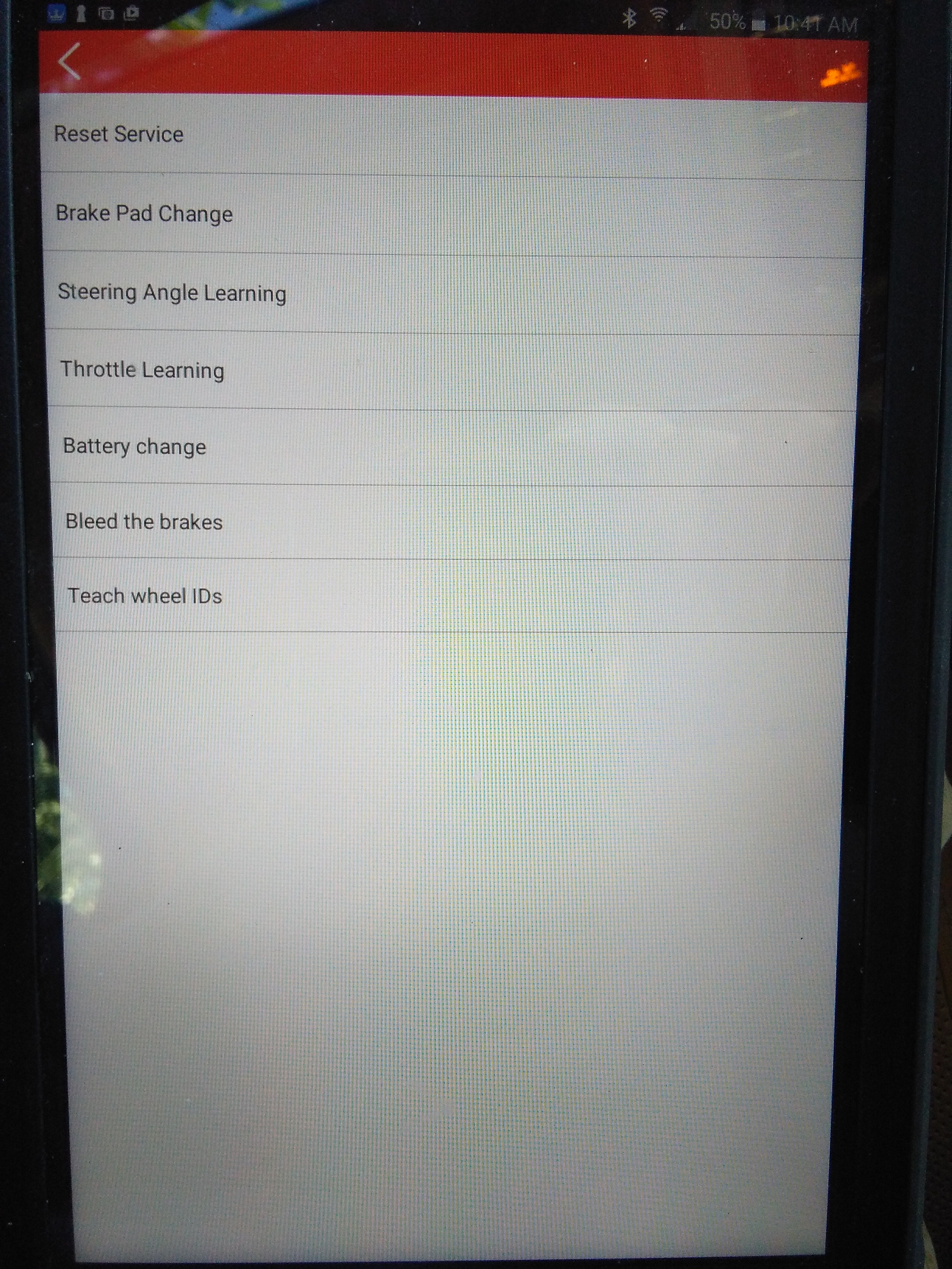

Fired up the iCarScan tool to calibrate the steering angle sensor:

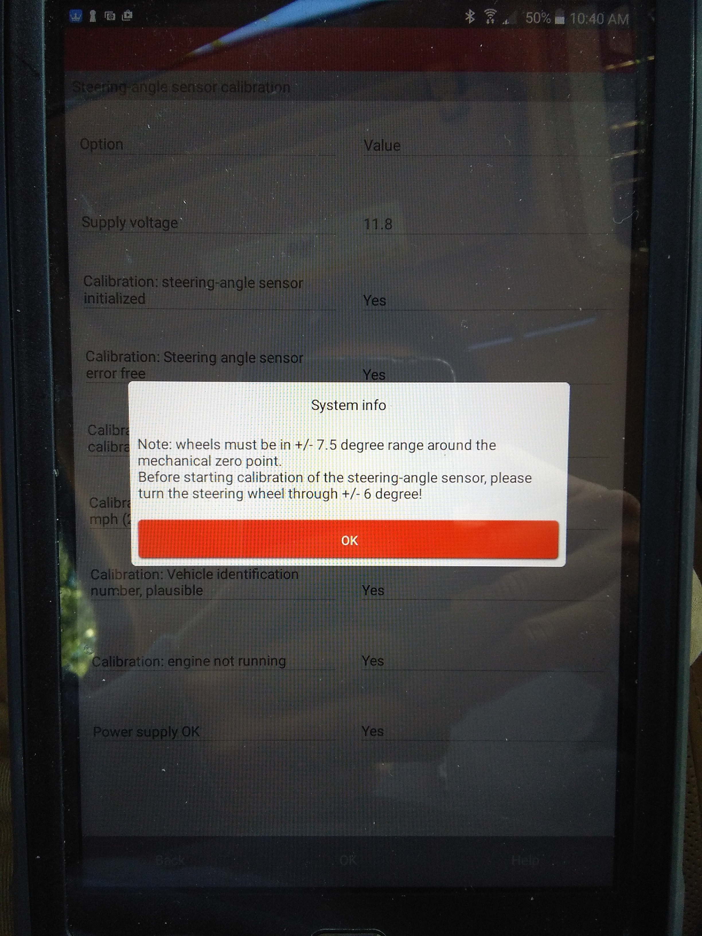

These parameters have be met before doing the calibration:

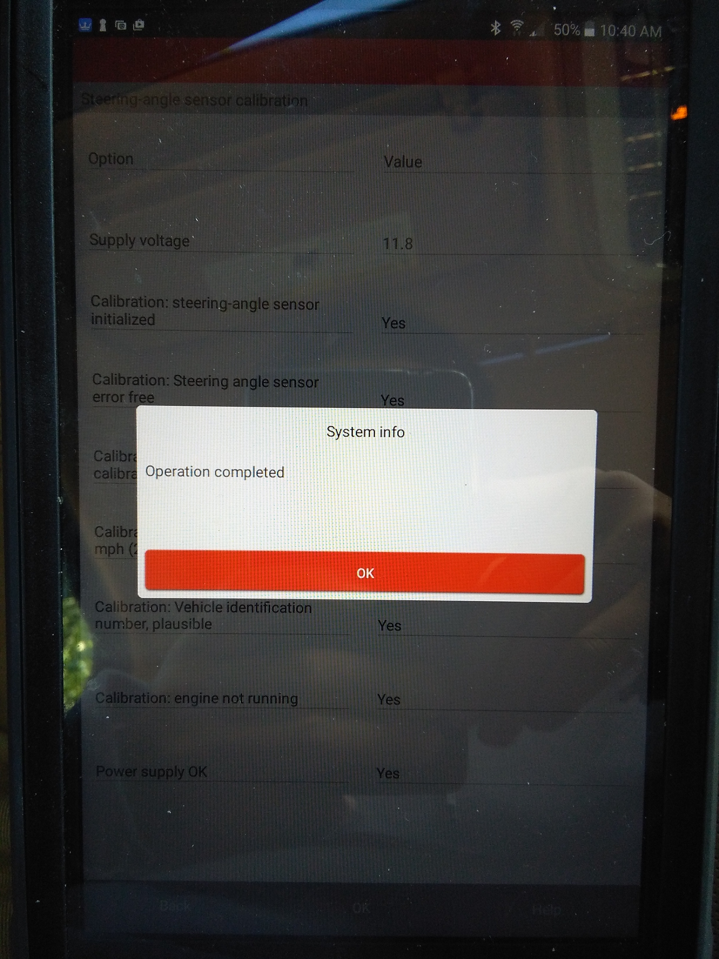

It says operation completed:
But my dash displays a PSM failure:

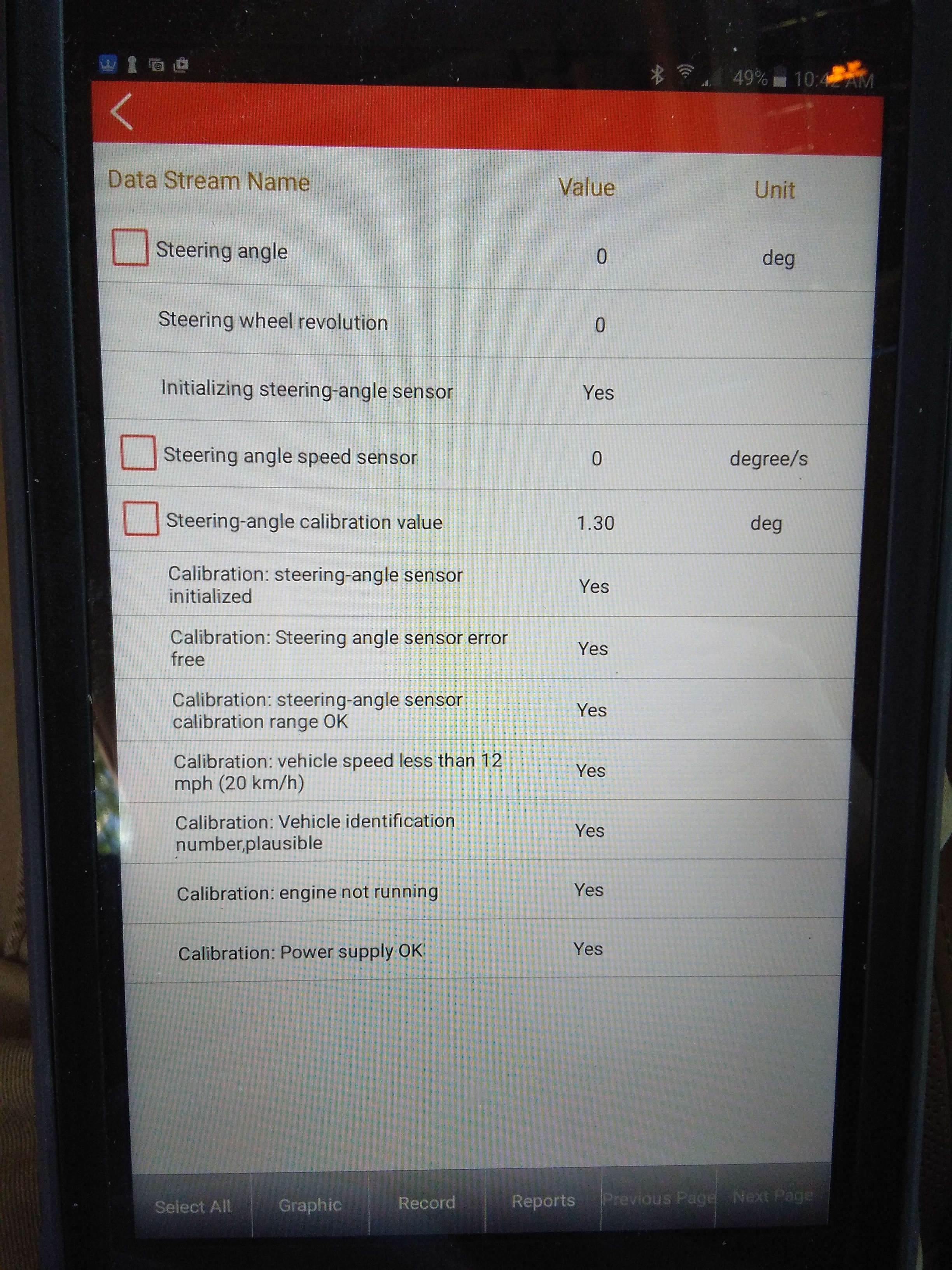

Went to read the data streams and everything seems okay:
Test drove it and everything seems okay. I will report back if there are any abnormal wears on the front.
