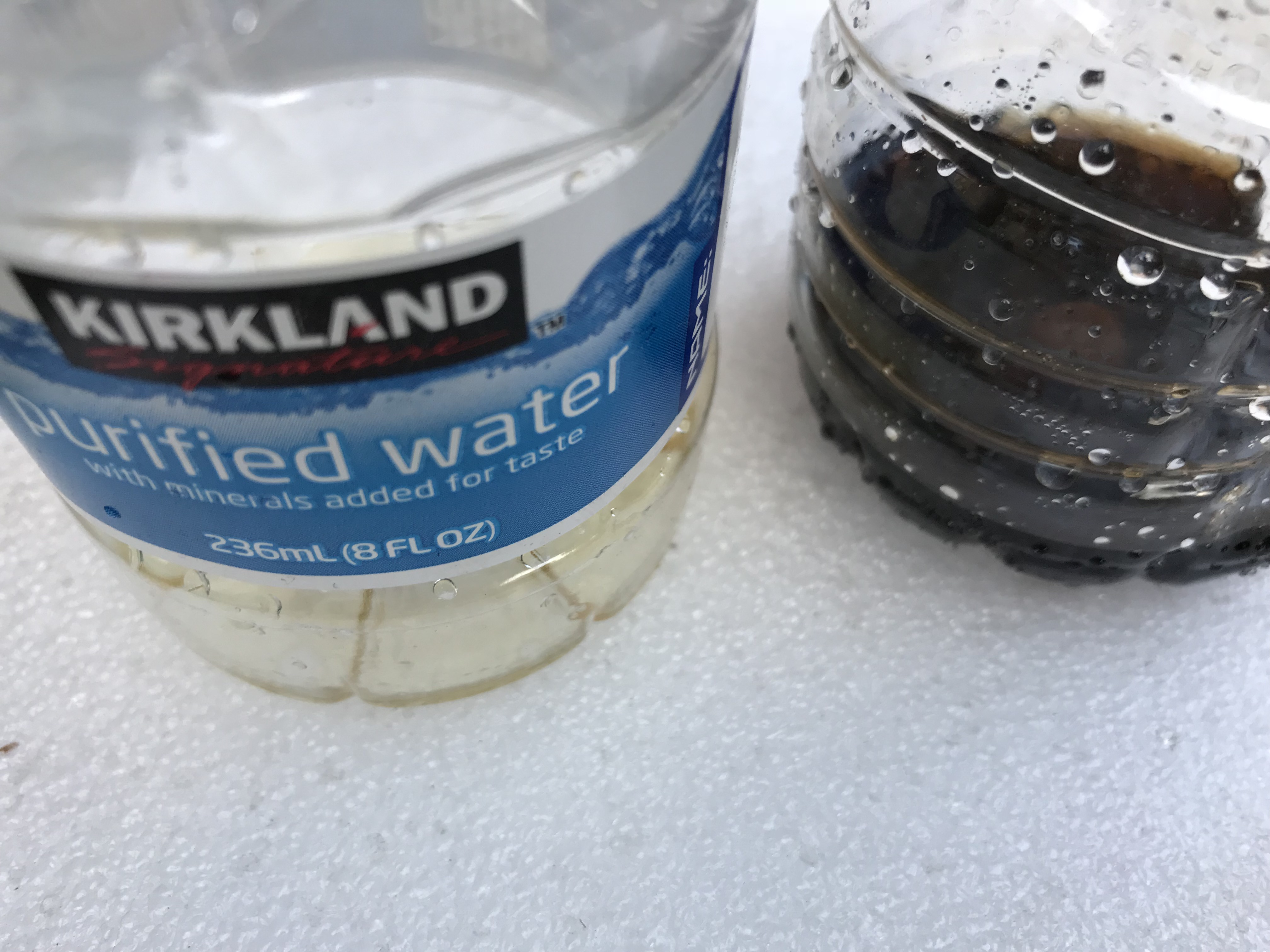

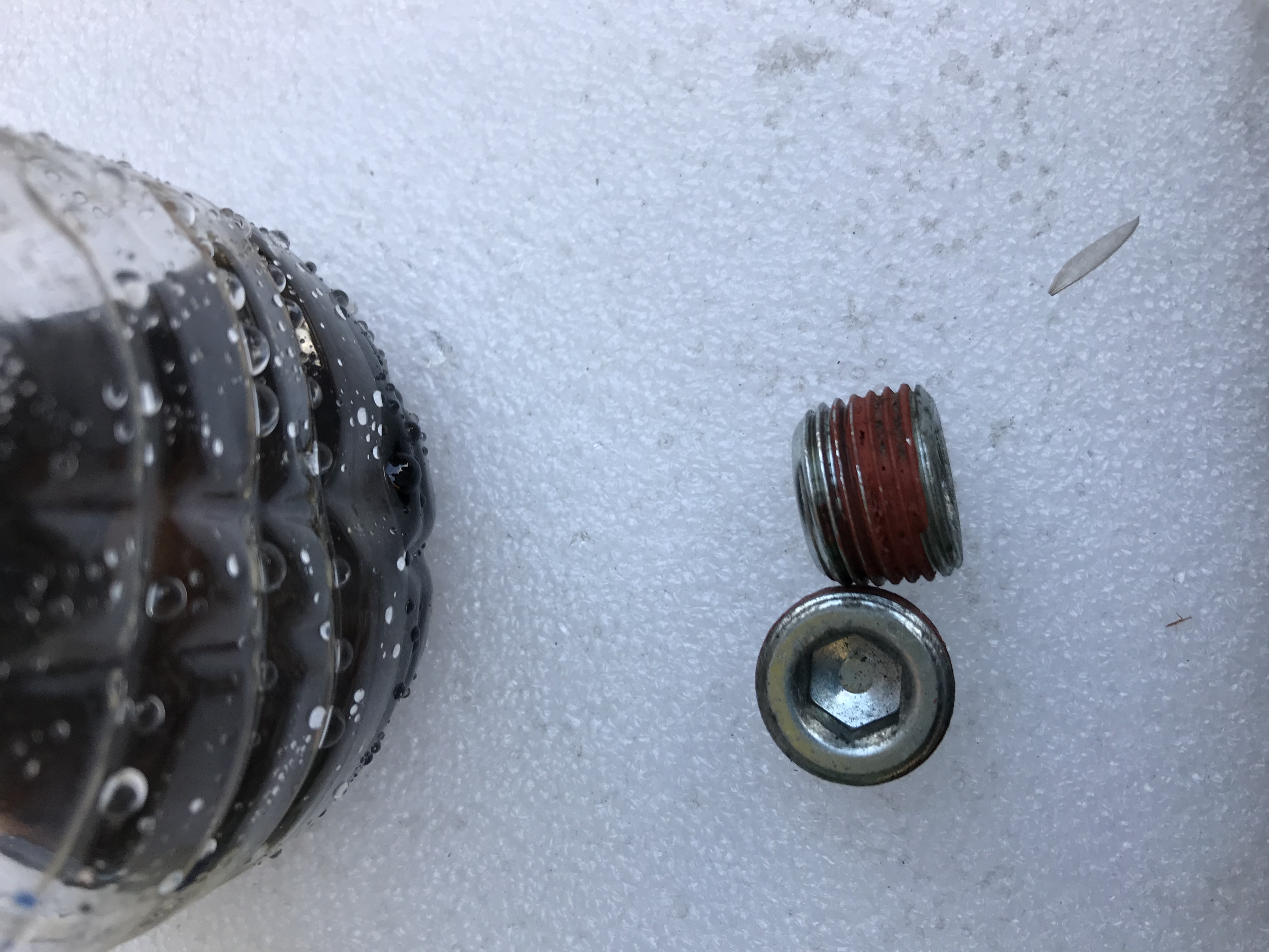

I did a TC fluid change on my 2014 Cayenne. I was so surprised that the fluid is so black @ 35K miles. The car is running Great, no worries, still under warranty. I used Porsche TC fluid from https://www.sunsetporscheparts.com/o...1l-00004330563.
I also do oil change as well. Transfer case plugs are right there.
Please remember to use the new plugs. Thank you some members in forum to mention about new porsche plugs with seal. I will bring my car to Porsche FJ dealer in Bay area CA next April to check out before my warranty expire.
Here are few attached pictures.
Have fun.
