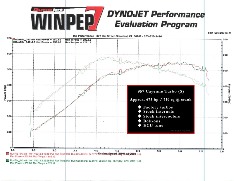

Just got my 957 CTT(S) dyno'd after most of my engine performance mods are complete to see where I netted out. Most people are aware that with an ECU tune, diverter valves, intake and secondary bypass pipes, this engine is good for about 600 hp / 600 tq @ crank - an easy 100 hp gain over stock.
What if you keep the stock internals, stock intercoolers, stock turbos, and just push the envelope a little bit further with the bolt-ons?
Well, this is the path I followed and was hoping to land somewhere around about 650 - 680 hp/tq at crank.
After all was said and done, she dyno'd out at 550 hp / 582 tq on one pass (no smoothing, uncorrected) and 553 hp / 578 tq on another pass at the wheels. Taking into account about 22% for drivetrain loss and I am at:
Approx. 675 hp / 710 tq at the crank!
And just look at that powerband - no wonder she likes to twist the suspension under all that torque! Keep in mind that this is knocking on the door of the EVOMS GT700 power kit that replaced the turbos and intercoolers (there is another tuner as well offering a 700 hp kit that replaces the turbos and intercoolers) - at a fraction of the price. My work was all done in my garage myself!

that's awesome.. who did the ecu tune same company?

Aren't Mustang dyno's and dynojets different as far as results are concerned?

Thanks! I went with a Softronics tune since they have a great rep with the 997 crowd.

I was definitely stoked. Interestingly enough, this same tuning shop ICS Performance had an X5M on their dyno as well. There was some doubt in the beginning, however, in the end they were both sure that my CTTS would "walk" the X5M they had on their dyno.
Generally speaking, Yes. I believe Mustang dyno are generally referred to as "heart-breakers". Remember that dynos are primarily a relative tuning tool. Even though it is less accurate when calculating exact hp/tq at the flywheel, it is accurate enough to give firm ballpark numbers. When paired with given draintrain inefficiencies losses, it can be a good tool for estimated power at the crank (hence the approx. statements).

I always knew these things were good for some serious numbers, thanks for confirming, I imagine I am not far behind you in power. Have you had a new tune written since putting the catless downpipes in? The next thing we need is an intercooler upgrade and we're there.
No, I did not have my ECU tune remapped after the turbo downpipes. I called up Softronics and they were confident that my current tune would be able to compensate for the additional exhaust flow. Also, I knew that I should get about a 1-2 psi bump up in boost from the reduced restriction. I was told that the additional boost shouldn't be a problem either for this tune. After reviewing the dyno powerband and getting AFR readings from my Durametric, I think they are right- it is doing a great job of keeping the performance metrics where they should be.
I might end up replacing the intercoolers, adding a water-meth injection kit, and asking that my boost get bumped up 2 psi on my tune. Right now it is peaking at about 16.8 psi - according to my Durametric logs. That would put me at 18 psi peak - not too shabby and may be easy power.

For one the stock turbos are Mitsubishi TD04, not K16. Secondly, Leistung does not provide tuning as the title implies. Just great parts and service!

What are your thoughts on how well the other parts(driveshafts, differential etc) will hold up with the added power?
